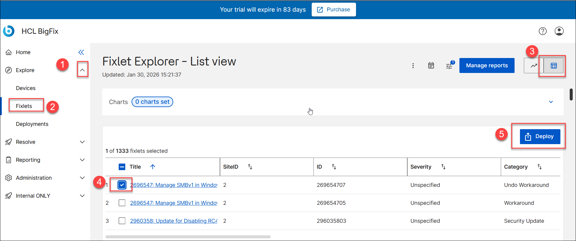

To access the deploy menu, expand Explore and click Fixlet.
From the Fixlet list view, select at least one Fixlet. The Deploy button is enabled. Click Deploy that slides out from the right. The wizard will guide you through the steps to create a new deployment.
By default, the Deploy button is inactive. It becomes active once Fixlets are selected in the data table. Multiple Fixlets can be selected and combined into a single deployment.

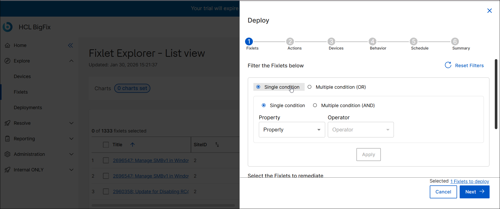

The Deploy Wizard allows to customize user deployments; however, these customizations are optional.
  1. Fixlets: The selected Fixlets are considered for remediation. You can modify the Fixlet selection in this step.

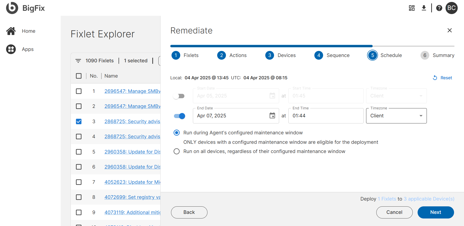

  5. Schedule: Not required. Determining a deployment’s start and end time gives BigFix users a tool to control their deployments. Typically, deployments do not happen immediately. Some devices may be powered down, or disconnected from the Internet, or otherwise unable to have the Fixlet applied. Scheduling allows to control how long BigFix will attempt this particular deployment.
    There may be other reasons to control the end time. For example, an organization may wish to ensure that all deployments run overnight to minimize business impact.
    The schedule tab has two options: Start Time and End Time. In the first, select the calendar date and the start time when BigFix will begin attempting to apply the deployment. You may also select if you want to use client time (e.g., the time zone where the device is located) or UTC.
    In the second, select the calendar date and the start time when BigFix will stop attempting to apply the deployment. You may also select if you want to use client time (e.g., the time zone where the device is located) or UTC.
    If no scheduling option is selected, BigFix will begin the deployment immediately.
    Run during agent’s configured maintenance window: Select this option, if you want to deploy the Fixlet during the set maintenance window.
    After selecting the desired schedule, click Next to proceed to the summary tab.
