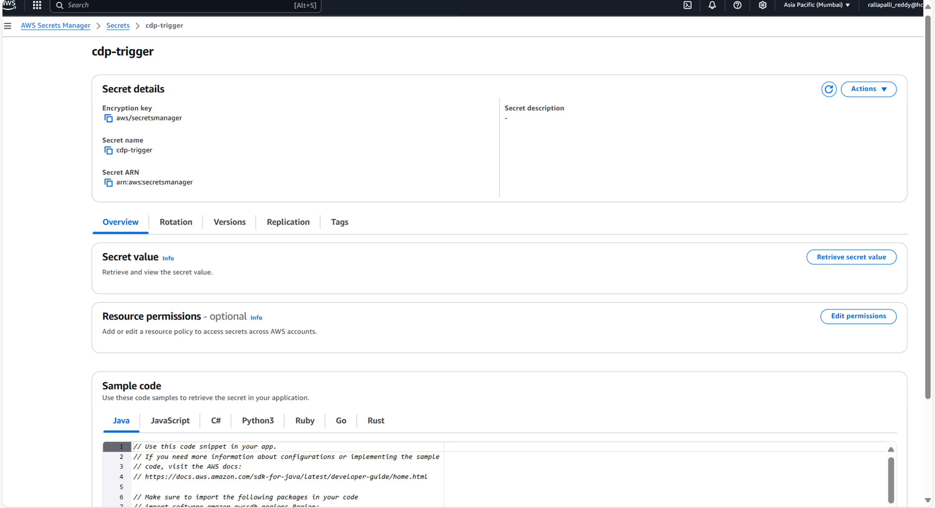

Make sure to create cdp-trigger secret in the AWS Secret Manager before deploying CDP Trigger.
To create CDP Trigger secret in the AWS secret manager, follow the steps below:
  1. Create a cdp-trigger secret sample key and value, and update the actual values as shown below.
    "AerospikeCluster":"",
    "AerospikeTimeout":"10000",
    "MY_SQL_HOST":"",
    "MysqlDatabase":"vrm",
    "MysqlUsername":"",
    "MysqlPassword":"",
    "MysqlPort":"",
    "allowTrafficForSpecificCampaign":"false",
    "KafkaConsumerConfig":"",
    "KafkaProducerConfig":"",
    "KafkaProducerConfigaps1":""
