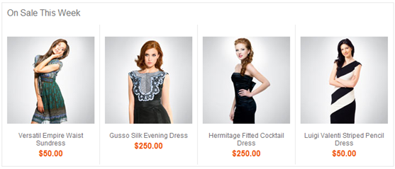

When a customer views the e-Marketing Spot in the fourth row of the category page for Apparel, display four featured catalog entries: Versatil Empire Waist Sundress, Gusso Silk Evening Dress, Hermitage Fitted Cocktail Dress, and Luigi Valenti Striped Pencil Dress:
Example of Action: Recommend Catalog Entry
When this web activity is activated, the e-Marketing Spot on the category page displays these four catalog entries:
Four catalog entries that display by using the Recommend Catalog Entry action
