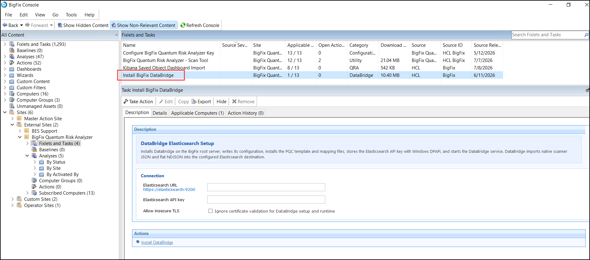

  1. In the BigFix Console, run the Task named Install BigFix DataBridge against the Windows BigFix Root Server.
    The Task installs DataBridge as the BES DataBridge service, creates its configuration file (config.yaml) in the DataBridge installation directory, installs the PQC template and mapping files, stores the Elasticsearch API key with Windows DPAPI, and starts the service. DataBridge imports native scanner JSON and flat NDJSON into the configured Elasticsearch destination.
  2. In the Task, provide the Elasticsearch URL and Elasticsearch API key. If your Elasticsearch certificate is self-signed, select Allow insecure TLS.
    The Allow insecure TLS option is described as "Ignore certificate validation for DataBridge setup and runtime". DataBridge deployment is a one-time configuration.
    Figure 1. Install BigFix DataBridge. The DataBridge Elasticsearch Setup description with the Elasticsearch URL, Elasticsearch API key, and Allow insecure TLS fields, and the Install DataBridge action.
