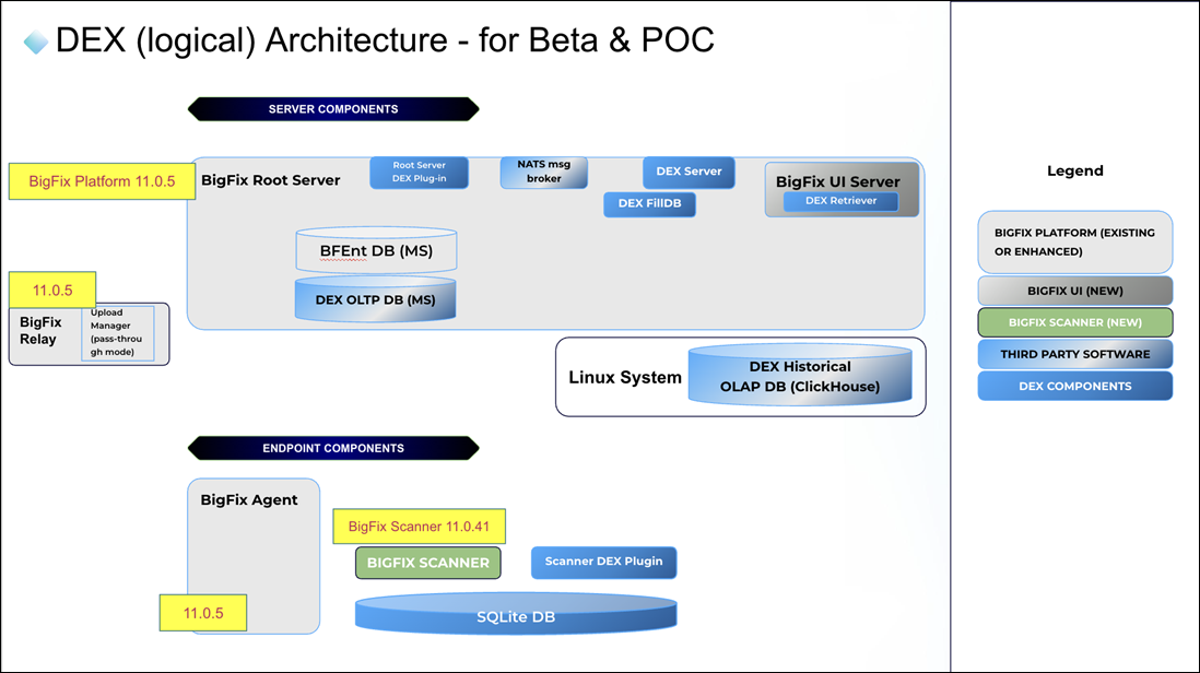

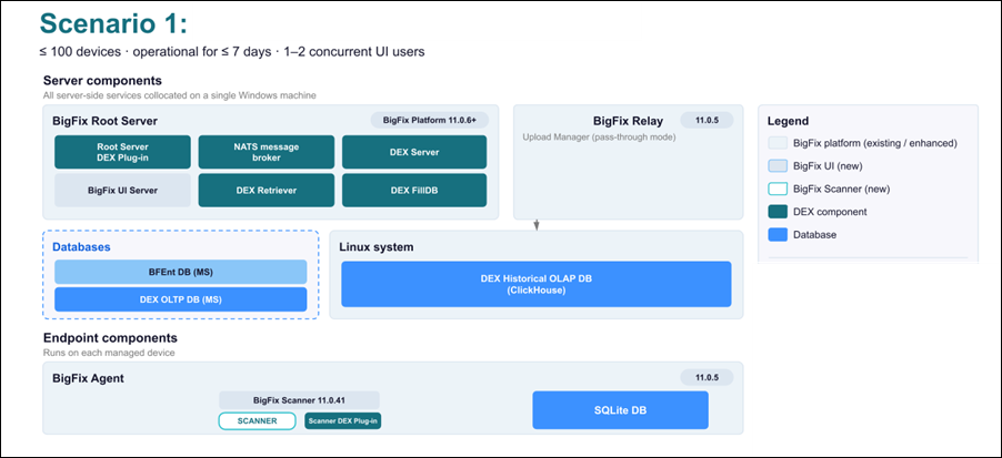

Scenario for a POC/small test environment
In a POC scenario, an environment with <= 100 devices is considered. It is supposed to be operational for 7 days at most, with 1 or 2 UI concurrent users. In a POC scenario, the RootServer DEX Plugin, NATS JetStream, 1 DEX FillDB, the DEX Server, and the DEX MSSQL database are collocated on the same Windows machine as the Root Server, the Platform database (BFEnt), and the BigFix UI.

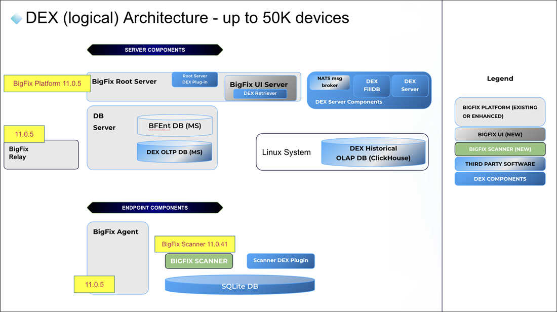

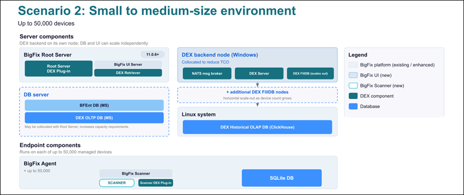

Scenario for small to medium-size environments – up to 50K devices
Even though the DEX FillDB, as well as the RootServer DEX Plugin, is meant to be horizontally scalable, the DEX backend components are suggested to be deployed in one single node to reduce the TCO.
This configuration can be then extended by providing additional nodes with the DEX FillDB, while the RootServer Plugin will be able to scale on the TLR in the next releases.
This leads to the following capacity plan in case of 50K devices, where the RootServer Plugin is installed on the Root Server machine and the DEX FillDB, NATS JetStream, and DEX Server are collocated in one single Windows node, while the BigFix UI server can be collocated with the Root Server system, increasing the capacity requirements as explained below.
