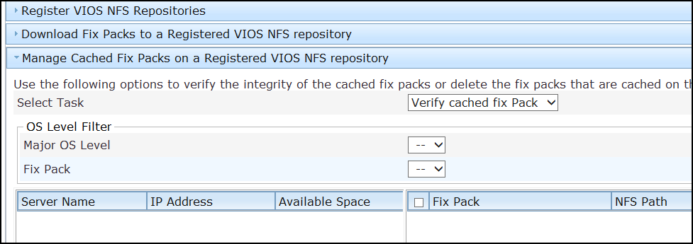

  4. Select Verify cached fix packs
    You can view information about the registered NFS repositories and the fix packs that are stored on each repository, as well the actual location of the NFS folder.
    Note: You can copy the NFS Path and paste it in the dialog during the deployment of a fix pack on NFS mount.
    Figure 1. Verifying cached fix packs on a registered VIOS NFS repository
