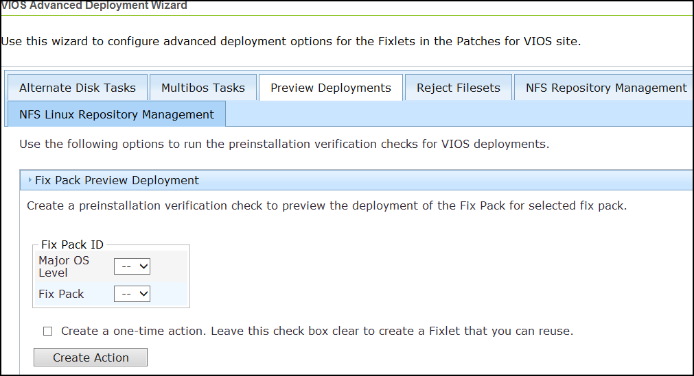

  1. From the BigFix console, click Patch Management > OS Vendors > IBM VIOS > VIOS Advanced Deployment Wizard.
  2. Click the Preview Deployments tab.
  3. Under the Fix Pack Preview Deployment pane, select the major operating system level and fix pack that you want to verify.
    Figure 1. Preview deployments
    Preview deployments
  4. Select the check box to create a one-time action rather than to create a reusable Fixlet.
  5. Click Create Action.
  6. Deploy the action.
