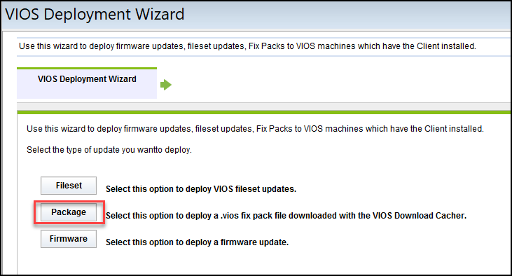

  1. From the BigFix console, click Patch Management > OS Vendors > IBM VIOS > VIOS Deployment Wizard.
  2. Click Package.
    Figure 1. Package option in the VIOS Deployment Wizard

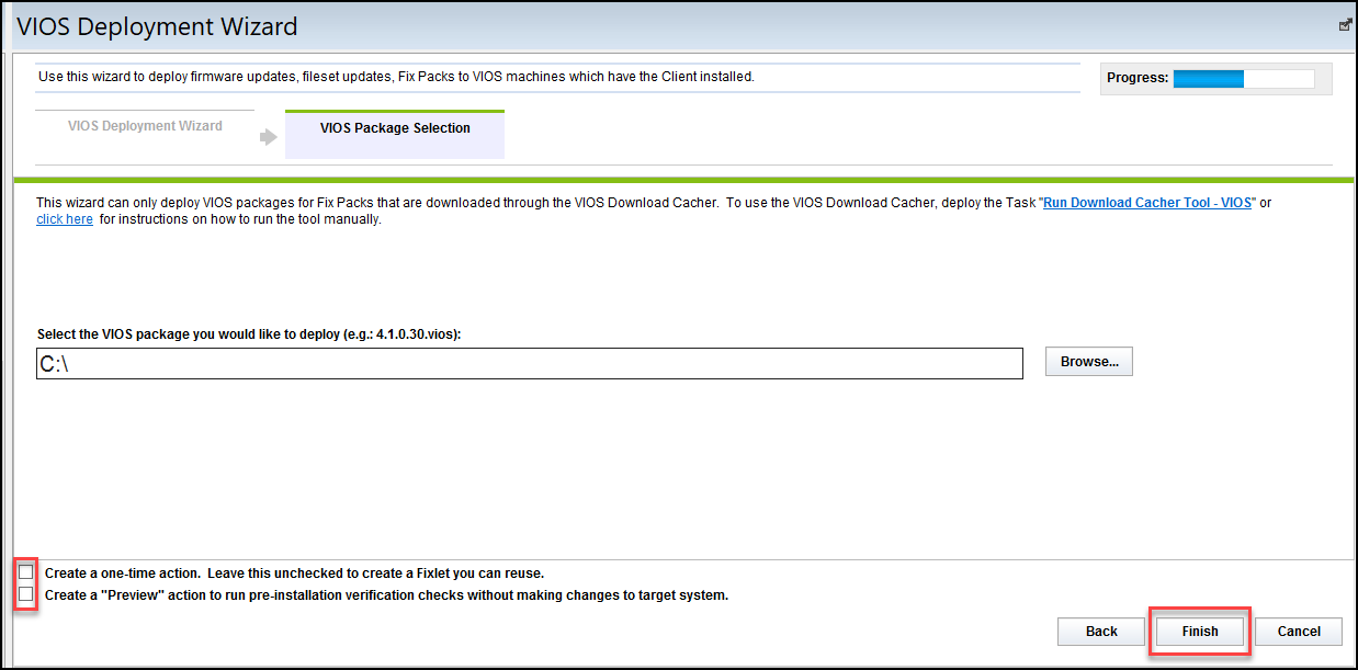

  3. Enter the location of the PowerVM VIOS package that you want to deploy.
  4. Select the check the box if you want to create a one-time action rather than a reusable Fixlet.
  5. Optional: You can also select the other check box to create a preview-only action.
    This preview runs the pre-installed verification checks. The results of those checks are available in the PowerVM VIOS Pre-Install Verification Results analysis.
  6. After you set the necessary parameters, click Finish.
    Figure 2. Finishing the configuration for VIOS package updates
After completion, the generated one-time action or Fixlet displays in the BigFix console. You can use it to deploy the PowerVM VIOS update to the relevant computers.

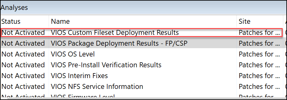

To view the detailed information about the results of deploying your PowerVM VIOS package update, activate the PowerVM VIOS Package Deployment Results - FP analysis.
Click All Patch Management > Analyses > By Site > Patches for VIOS > VIOS Package Deployment Results - FP/CSP > Activate.
Figure 3. Activating the VIOS Custom Fileset Deployment Results analysis
