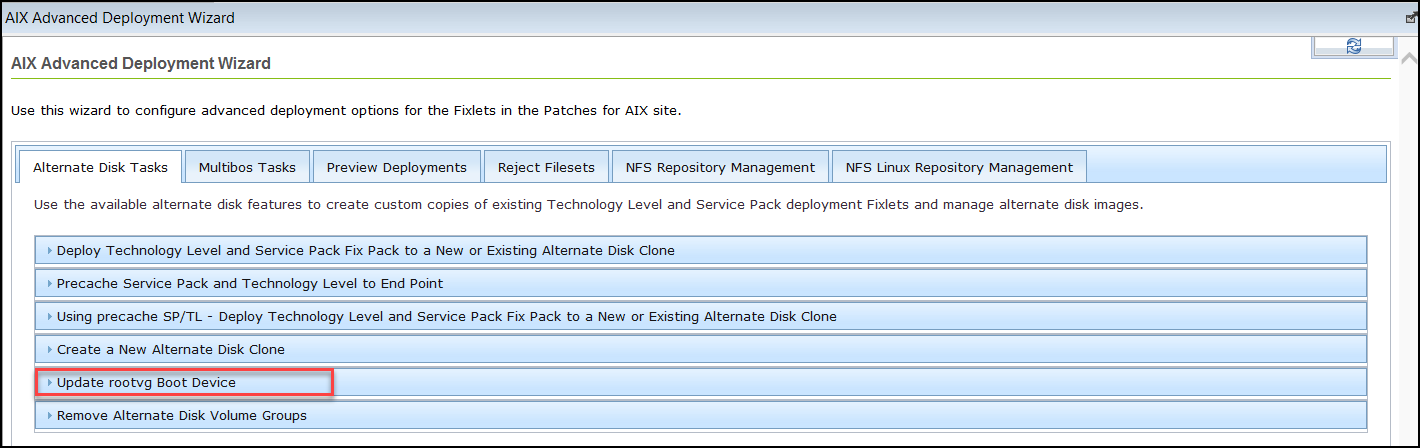

- From the BigFix console, click .
- Under the Alternate Disk Tasks tab,
click Update rootvg Boot Device to expand the
bootlist modification options pane.
Figure 1. Update rootvg boot device
