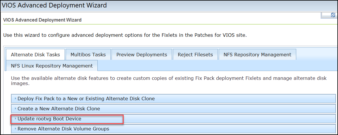

  1. From the BigFix console, click Patch Management > OS Vendors > IBM VIOS > VIOS Advanced Deployment Wizard.
  2. Under the Alternate Disk Tasks tab, click Update rootvg Boot Device to expand the bootlist modification options pane.

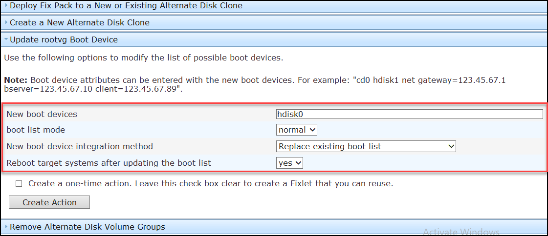

  3. Enter the name of the new boot device or the name of the new volume group that you want to use instead of the current rootvg boot device.
    Note: You can enter boot device attributes with the new boot devices. For example: cd0 hdisk1 net gateway=123.45.67.1 bserver=123.45.67.10 client=123.45.67.89.
    Figure 2. Options to modify the list of possible boot devices
  4. Select the mode that you want to use for the boot list.
  5. Specify whether you want to replace the existing boot list or use the existing one. You can have the new devices either at the beginning or end of the boot list.
  6. Verify that the reboot option is at the preferred setting.
  7. Optional: Select the check box to create a one-time action rather than to create a reusable Fixlet.
  8. Click Create Action.
