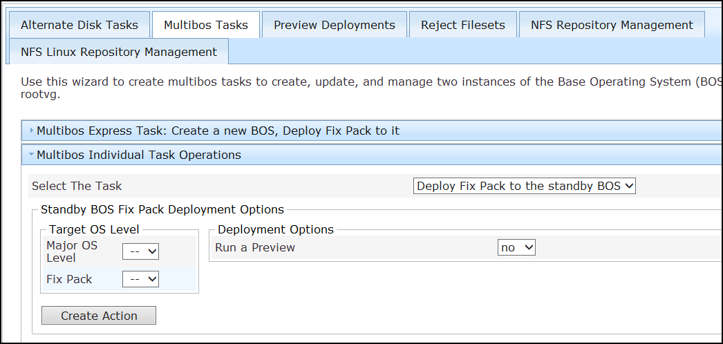

- From the BigFix console, click .
- Under the Multibos Tasks tab, click Multibos Individual Task Operations to expand the options pane.
Select Deploy Fix Packs to the standby
BOS.
Figure 1. Deploying Fix Packs to the standby BOS
- Select the major version and fix pack of the operating system level that you want to deploy to the standby BOS.
- Verify that the preview option is at the preferred setting.
- Click Create Action.
- Deploy the action.
