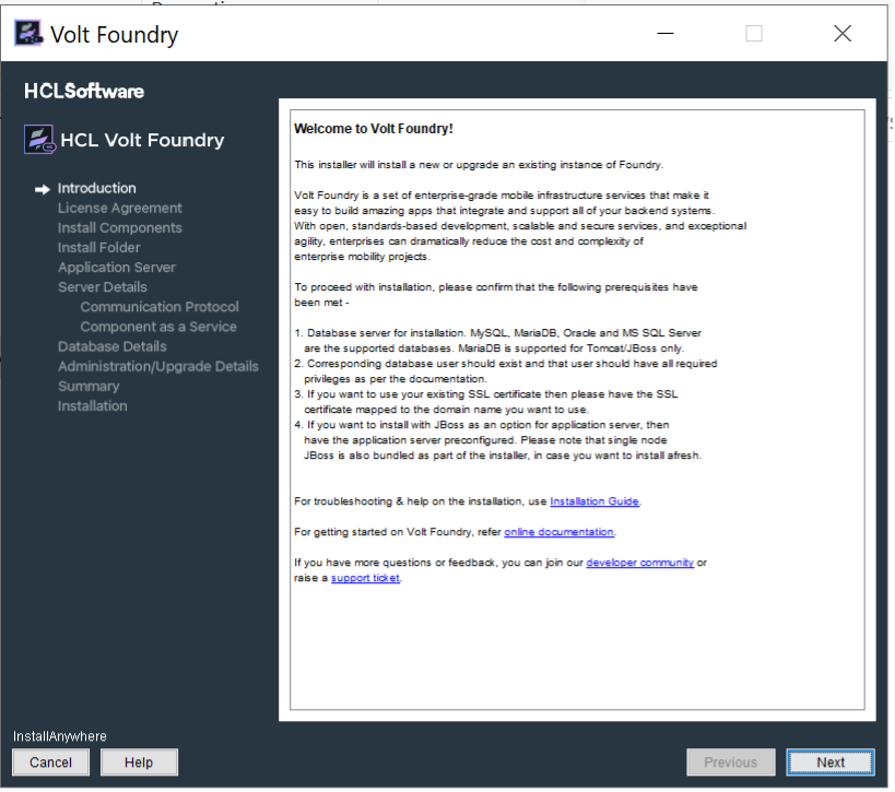

A dialog with the Volt MX logo appears.
The Welcome To Volt MX Foundry windows appears.
Read the instructions carefully before installing Volt MX Foundry Console.
Read the instructions carefully, and click Next.

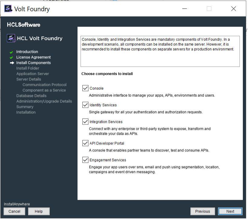

Click Next. The Choose components to install window appears.
Select one or more check boxes for the supported components. By default, the Console, Identity Services, Integration Services, and Engagement Services check boxes are selected.
- Console - To install Volt MX Foundry Console, select the Console check box.

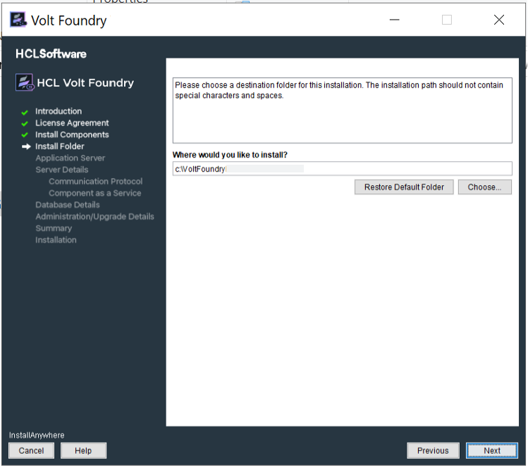

Click Next. The Install Folder window appears. The selected path appears in the Where would you like to install field.
Click Choose to browse the required folder from your system.

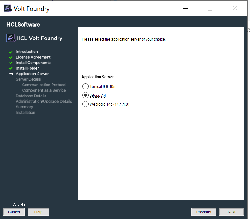

Click Next. The Application Server window appears asking you to choose the application server. By default, the Application Sever is set to Tomcat.
In the Application Server window, click JBoss, and then click Next.

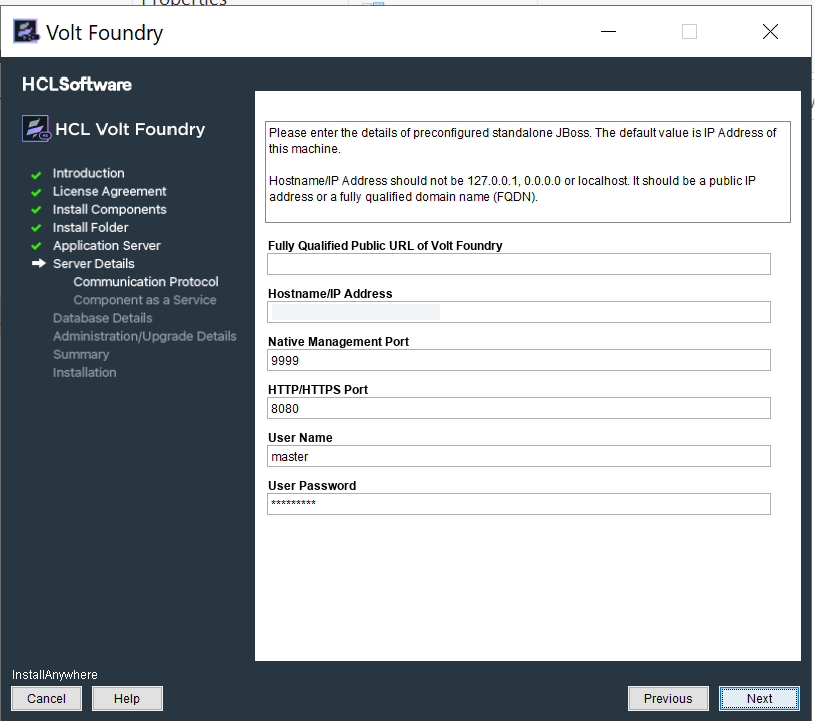

The Application Server Details window will appear with the following details:
Enter the following details:
Fully Qualified Public URL of Volt MX Foundry: Enter load balancer URL to use public communication.
Master Node Hostname/IP Address: Enter public Hostname/IP of JBoss master node. Ensure that you have access to JBoss master node from your installation system.
Master Node Management Port: Enter native port of JBoss master node.
Master Node HTTP/HTTPS Port: Enter port of Volt MX Foundry Console.
User: Enter the user that you configured in the master node of the JBoss cluster.
Master Node User Password: Enter the password that you configured in the master node of the JBoss cluster.

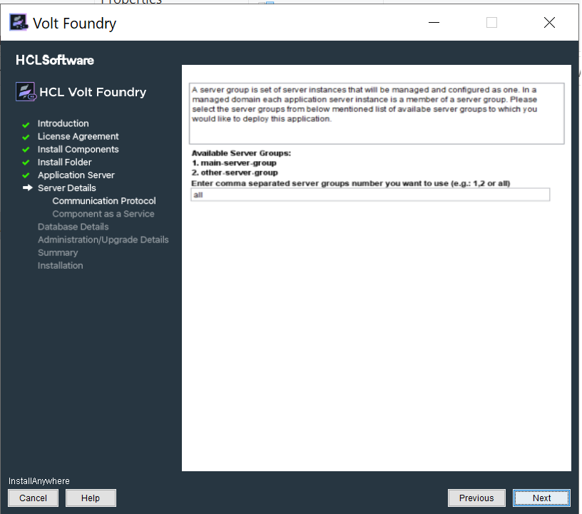

Click Next. The Server Groups window appears.
Enter server groups separated by commas - for example, 1, 2, shown above. Click Next. The system displays the selected groups in the Selected Server Group window.

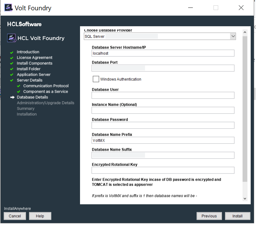

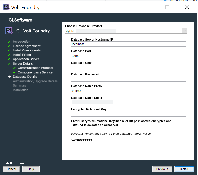

Click Next. The Database Details window appears. From the Database Choice drop-down, choose one of the databases to display database details. By default, this option is set to MySQL.
Enter the following database details for MySQL.
MySQL Cluster - Group Replication is a new replication type supported from MySQL 5.7 onwards. In case your Foundry setup consists of a MySQL Cluster with Group Replication, please select the same from the list of Database Type Providers instead of the default MySQL option.
- Database Server Hostname/IP: Enter the DB server Hostname/IP to be used to create a database of selected components of Volt MX Foundry. By default, the server Hostname/IP is set as localhost.
- Database Port: Enter the database port of the MySQL Server. By default, this field is set to 3306 for MySQL.
- Database User: Enter the user name used while creating the database user - for example, dbclient.
- Database Password: Enter the user password used while creating the database user.
Database Name Prefix: Enter valid prefix databases - for example, jboss.
For example, the following databases are created for all components: jbossglobaldb54, jbossconfigdb54, jbossconsoledb54, jbossaccountsdb54, jbossmfreportsdb54, jbossadmindb54 and jbossmfreportsdb54
Database Name Suffix: Enter valid suffix for all databases - for example, 54

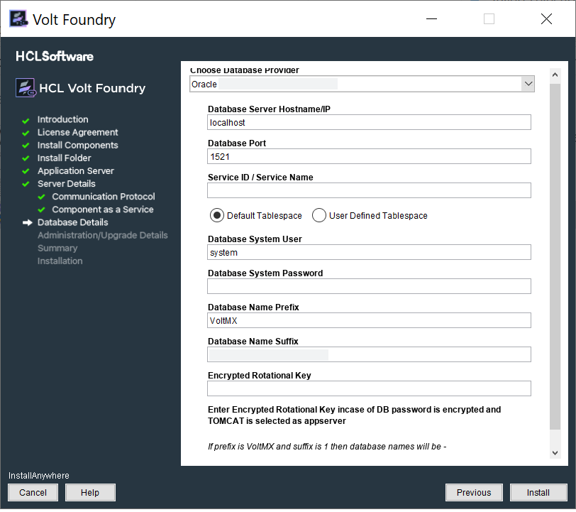

- Enter the following database details for Oracle.
- Database Port: Enter the database port of the Oracle Server. By default, this field is set to 1521 for oracle.
- Service ID / Service Name: Enter Oracle service ID or service name. Service ID is unique alias given to an instance name of Oracle DB.
- Select the tablespace for Oracle database:
Important: If tablespaces were already created, the DBA must grant quota (permissions) on these tablespaces to installer with admin option.
The DBA also must include grant quota on the schemas from installer login.
- Default Tablespace: If selected, the database schema and SQL scripts migration happens automatically to the default tablespace for example,
USERS-
User Defined Tablespace: If selected, enter the tablespaces for the following:
Data Tablespace:
Enter the name for Data tablespace.This is a mandatory field. If the Data tablespace field empty, the installers displays the error message:
If the Data tablespace (for example, SampleData) does not exist, the installers displays the error message:
Index Tablespace: Enter the name for Index tablespace.
If input for Index Tablespace is not provided, then the value will be set to the provided Datatable space value. - LOB Tablespace: Enter the name for LOB tablespace.
If input for LOB Tablespace is not provided, then the value will be set to the provided Datatable space value. * Database System User: Enter the user name used while creating the database user - for example, dbclient. * Database System Password: Enter the user password used while creating the database user. * Database Name Prefix: Enter valid prefix databases - for example, Volt MX. * Database Name Suffix: Enter valid suffix for all databases - for example, 1.
If a database faces connection issues, the system displays an error message. For example:
Enter the following database details for *SQL Server*.
Important:
If you want to enable Windows Authentication Support on SQL Server, run the following command to start the installation process after extracting the artefact:
VoltMXFoundryInstaller-9.x.x.x_GA.exe -Dprop.java.library. path=< location of sqljdbc_auth.dll >
Note: If you choose to enable Windows Authentication support on SQL Server, you do not need to provide the Database System User and Database System Password.
- Database Port: Enter the database port of the SQL Server. By default, this field is set to 1433 for SQL.
- Database System User: Enter the user name used while creating the database user - for example, dbclient.
- Instance Name (optional): Enter the instance name for the database. This information is optional.
- Database System Password: Enter the user password used while creating the database user.
- Database Name Prefix: Enter valid prefix databases - for example, Volt MX.
- Database Name Suffix: Enter valid suffix for all databases - for example, 1.

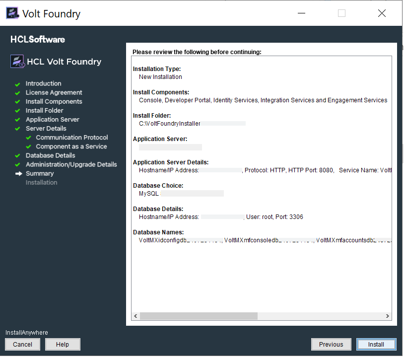

Click Next. The Pre-Installation Summary window appears.

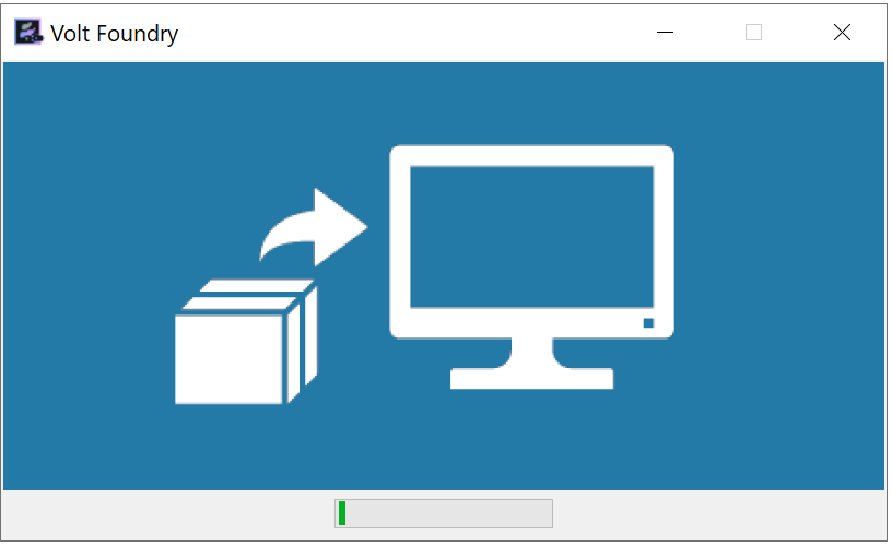

Click Install. The Installing Volt MX Foundry Console window appears.

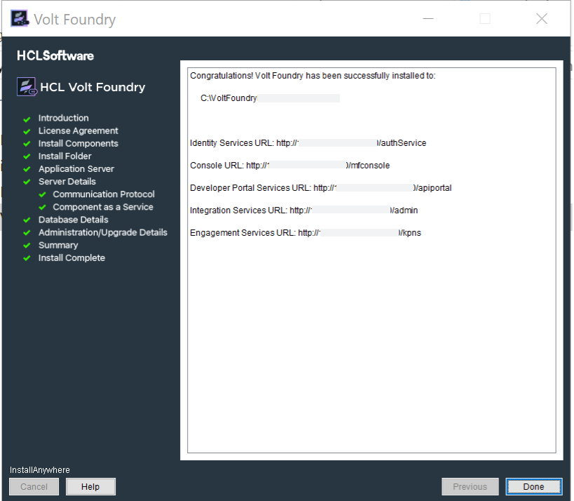

Once the installation completes, the Install Complete window appears with the confirmation message.
Click Done to close the window.
