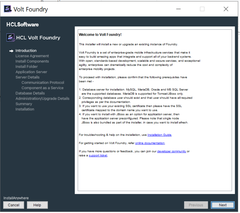

  2. Double-click VoltMXFoundryInstaller-x.x.xx.x_GA.exe to launch the installer.
    The InstallAnywhere dialog appears. The InstallAnyWhere dialog displays information about the progress of the software installation at run time.
    A dialog with the Volt MX Foundry logo appears.
  3. The Welcome to Volt MX Foundry windows appears.
    Read the instructions carefully before installing Volt MX Foundry Console.
  4. Read the instructions carefully, and click Next.

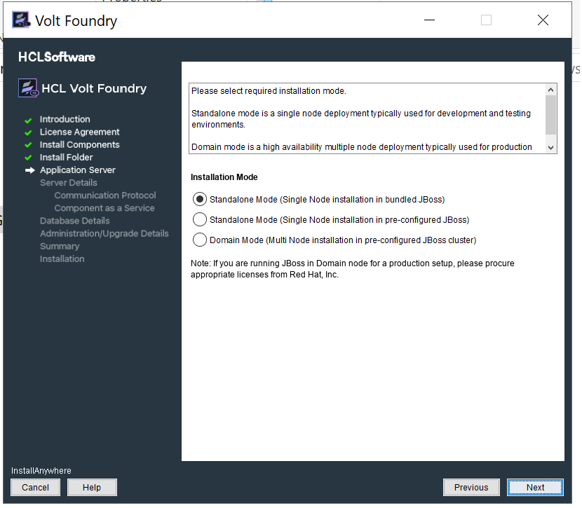

  14. In the Application Server window, click JBoss and click Next. The Installation Mode window appears asking you to choose the mode. By default, this option is set to Standalone Mode.
    • Standalone Mode (Single Node installation in Bundled JBoss): To install Volt MX Foundry on single node on JBoss that is bundled with the Volt MX Foundry installer, click (Single Node installation in Bundled JBoss).
    • Standalone Mode (Single Node installation in pre-configured JBoss): To install Volt MX Foundry on single node on JBoss that is installed on your machine, click Standalone Mode(Single Node installation in pre-configured JBoss). For more details on how to install Volt MX Foundry on the existing JBoss, refer to Installing VoltMX Foundry on a pre-configured standalone JBoss - (Single Node).
    • Domain Mode (Multi node installation in pre-configured JBoss): To install Volt MX Foundry on JBoss multinode,  click Domain Mode. Before installing domain mode, ensure that the JBoss cluster is configured on your install system. For more details on how to install Volt MX Foundry on Domain mode, refer to Multi-Node Installation Procedure.
    • Important: Before installing Volt MX Foundry on domain mode, ensure that the JBoss cluster is configured on your install system.
  15. Click the Standalone Mode (Single Node installation in bundled JBoss).

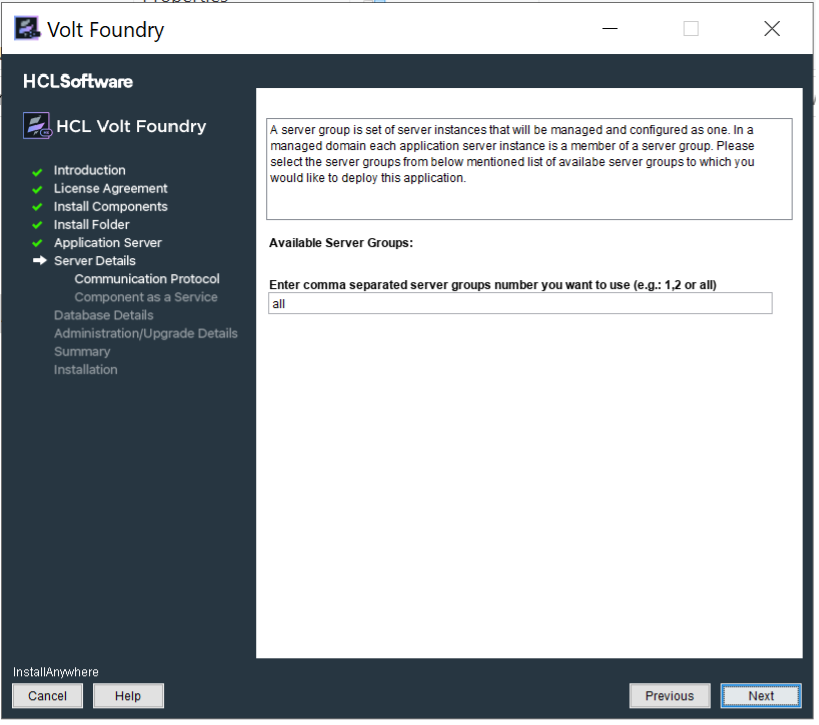

    ![](Resources/Images/JBoss_ServerGroups.png)

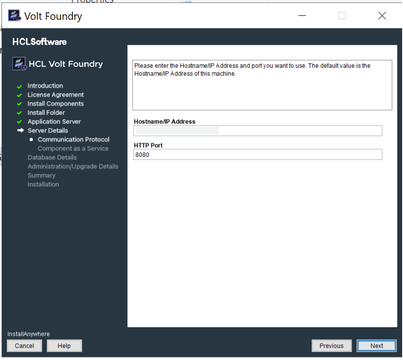

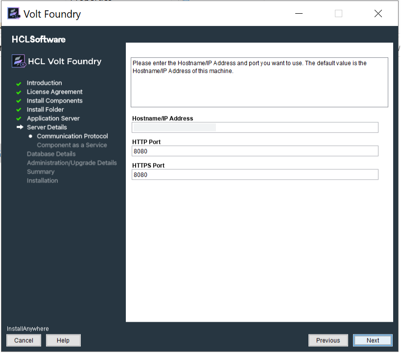

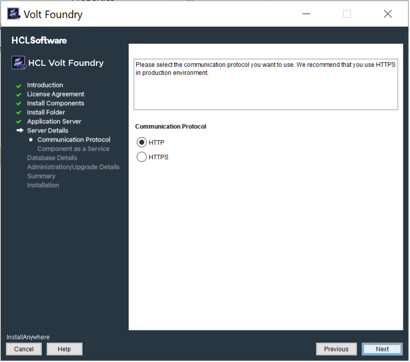

    The HTTP or HTTPS window appears asking you to choose the HTTP or HTTPS. By default, this option is set to HTTP.
    a. In HTTP or HTTPS, if you select HTTP, the following window appears. Enter the Hostname/IP Address, and HTTP Port. Click Next.
    b. In HTTP or HTTPS, if you select HTTPS, the following window appears. Enter the Hostname/IP Address, HTTP Port, and HTTPS Port. Click Next.
    Important: After installing Volt MX Foundry, import your SSL certificate (for example, domain.subdomain.crt) into your Volt MX Foundry Installer's JRE trusted certificate authority (CA) certificates file - for example, <INSTALL_DIR>\jre\lib\security\cacerts
    If your SSL certificate is not configured, the system displays an error - for example, "peer not authenticated."
    For details, refer to Troubleshoot with SSL Certificate Issues.
    Based on the inputs provided in the previous  HTTP or HTTPS  >  a  or  HTTP or HTTPS  >  b, one of the following error messages appears:
    • If you provide an invalid hostname/IP address, an alert displays:
    • If a port is in use, an alert displays:
    • If you provide an invalid Port, an alert displays:
    • If you provide the same port numbers for HTTP and HTTPS, an alert displays:

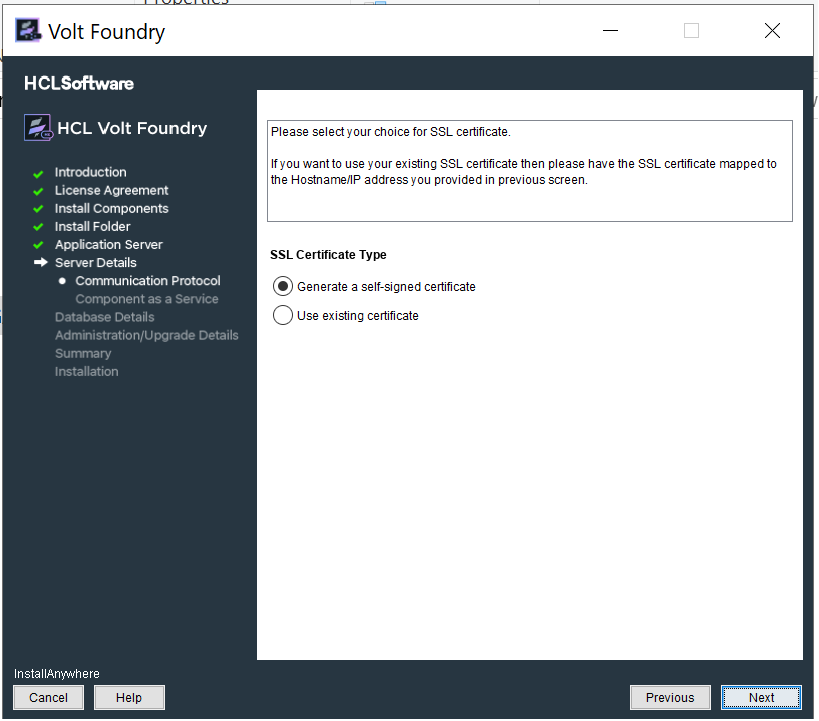

  17. After you configure the application server details in the HTTP or HTTPS window, click Next. The SSL Configuration for HTTPS Communication option appears only if you select HTTPS. By default, the Generate a self-signed certificate option is selected. Choose one of the following two options: a. To generate a self-signed certificate, click Generate a self-signed certificate, and click Next. The Details for self-signed SSL Certificate window appears.
    Important:  To add an existing SSL certificate to a cacerts file, refer to How to Add Your Existing SSL Certificate.

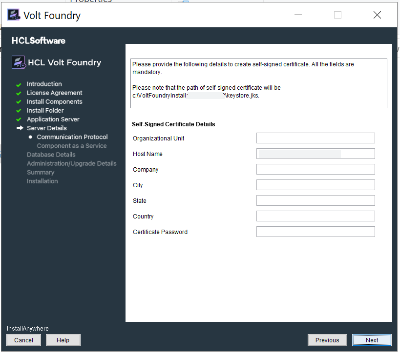

    Note: The path for a self-signed certificate is in this location: <install folder>\keystore.jks
    Enter details for the following fields:
    • Organization Unit: Enter your business unit name.
    • Host Name: Enter your domain name - for example, hcl.net
    • Company: Enter your company name.
    • City: Enter your city name.
    • State: Enter your state name.
    • Country: Enter your country name.
    • Keystore Password: Enter the password for the .JKS file that the installer will generate.
    • If you enter invalid details, the following error message is displayed:
    b. To use an existing SSL certificate, click Use existing certificate, and click Next. The SSL Certificate window appears.
    Note: Provide path for .jks file as input.
    In the SSL Configuration window, enter the file path for keystore file and password details.
    • If you enter invalid certificate details, the following error message is displayed:

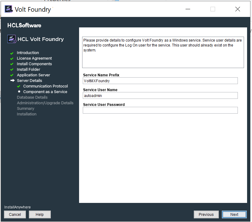

  18. Click Next to display the Service Details window.

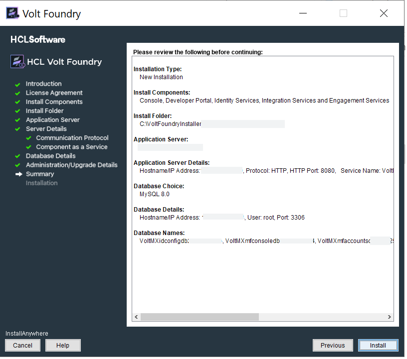

  23. Enter the databases details, and click Next. The Pre-Installation Summary window appears.
  24. Click Install. The Installing Volt MX Foundry window appears.
