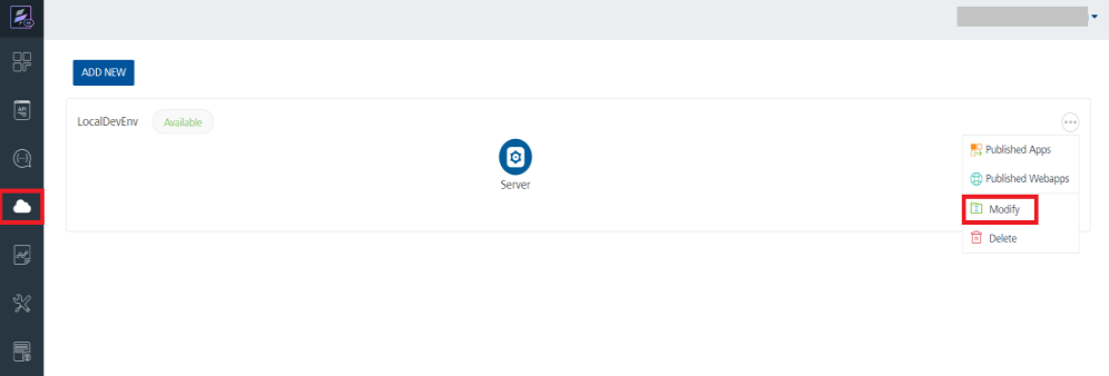

  1. Log in to Foundry Console which you upgraded for V9.x.
  2. In your Volt MX Foundry account, click Environments. The Environments page appears.
  3. Click MODIFY for the environment. The Modify Environment page appears, shown below:
  4. In the Modify Environment page, click SAVE.

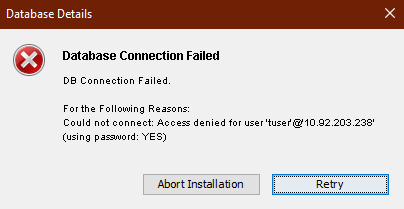

Issue:
After entering Database details the DB connection fails with the following error:
ERROR,main,action.LogFlywayJavaMigrations:17,installCore,ERROR: Unable to obtain Jdbc connection from DataSource (jdbc:mariadb://odc3dmv-mf-db01.in.dc.gov:3306/?relaxAutoCommit=true) for user 'madmin': Could not connect: Access denied for user 'madmin'@'odc3dmv-mf-web02.in.dc.gov' (using password: YES)
Workaround:
The password used for the Database must not contain exclamation marks (!).

Workaround:
  1. Log in to your Foundry Console.
  4. Click SAVE.
    Now you can execute the aforementioned services successfully.
