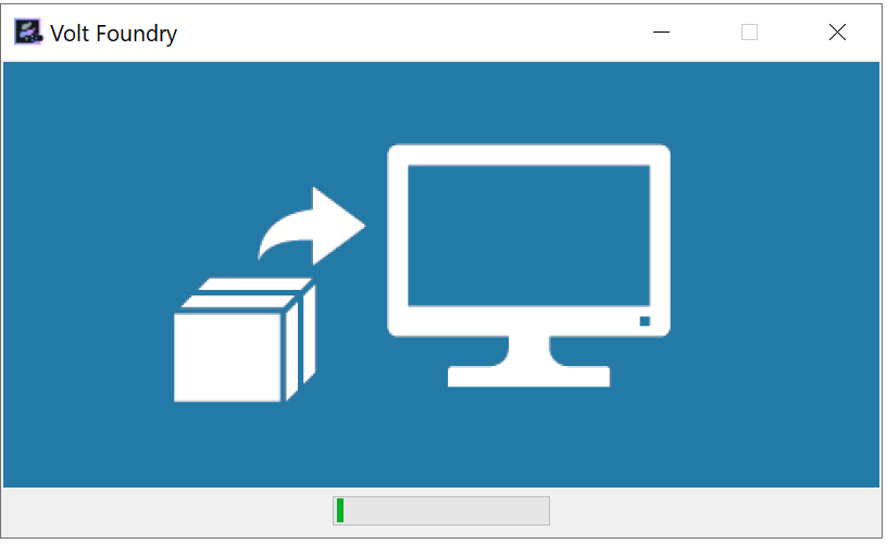

  2. Double-click VoltMXFoundryInstaller-x.x.x.x_GA.exe to launch the installer.
    The InstallAnywhere dialog appears. The InstallAnyWhere dialog displays information about the progress of the software installation at run time.
    A dialog with the Volt MX Foundry logo appears.

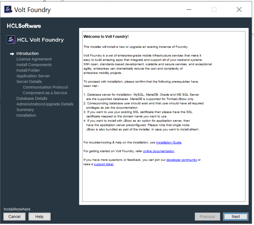

  3. The Welcome to Volt MX Foundry windows appears.
    Read the instructions carefully before installing Volt MX Foundry Console.
  4. Read the instructions carefully, and click Next.

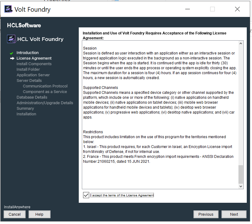

    The LICENSE AGREEMENT window appears.
  5. Scroll until end of the screen, and then select the "I accept the terms of the License Agreement" option.

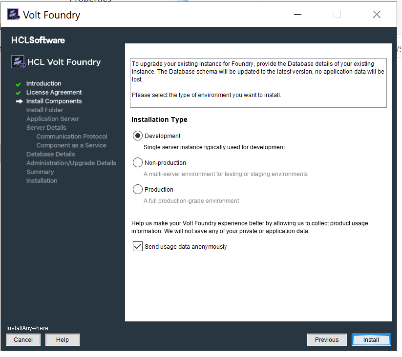

  6. Click Next. The Install Components window appears with the following supported installation types:
    • Development for single machine instance.
    • Non-Production for larger environments like Staging or Testing.
    • Production for a full production-grade instance.
    Installation environment is set to Development by default . Choose one of the install type based on your requirement.
  7. Select the Send usage data anonymously check box. This allows HCL to collect product usage information to make your Volt MX Foundry experience better. HCL does not save any of your private or application data. By default this check box is selected.

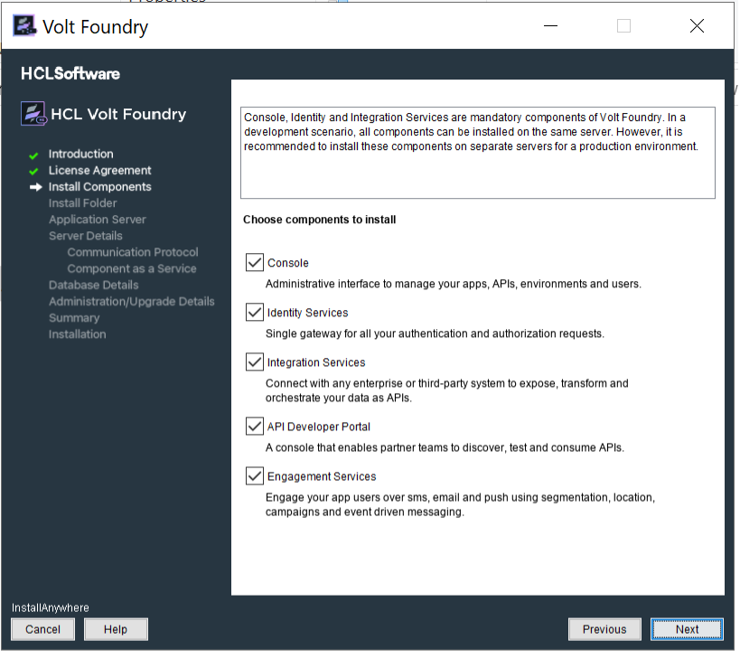

  8. Click Next. The Choose components to install window appears.
  9. Select one or more check boxes for the supported components. By default, the Console, Identity Services, Integration Services, Developer Portal, and Engagement Services check boxes are selected:
    • Console - To install Volt MX Foundry Console, select the Console check box.
      The system creates the following databases: <prefix>mfconsoledb<suffix>, <prefix>mfaccountsdb<suffix>, and  <prefix>mfreportsdb<suffix>.
    • Identity Services - To install Volt MX Identity Services, select the Identity Services check box.
      The system creates the following database: <prefix>idconfigdb<suffix>.
    • Integration Services - To install Volt MX Foundry Integration Services, select the Integration Services check box.
      The system creates the following databases: voltmxadmindb  and  mfreportsdb.
    • API Developer Portal - To install developer portal, select the API Developer Portal check box.
      Note: During installation if you have selected API Developer Portal, the API Developer Portal is created. You can directly access your Volt MX Developer Portal in Volt MX Foundry Console.
    • Engagement Services - To install Volt MX Foundry Engagement Services, select the Engagement Services check box.
      The system creates the following database: <prefix>vpnsdb<suffix>.

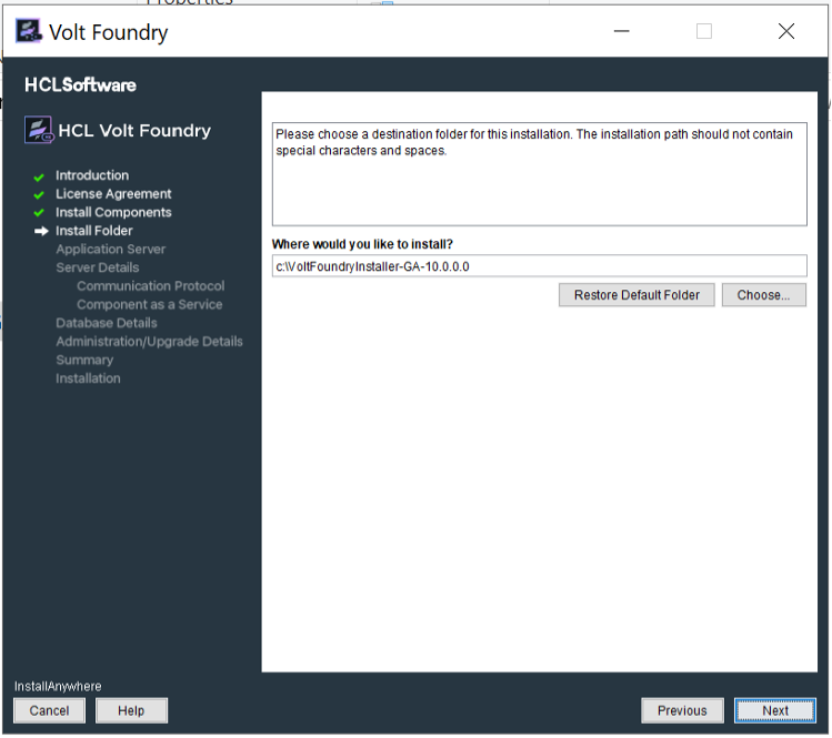

  1. Click Next. The Install Folder window appears. The selected path appears in the Where would you like to install field.
  2. Click Choose to browse the required folder from your system.
  3. Click Next. The Application Server window appears asking you to choose the application server. By default, the Application Sever is set to Tomcat.

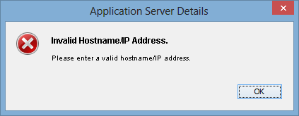

    If any input goes wrong among the inputs provided in the previous steps: HTTP or HTTPS  >  a  or  HTTP or HTTPS  >  b, one of the following error messages will appear:

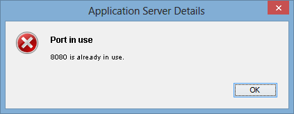

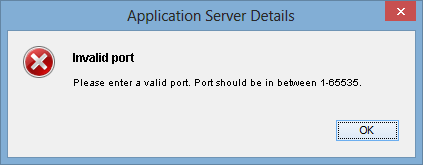

    • If you provide an invalid hostname/IP address, the following alert is displayed:
    • If a port is in use, the following alert is displayed:
    • If you provide an invalid Port, the following alert is displayed:
    • If you provide the same port numbers for HTTP and HTTPS, the following alert is displayed:

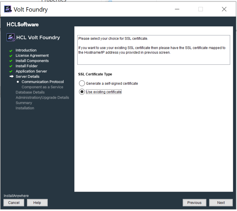

  7. To generate a self-signed certificate, click Generate a self-signed certificate, and click Next. The Details for self-signed SSL Certificate window appears.
    Important:  To add an existing SSL certificate to a cacerts file, refer to How to Add Your Existing SSL Certificate.
    Note: The path for a self-signed certificate is in this location: <install folder>\keystore.jks

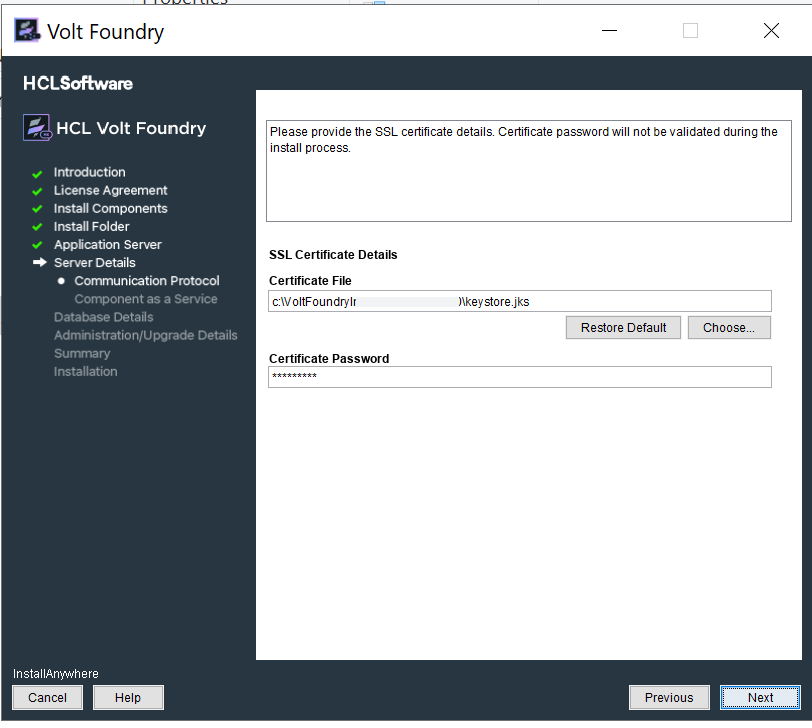

    2. To use an existing SSL certificate, click Use existing certificate, and click Next. The SSL Certificate window appears.
    Note: Provide path for .jks file as input.
    In the SSL Configuration window, enter the file path for keystore file and password details. * If you enter invalid certificate details, the following error message is displayed:

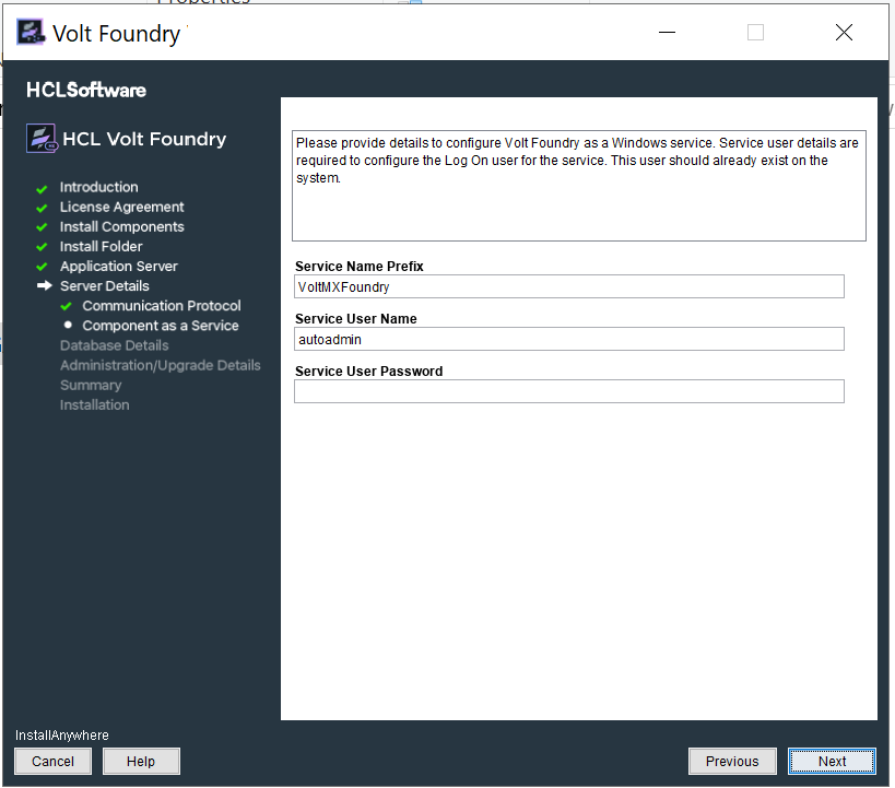

  8. Click Next to display the Service Details window.

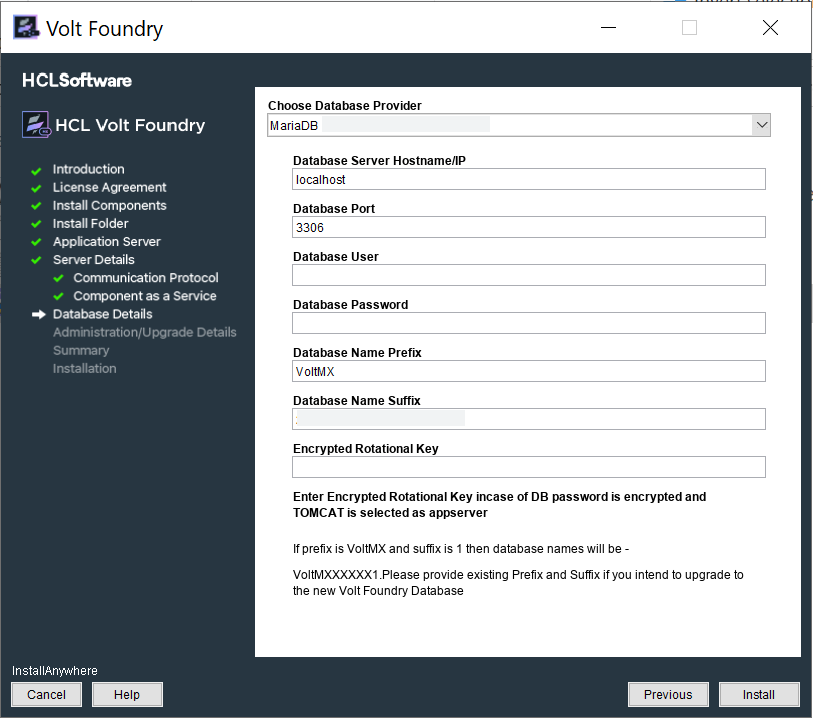

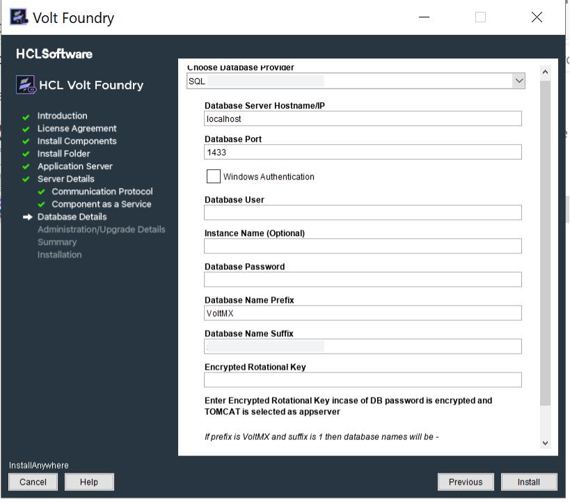

  9. Click Next. The Database Details window appears. From the Choose Database Provider drop-down, select one of the databases to display database details and fill the details. By default, this option is set to MySQL.
    • Enter the following database details for MySQL.
      MySQL Cluster - Group Replication is a new replication type supported from MySQL 5.7 onwards. In case your Foundry setup consists of a MySQL Cluster with Group Replication, please select the same from the list of Database Type Providers instead of the default MySQL option.
      • Database Server Hostname/IP: Enter the DB server Hostname/IP to be used to create a database of selected components of Volt MX Foundry. By default, the server Hostname/IP is set as localhost.
      • Database Port: Enter the database port of the MySQL Server. By default, this field is set to 3306 for MySQL.
      • Database User: Enter the user name used while creating the database user - for example, dbclient.
      • Database Password: Enter the user password used while creating the database user.
      • Database Name Prefix: Enter the valid prefix databases - for example, Volt MX.
      • Database Name Suffix: Enter the valid suffix for all databases - for example, 1.
      • Encrypted Rotational Key: Enter the rotational key that you received from the encryption utility. This is applicable only if you are using an encrypted database password. For more information, refer to How to encrypt the database password.

      • Database Name Suffix: Enter the valid suffix for all databases - for example, 54.

    • Enter the following database details for MariaDB.
    • Database Port: Enter the database port of the MariaDB. By default, this field is set to 3306 for MariaDB.
    • Database User: Enter the user name used while creating the database user.
      Important: The Reports Database Name field appears only if you have selected the Console, Identity, and Integration during Install Components.
  10. After entering database server details, click Next.

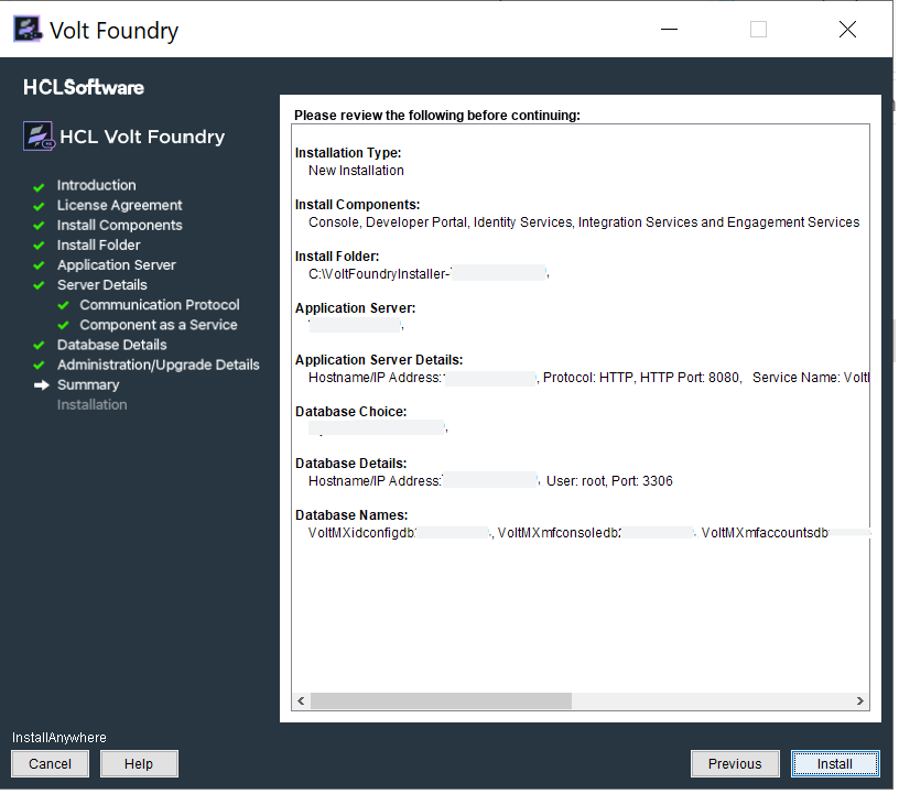

  13. Enter the databases details, and click Next. The Pre-Installation Summary window appears.

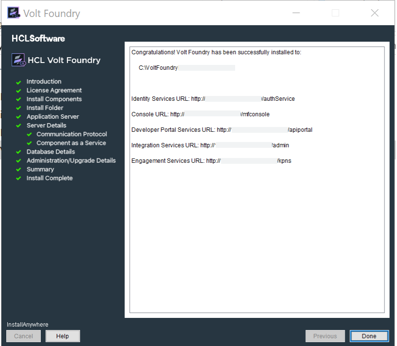

  14. Click Install. The Installing Volt MX Foundry window appears.
    Note:  Sometimes, even after showing 100% installation progress, Volt MX Foundry Installer takes around 20 more minutes to complete installation on Windows.
    Once the installation is completed, the Install Complete window appears with a confirmation message.
  15. Copy the URLs and save them in a notepad. Click Done to close the window.
