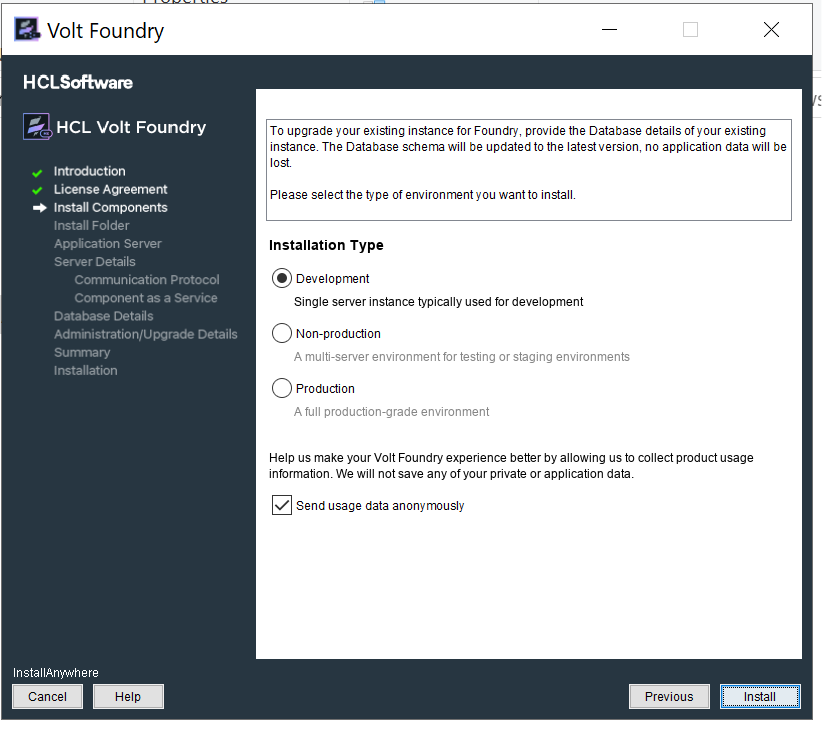

  6. Click Next. The Install Components window appears with the following supported installation types:
    • Development for single machine instance.
    • Non-Production for larger environments like QA or UAT.
    • Production for the production instance.
    Installation environment is set to Development by default .
  7. Choose one of the appropriate install type based on your license - for example, Development, Non-Production, or Production.
  8. Select the Send usage data anonymously check box. Allows HCL to collect product usage information to make your Volt MX Foundry experience better. HCL does not save any of your private or application data. By default this check box is selected.

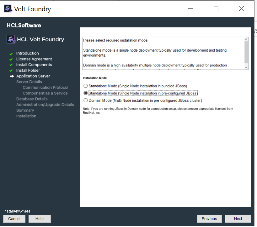

  13. Click Next. The Application Server window appears asking you to choose the application server. By default, the Application Sever is set to Tomcat.
  14. Click JBoss.
  15. Click Next. The Installation Mode window appears asking you to choose the mode. By default, this option is set to Standalone Mode (Single Node installation in bundled JBoss)
    Important: To install Volt MX Foundry on single node on JBoss that is installed along with the Volt MX Foundry Installer, click Standalone Mode (Single Node installation in bundled JBoss). For more details, refer to Standalone Mode (Single Node in bundled JBoss) Installation.
    To install multinode, click Domain Mode. Before installing domain mode, ensure that the JBoss cluster is configured on your install system. For more details, refer to Multi-Node Installation Procedure.

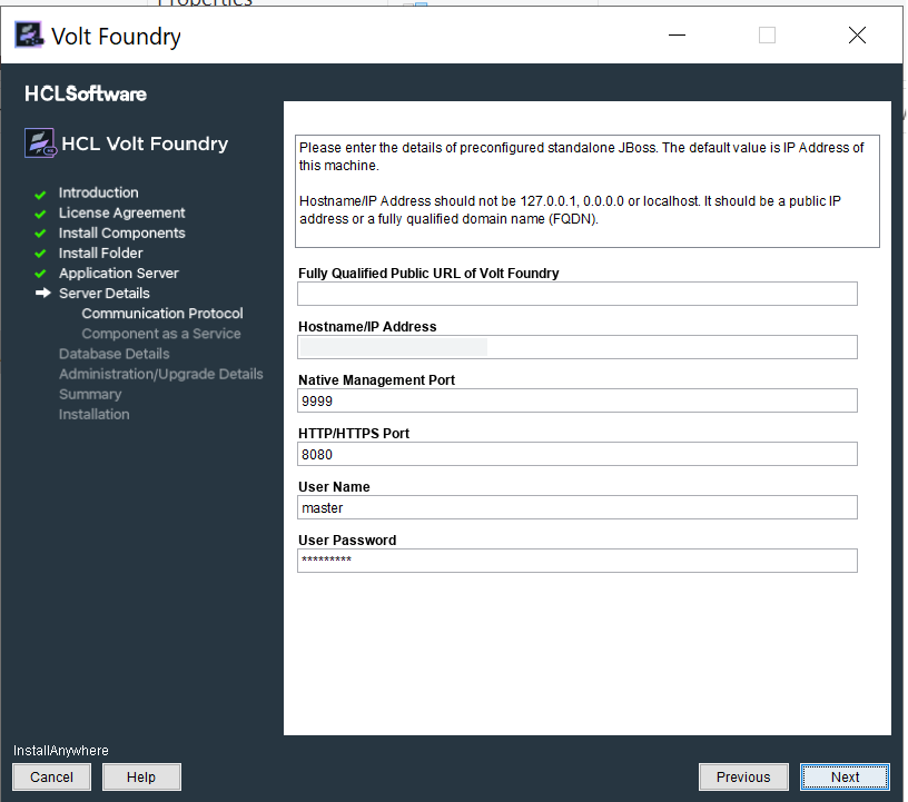

  16. Click Standalone Mode (Existing) and then click Next. The Application Server Details window will appear with the following details:
  17. Enter the following details:
    • Fully Qualified Public URL of Volt MX Foundry: Enter load balancer URL to use public communication. For example, <http/https>://<hostname>:<http/https port>.
    • Hostname/IP Address: Enter public Hostname/IP of JBoss master node. Ensure that you have access to JBoss master node from your installation system.
    • Management Port: Enter native port of JBoss node.
    • HTTP/HTTPS Port: Enter port of Volt MX Foundry Console.
    • User: Enter the user that you configured in the master node of the JBoss cluster.
    • User Password: Enter the password that you configured in the node of the JBoss .
