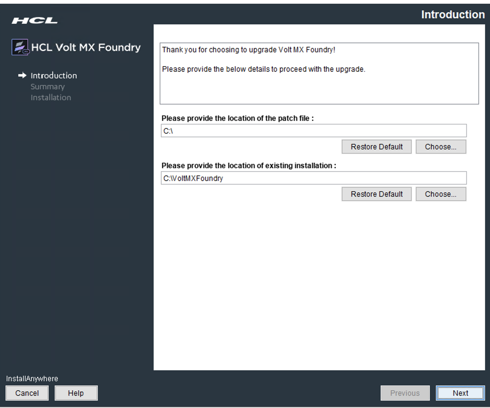

  1. Next, the Introduction window appears asking for following details: Enter the details to proceed with the upgrade:
  • Please provide the location of the patch file: Provide the patch file location of the Volt Foundry component that you wish to install to current version. For example, middleware.zip. For information about creating a patch file, refer to Creating a patch file for Foundry components.
  • Please provide the location of existing installation. The default install location appears in this field. Provide the location of existing Volt Foundry installation that you wish to upgrade with the selected patch version.
