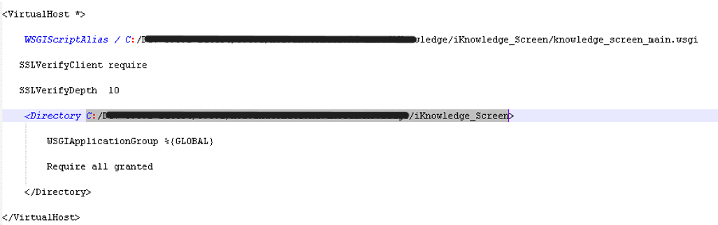

  2. At the bottom of iKnowledgeScreen.conf file you will find the path to the python files as highlighted in the below figure.
