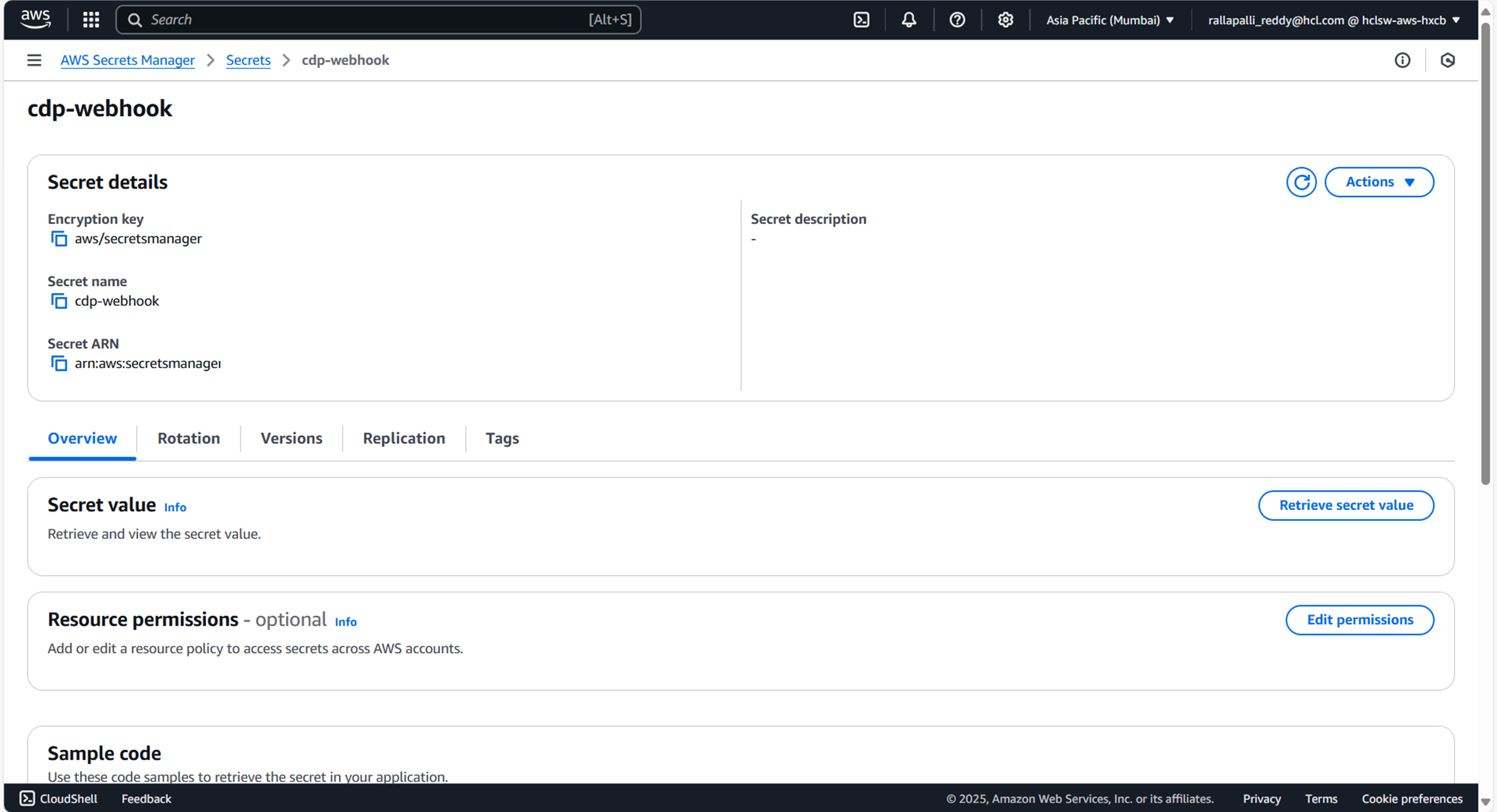

Make sure to create a cdp-webhooks secret in the AWS secret manager before deploying CDP Webhooks.
To create a CDP Webhooks secret in the AWS secret manager , follow the steps below:
  1. Create a cdp-webhooks secret sample key and value, and update the actual values as shown below.

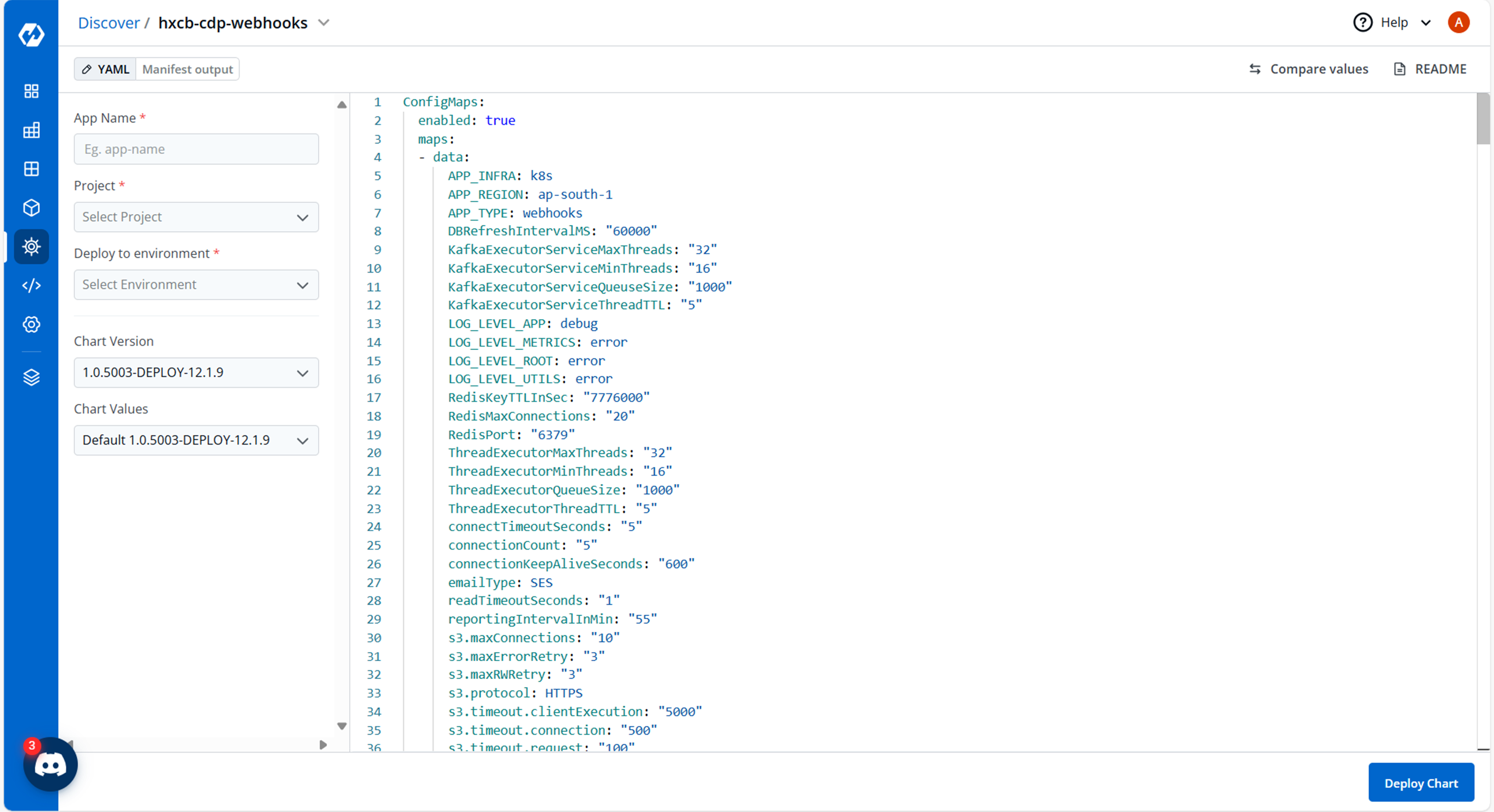

  2. Update the ConfigMaps data with actual values, and create required Kafka topics before deployment.

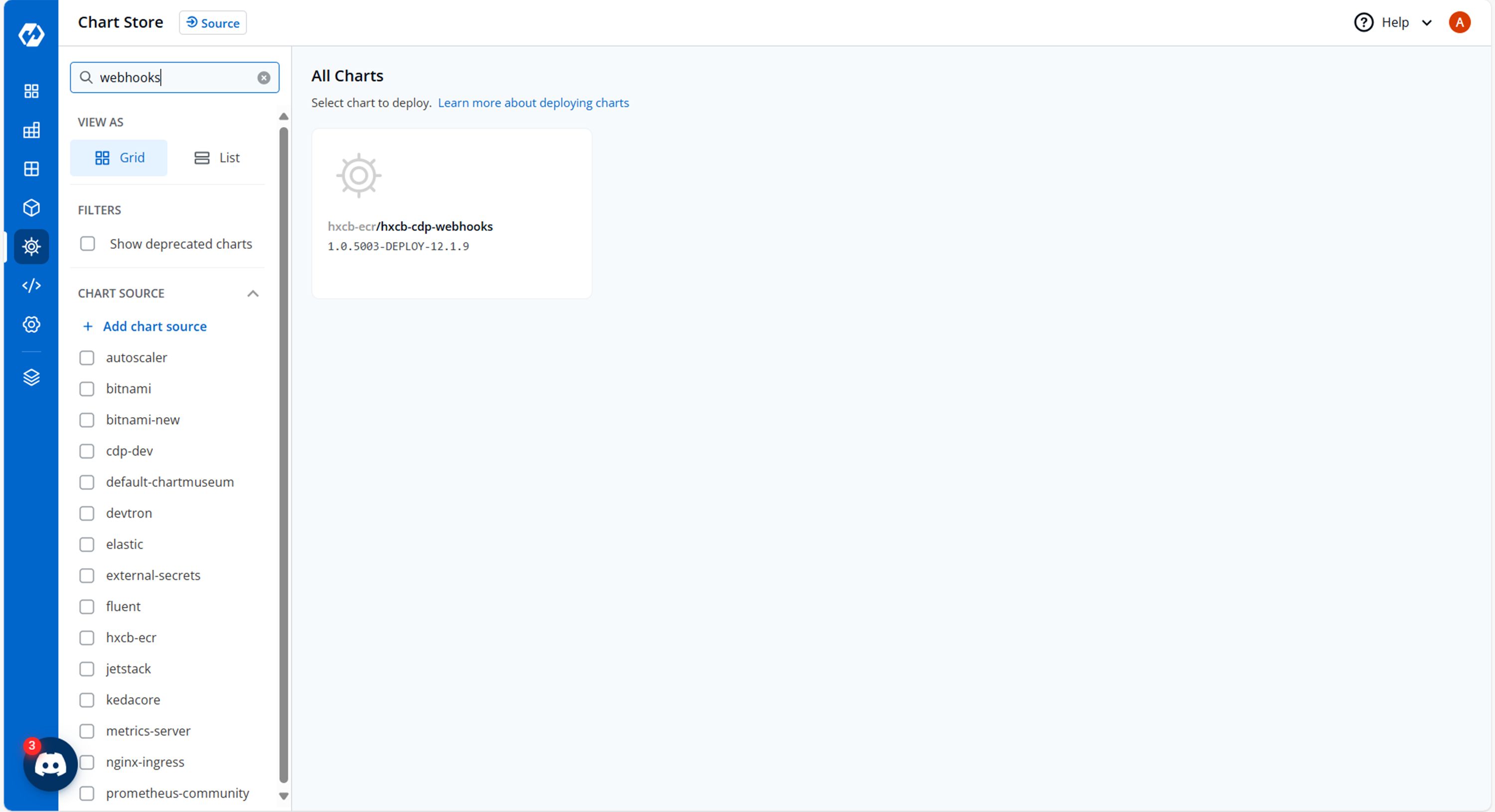

  1. Navigate to the Devtron Chart Store, and select the cdp-webhooks chart to deploy.
  2. Now, configure and deploy the cdp-webhooks charts.
  3. In the YAML section, update the ConfigMap using the below details and deploy the chart.
    APP_TYPE: webhooks
    APP_REGION: ap-south-1
    APP_INFRA: k8s
    DBRefreshIntervalMS: "60000"
    RedisPort: "6379"
    RedisMaxConnections: "20"
    RedisKeyTTLInSec: "7776000"
    ThreadExecutorMinThreads: "16"
    ThreadExecutorMaxThreads: "32"
    ThreadExecutorThreadTTL: "5"
    ThreadExecutorQueueSize: "1000"
    connectionKeepAliveSeconds: "600"
    connectionCount: "5"
    readTimeoutSeconds: "1"
    writeTimeoutSeconds: "10"
    connectTimeoutSeconds: "5"
    s3.protocol: HTTPS
    s3.maxErrorRetry: "3"
    s3.maxConnections: "10"
    s3.maxRWRetry: "3"
    s3.timeout.socket: "100"
    s3.timeout.connection: "500"
    s3.timeout.clientExecution: "5000"
    s3.timeout.request: "100"
    KafkaExecutorServiceMinThreads: "16"
    KafkaExecutorServiceMaxThreads: "32"
    KafkaExecutorServiceThreadTTL: "5"
    KafkaExecutorServiceQueuseSize: "1000"
    reportingIntervalInMin: "55"
    LOG_LEVEL_APP: debug
    LOG_LEVEL_METRICS: error
    LOG_LEVEL_ROOT: error
    LOG_LEVEL_UTILS: error
    emailType: SES

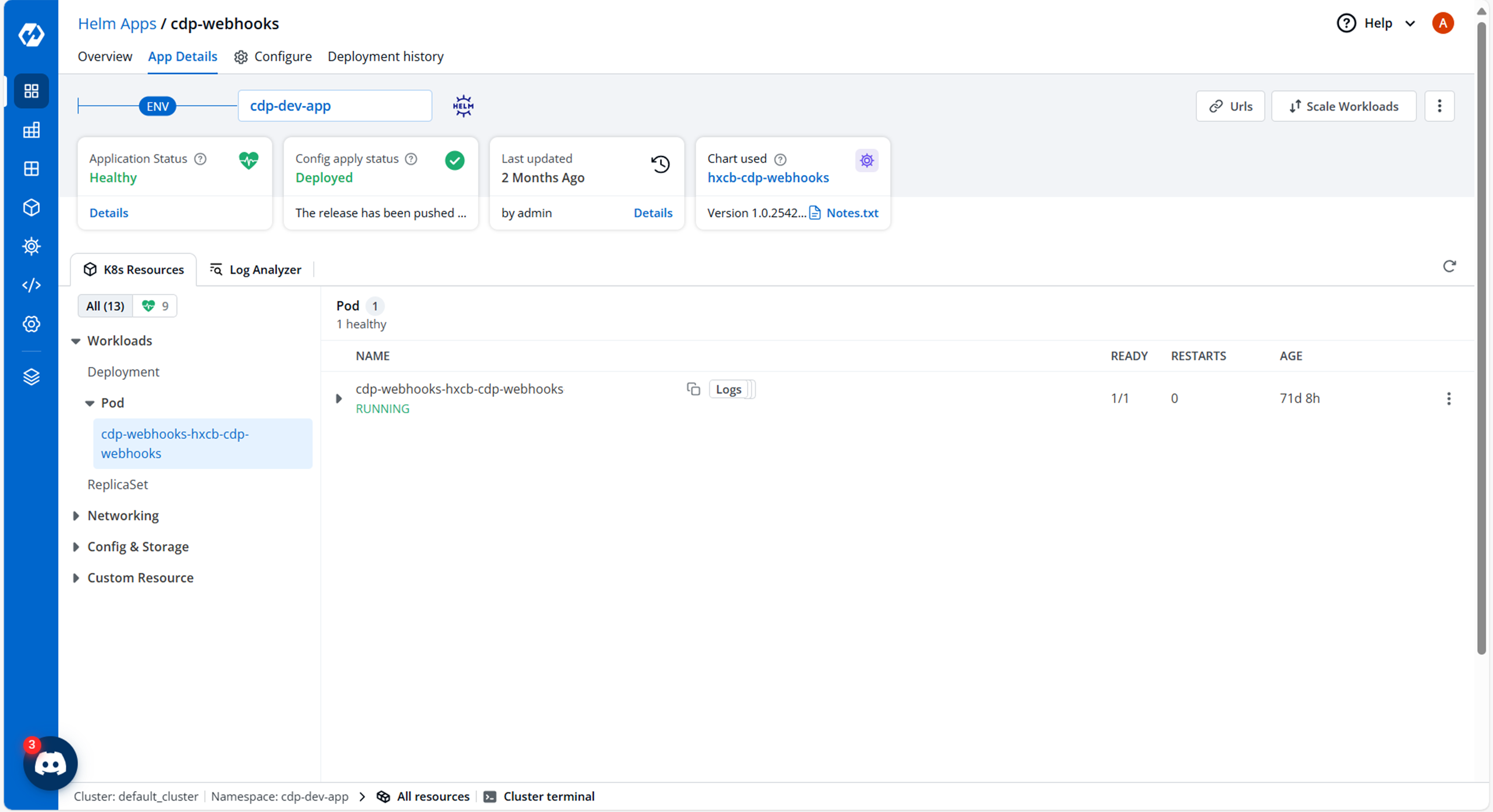

  4. On successful deployment, validate the deployment as shown below.
