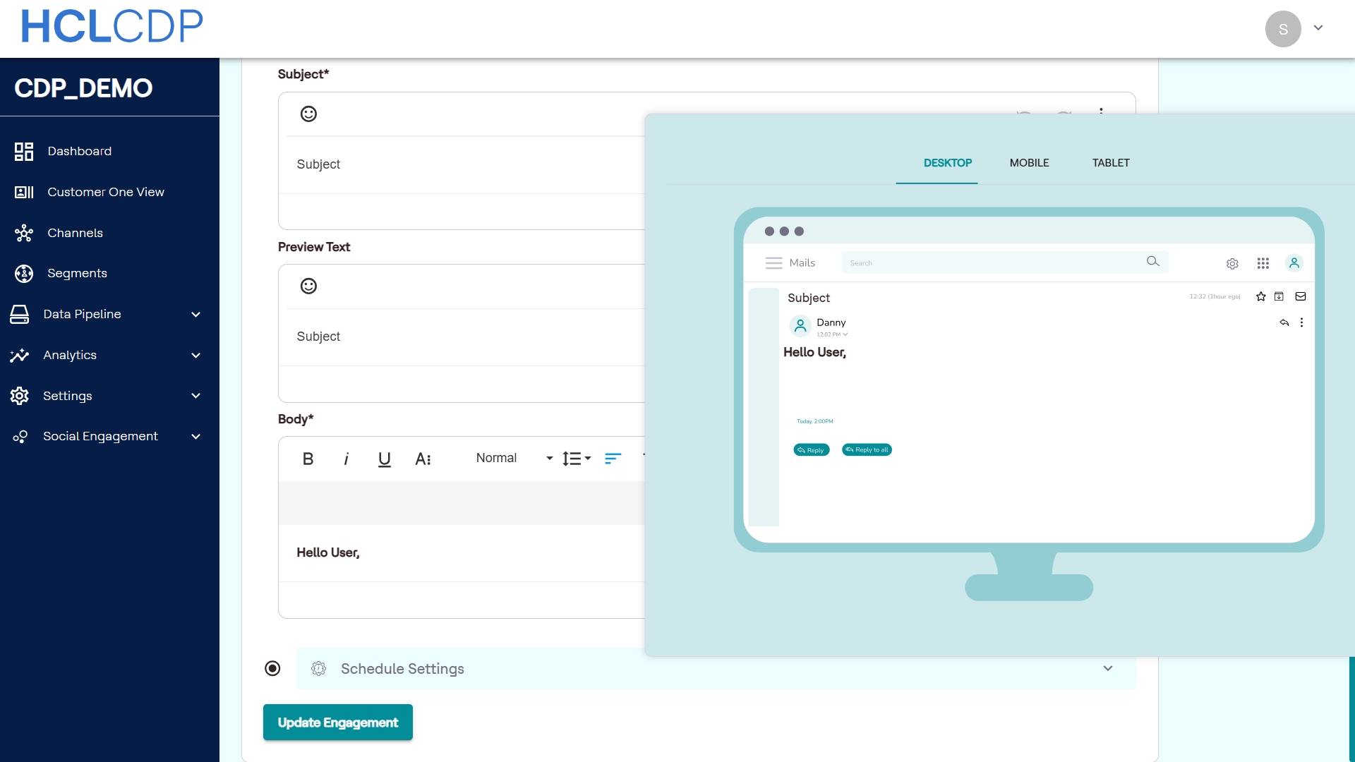

Configure Template
  • Subject (Mandatory):Enter a subject line that clearly explains the email's purpose. Emojis can be added to make it more engaging.
  • Preview Text: Provide a brief preview of the email content. Emojis are supported here as well.
  • Body (Mandatory): Create a basic template with options to customize the content. You can add links, images, emojis, and special characters, as well as modify the font style and text alignment. The template supports image uploads in JPEG, JPG, PNG, GIF, and WEBP formats.
You can't create highly customized templates directly in this editor, but you can use tools like Mailchimp or Mailjet to design HTML templates. Copy the HTML code into the code view section and customize it further by adding macros for personalization. For more information about macros, refer here.
Template Preview
You can preview your email templates by hovering over Show Preview to see how the email will appear on different devices. The preview updates in real-time, and you can switch between Desktop, Mobile, and Tablet views.
Note: If you make changes in the template's code view, click the code view icon again to save the updates.
Tip: You can undo and redo changes to each sub-section. To view it in full screen, click the three dots of each sub-section, select the information or view the code.
