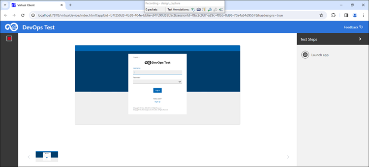

The Virtual Client window opens with a configured design in the default browser.
Click the UI controls and perform user actions on the design to record test
steps.
The actions are listed in the Test Steps panel on the right side.
- Optional: Click the next image in the bottom navigation pane to record user actions if the application has multiple screens.
Stop the recorder by clicking the Stop icon
in the left pane of the
Virtual Client window after you complete all actions.
The Test Generation dialog is displayed with a confirmation of test generation from the recording. - Click Open Test to view the test steps or Close to close the Test Generation dialog.
