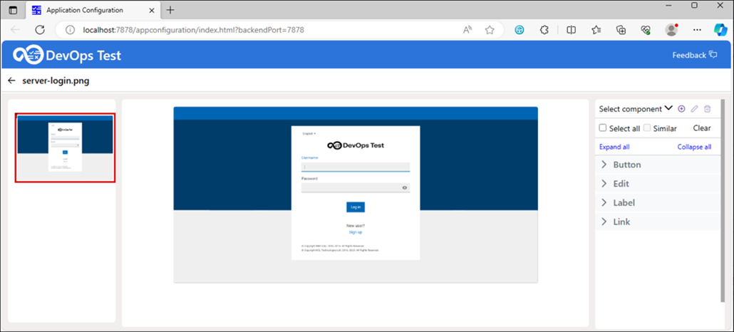

Click Add.
The design images are uploaded and the identified controls on the pages are displayed.
You have added the web application design and it is listed on the Application Configuration page.

- Review the controls identified on the designs and edit them as required by clicking
the Design editor icon
