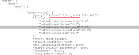

While searching, the Query service identifies all hyphenated keywords and performs its search on the natural.noun.* + query fields available in the current search profile. In the case of hyphenated keywords, the Query service breaks the keyword by splitting it at the hyphen and then generates the Elasticsearch query using the separated terms without the hyphen, as illustrated below.

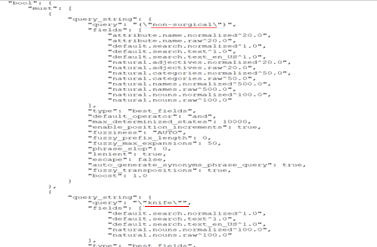

The Query service no longer needs to remove the hyphen. It can generate an Elasticsearch query with the hyphen as shown below. There is a separate definition block for hyphenated keyword and those keywords will be searched against all the natural fields and query fields from the search profile.
