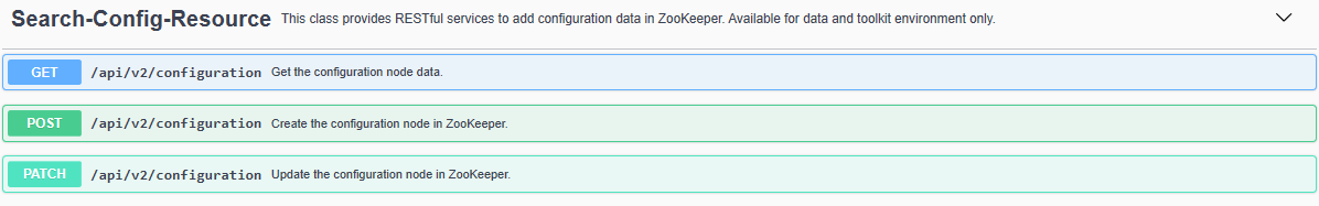

You interact with the Stop Words dictionary using REST calls. The permitted calls are GET, POST, and PATCH. For example, in the case of a GET call, the response body contains a json-formatted set of the terms you are calling. There is no explicit DELETE call; however, you can simply do a POST with empty content to delete an item.
The address for this query is:
http://data_environment_hostname:30920/search/resources/api/v2/configuration?nodeName=environmentType_storeID_product_stopwords&locale=en_US

You can also update synonyms and replacement terms using the query service configuration REST API. The permitted calls are GET, POST, and PATCH. For example, in the case of a GET call, the response body contains a json-formatted set of the terms you are calling. There is no explicit DELETE call; however, you can simply do a POST with empty content to delete an item.
http://data_environment_hostname:30920/search/resources/api/v2/configuration?nodeName=environmentType_storeID_product_sta&locale=en_US
