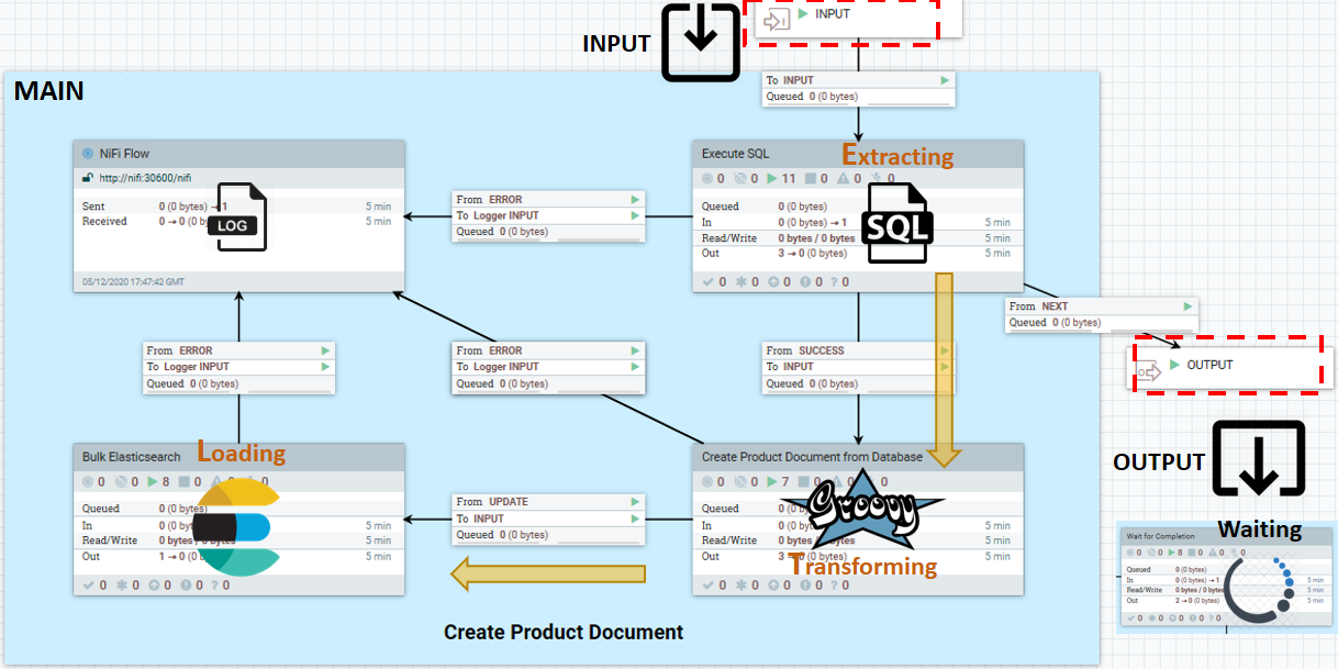

A pipe is a NiFi process group that contains a NiFi input port, a flow made up of a series of NiFi processors, and an output port. Input and output ports can only receive and send, but the NiFi processors they report to can also read and write to the search index, or other persistent data repositories. The process group is stored in a NiFi registry, which is version-managed.
A NiFi pipeline is made up of the total set of NiFi pipes responsible for bringing in a particular type of data. Each default connector pipe uses a boiler-plate template that contains the following ETL (Extraction, Transformation, and Loading ) data ingestion pattern:
INPUT
The port that listens for signals from prior processor successes. Only send trigger signals through this and the output port. Business data should be read in, processed, and written to external data repositories from inside the pipe. This policy prevents dependencies between the pipes.
MAIN
ETL processing logic. SQL extraction and transformation is typically performed using Java. The Groovy ETL is only supported in development environments. The main component can be anything, however, including
  • Read from an external data store
  • Process each data entry being read in
  • Send one or more processed data document to Elasticsearch
  • Wait until entire source data set has been exhausted
OUTPUT
Output port used to send a trigger signaling success to downstream pipes.
WaitLink connects one pipe to another pipe or pipeline. It pauses the dataflow until the completion (success, partially successful, or failed) ofthe current stage.
