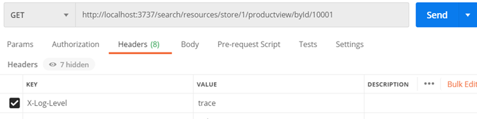

By default, the logs in the Query service are generated at the ERROR log level. You can now switch to any log level for a particular request by adding the header, X-Log-Level = <log-level>.
Note: The Possible <log-level> are, TRACE, DEBUG, INFO, WARN, ERROR.

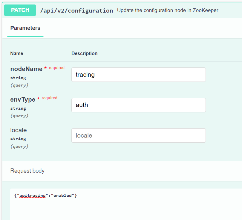

Use the Query REST API Swagger interface to access the following Query service endpoint. This endpoint enables API level tracing for the Query service.
Ensure that you include the mandatory envType parameter and {"apitracing":"enabled"} in the message body.
You can also use the following Curl command to enable API level tracing for the Query service:
"https://query_host:query_port/search/resources/api/v2/configuration?nodeName=tracing&envType=auth" -H "accept: application/json" -H "Content-Type: application/json" -d "{\"apitracing\":\"enabled\"}"

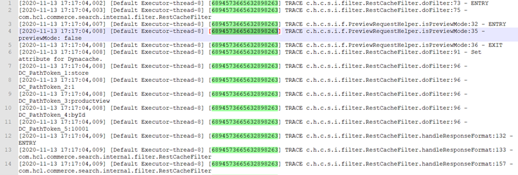

Submit a query request with the header X-Log-Level=trace using an API client such as Postman. Log statements in the trace.log having the traceIdunique to the specific request will resemble the following.
Important: This traceId is generated for all requests regardless of whether the header X-Log-Level is provided in the request or not.

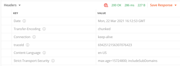

The response has a header as traceId which carries the traceIdback to the caller.
