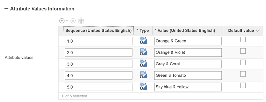

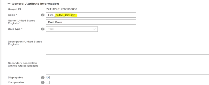

To enable dual color search in the storefront, create a new attribute in the Lab. The attribute code must end with dual_color. Such attributes can be created as assigned or pre-defined value attributes. When you add a value to this attribute, the attribute value must not contain more than two colors.
Separate the attribute color values using an & operator.

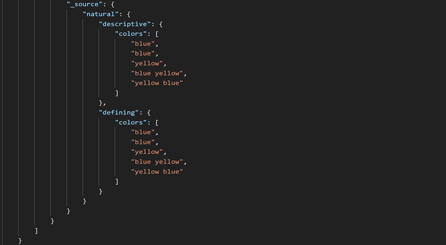

In the product index, natural.descriptive.colors, and natural.defining.colors field color details will be added. In the natural field color family name will be added for each color after splitting by &.
