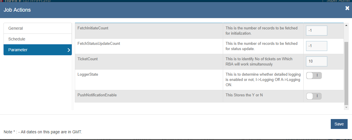

Steps to resolve Ensure that below configurations are complete for the RBA component.

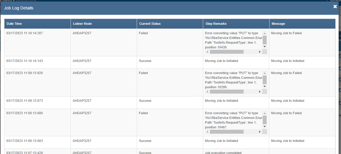

Error while setting value to 'RequestDetails' on 'Hcl.RbaService.Entities.Common.ToolInfo”
| Issue Description | Error while setting value to 'RequestDetails' on 'Hcl.RbaService.Entities.Common.ToolInfo” appears |
| Modules Impacted | RBA |
Steps to resolve Ensure that Runbook Tool URL/IP address and USERID/ Password are correct. User id Should be without Domain Address. |

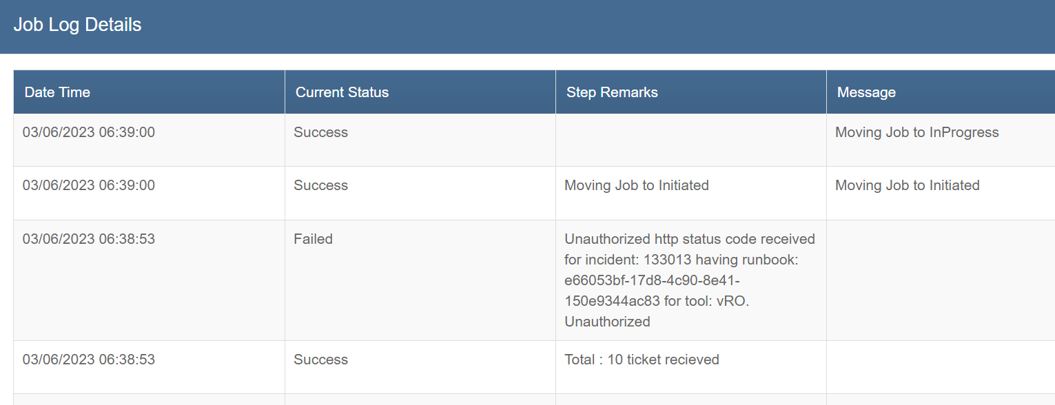

Unauthorized HTTP Status Code
Table 60 - RBA: Scenario 8
| Issue Description | Error in RBA URL due to unauthorized credentials |
| Module Impacted | RBA, irecommend, iparsing |
| Probable root cause |
Invalid credentials.
Figure 100 – Unauthorized http status code |
| Steps to resolve |
1. Fetch the RBA details. 2. Check for the authentication credentials of RBA 3. Look for the username and password whether it is provided correctly. |

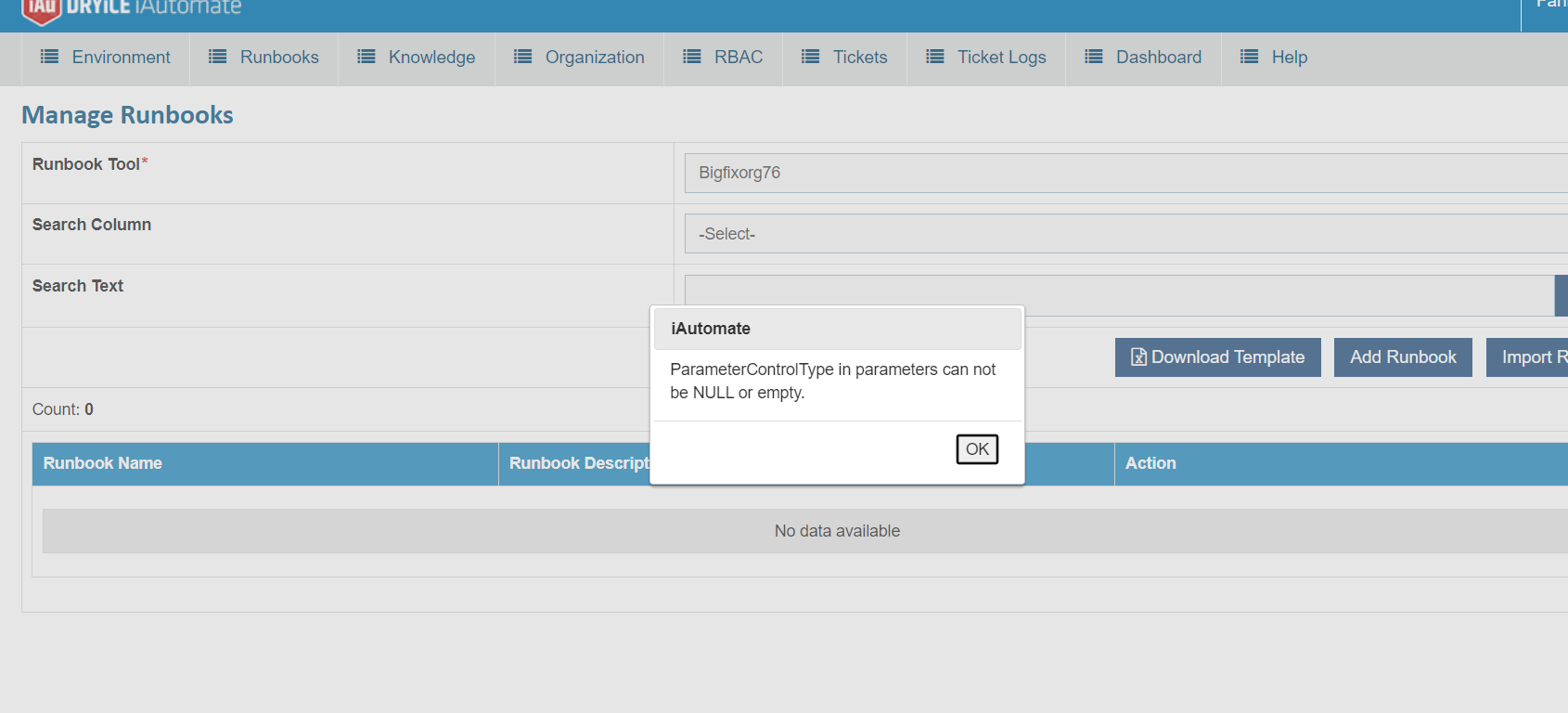

Presence of Null Value in Runbook
Table 61 - RBA: Scenario 9
| Issue description | Presence of null or empty values in the parameters while we import runbook file to console |
| Modules Impacted | RBA, Manage runbook |
Null values in the parameters
Figure 101 – Error for null value in parameter |
| Steps to resolve |
Invalid Rest API Method Used
Table 62 - RBA: Scenario 10
| Issue Description | Invalid method is used in manage runbook tool. |
Invalid REST API Method provided
Figure 102 – Error for invalid method used in runbook tool |
| Steps to resolve |

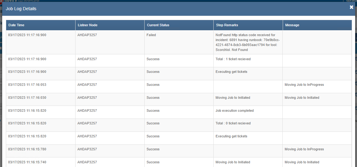

Failed to Execute Job
Table 63 - RBA: Scenario 11
| Issue description | Failed to find the http status code for incident by using wrong Runbook API URL. |
Invalid Runbook API URL
Figure 103 – Not Found http status code for invalid API URL |
| Steps to resolve |

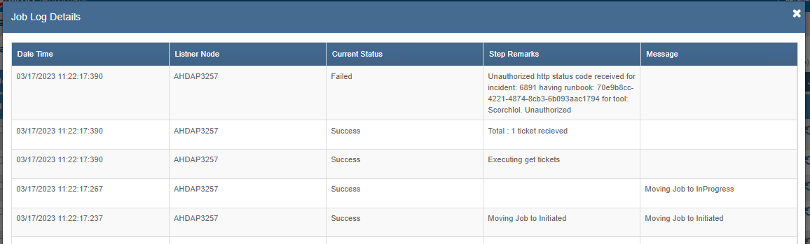

Incorrect Status Code
Table 64 - RBA: Scenario 12
| Issue description | Incorrect status code due to unauthorized credentials in Runbook Tool integration. |
Invalid credentials in Runbook Tool integration.
Figure 104 – Unauthorized status code for Runbook tool |
| Steps to resolve | Check the runbook tool username and password configured for Runbook Tool. |
