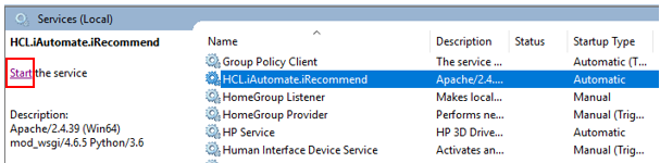

HCL.iAutomate.iRecommend service is not starting
| Issue Description | HCL.iAutomate.iRecommend service is not starting |
| Modules Impacted | iRecommend |
| Probable Root Cause | Invalid “iRecommend.conf” file content |
Steps to resolve
<VirtualHost *> WSGIScriptAlias /iRecommend C:/iAutomate/Middleware/iRecommend/main.wsgi SSLVerifyClient require SSLVerifyDepth 10 <Directory C:/iAutomate/Middleware/iRecommend> WSGIApplicationGroup %{GLOBAL} Require all granted </Directory> </VirtualHost>
sc config HCL.iAutomate.iRecommend obj= “ID” password= “PSWD” where ID is the [Domain\SA ID] and PSWD is the [Password of SA] and SA is [Service Account]. ‘Log On As’ field corresponding to the service HCL.iAutomate.iRecommend should be changed to ‘Service Account’. Click Start to start the service. |

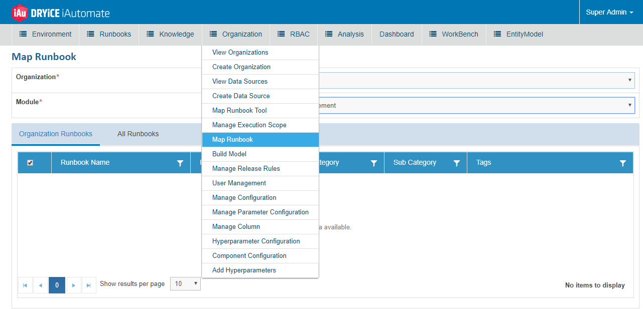

‘Model Not Found’/‘Model is empty’
| Issue Description | Error message ‘Model Not Found’ or ‘Model is empty’ are logged. |
| Probable Root Cause | Runbooks are not mapped |
Steps to resolve

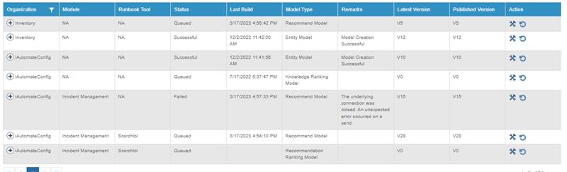

Failed to Build Model
Table 85 – iRecommend: Scenario 7
| Issue description | Failed to build model due to incorrect URL of the server running IRecommend service. |
| Modules Impacted | IRecommend |
| Probable root cause |
Incorrect URL provided for the server running IRecommend service.
Figure 133 - Failed to build model |
| Steps to resolve |
1. Go to Product -> Product configuration -> Check the load balancer URL 2. Check whether the connection is successful |

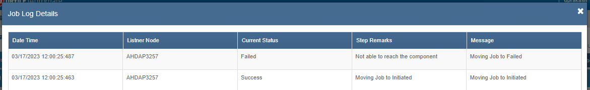

Failed to Recommend Jobs
Table 86 – iRecommend: Scenario 8
| Issue description | Failed to recommend jobs after setting configuration |
| Module impacted | IRecommend |
Figure 134 - Failed to recommend jobs |
| Steps to resolve |
