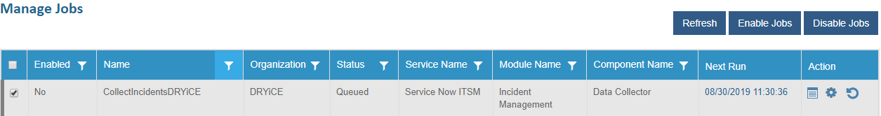

Steps to resolve

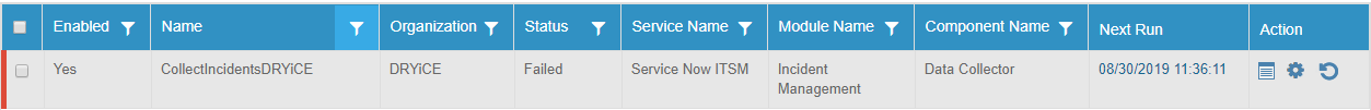

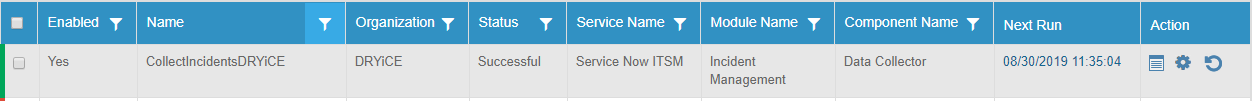

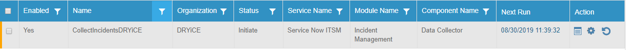

  1. Under Manage Jobs screen, select CollectIncidents job and enable it by clicking on Enable Jobs button.
Figure 2. Figure 62 - Data Collector (cont.)
  1. The status of the job should change to Successful.
Figure 3. Figure 63 - Data Collector (cont.)

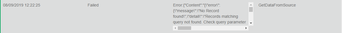

Error message “No Records Found” appears on the Manage jobs Job Log screen for Data Collector job.
Figure 4. Figure 64 - Error message “No Records Found”
Modules Impacted Data collector, Recommendation, iParse, Generic, RBA, Release
Probable Root Cause ‘CollectIncidents’ job is enabled but status of job is Failed
Steps to resolve
  1. Open the log of the job CollectIncidents.
  1. If the message in logfile reads ‘No Record Found’, it doesn’t imply an error. It could be due to the fact that there is no ticket data available. Once the data is available, data collector will fetch the data and ticket will start appearing on screen.

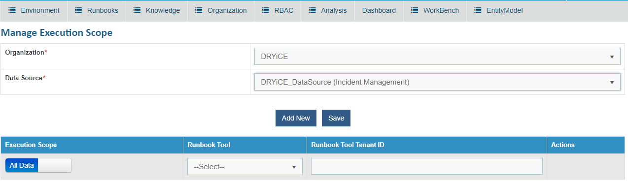

Execution Scope is not mapped

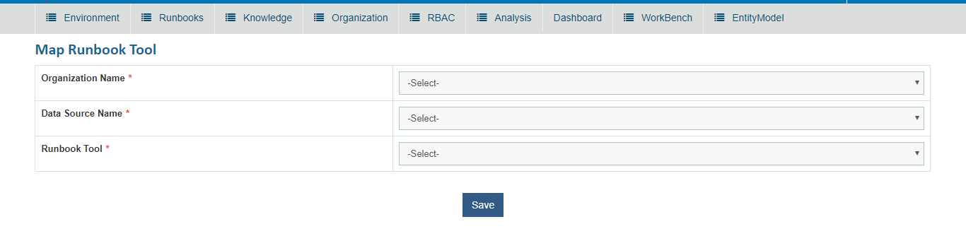

  1. To map execution scope, it is a pre-requisite that organization should be mapped with a runbook tool. To check this, go to Organization Map Runbook Tool and map the runbook tool, if not already mapped.
Figure 6. Figure 66 - Ticket Data not appearing on screen (cont.)

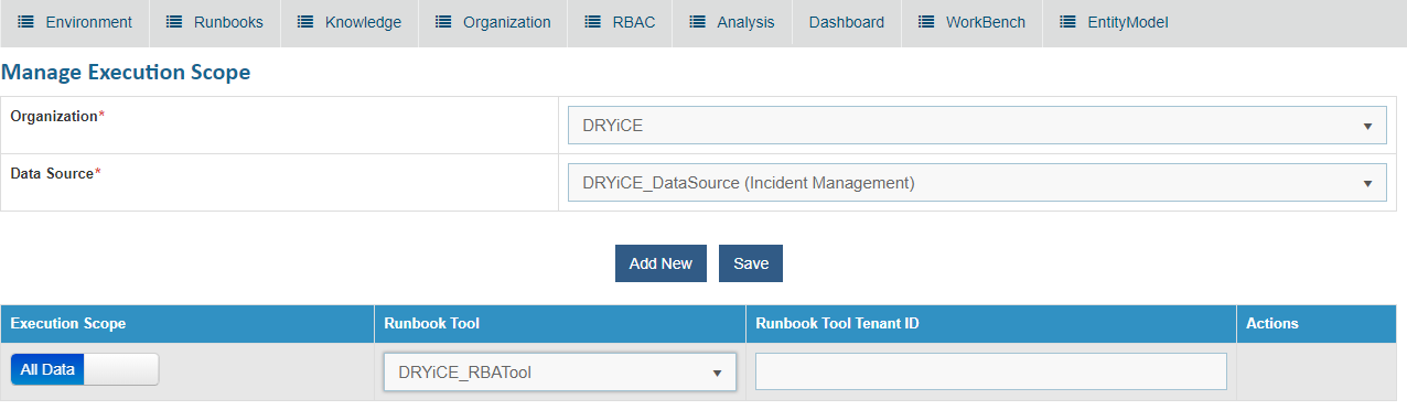

  1. Once the Runbook Tool is mapped with the organization and its data source, go to Organization Manage Execution Scope.
  2. See if any execution scope is mapped with the pair of organization and data source corresponding to a mapped runbook tool. If not, then map it.
  3. Select the runbook tool mapped with the organization and provide Runbook Tool Tenant ID (Optional) and click Save.
Figure 7. Figure 67 - Ticket Data not appearing on screen (cont.)
  1. Now check the availability of tickets on screen.

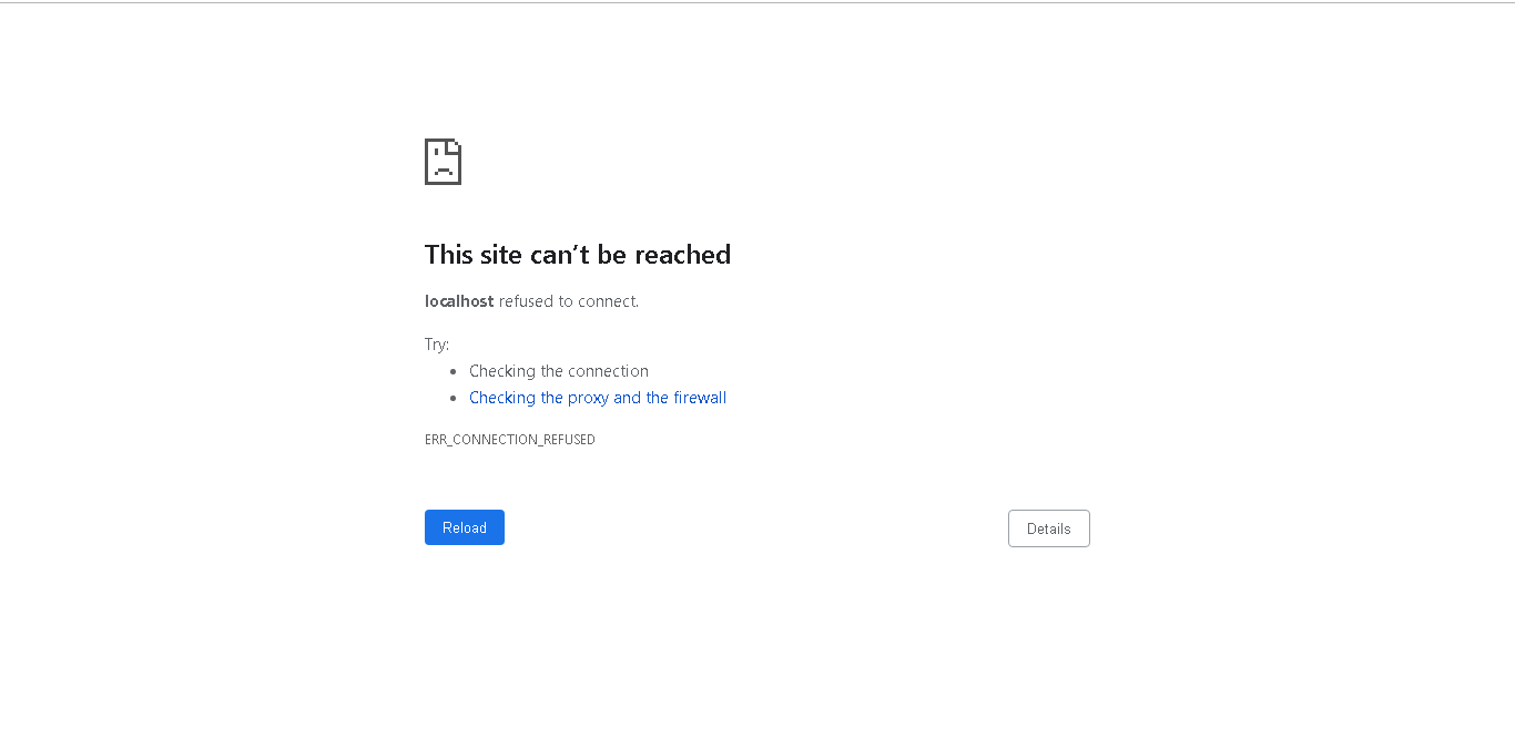

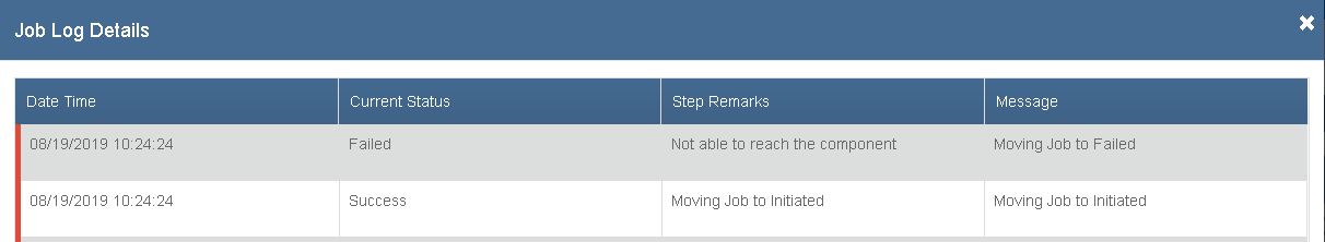

‘Not able to reach the component’
Table 4. Table 38 - Data Collector: Scenario 4
Issue Description Error message ‘Not able to reach the component’ appears
Probable Root Cause
‘CollectIncidents’ job is enabled, and status of job is Failed – Issue with Data Collector Service
Figure 8. Figure 68 - Error message ‘Not able to reach the component’
Figure 9. Figure 69 - Error message ‘Not able to reach the component’ (cont.)
Steps to resolve

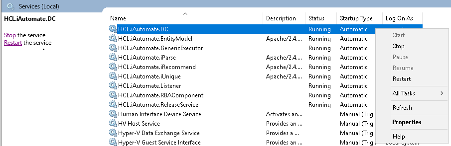

Open the job log for CollectIncidents job. If the job log reads ‘Not able to reach the component’, check the status of Data Collector service by performing the following steps:
  1. Press Win+R and type services.msc.
Figure 10. Figure 70 - Error message ‘Not able to reach the component’ (cont.)
  1. Click OK to open the Windows Services.
Figure 11. Figure 71 - Error message ‘Not able to reach the component’ (cont.)

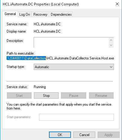

  1. Search for HCL.iAutomate.DC.
  2. Right-click HCL.iAutomate.DC service and click on Properties.
Figure 12. Figure 72 - Error message ‘Not able to reach the component’ (cont.)
  1. Copy the value mentioned in Path to executable as shown in the image below.
Figure 13. Figure 73 - Error message ‘Not able to reach the component’ (cont.)
  1. Open File Explorer, then paste the copied path and press Enter to open the desired folder.
  2. Search for HCL.iAutomate.DataCollector.Service.Host.exe config file and open it in Notepad.
Figure 14. Figure 74 - Error message ‘Not able to reach the component’ (cont.)

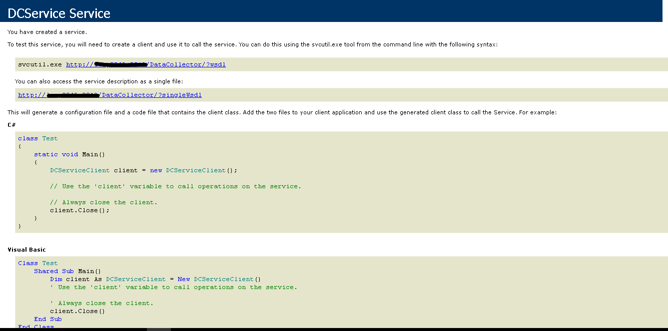

  1. Search for key ServiceHostURL. The value corresponding to this key is the heartbeat URL. Copy it and paste it in browser. If the following page appears, it implies that either the service is not running or there is an issue with datacollector.
Figure 15. Figure 75 - Error message ‘Not able to reach the component’ (cont.)
  1. If the following WSDL loads successfully, it implies that the service is running fine.
Figure 16. Figure 76 - Error message ‘Not able to reach the component’ (cont.)

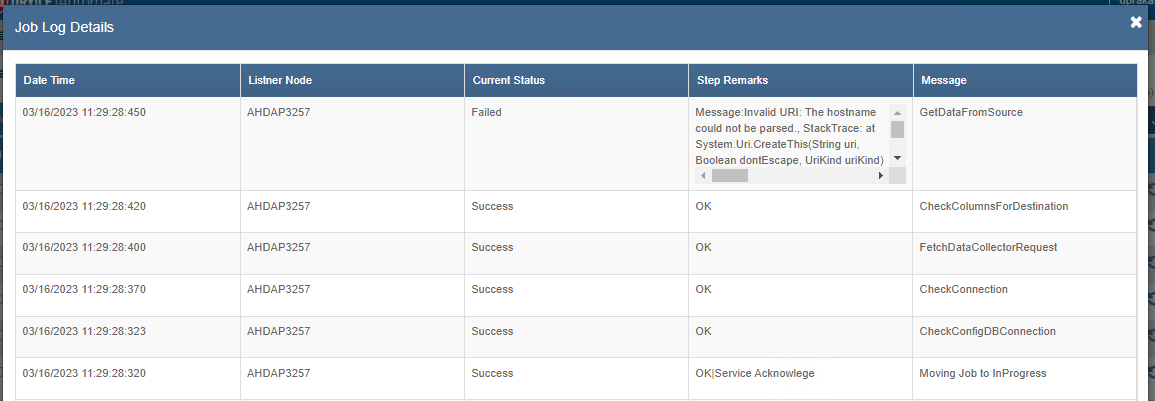

The job status is Failed due to Authorization issue

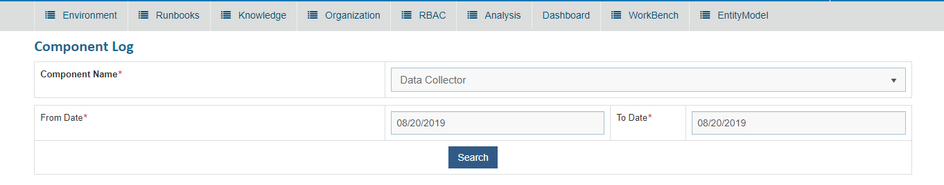

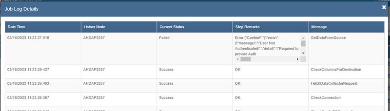

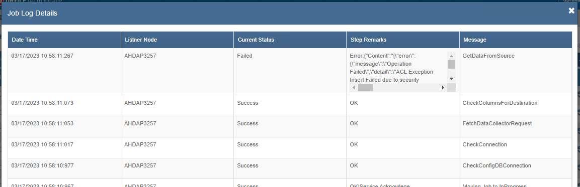

  1. Go to Environment Component Log.
  2. Check the logs corresponding to the component name ‘Data Collector’ for the particular time interval when the job is not running.

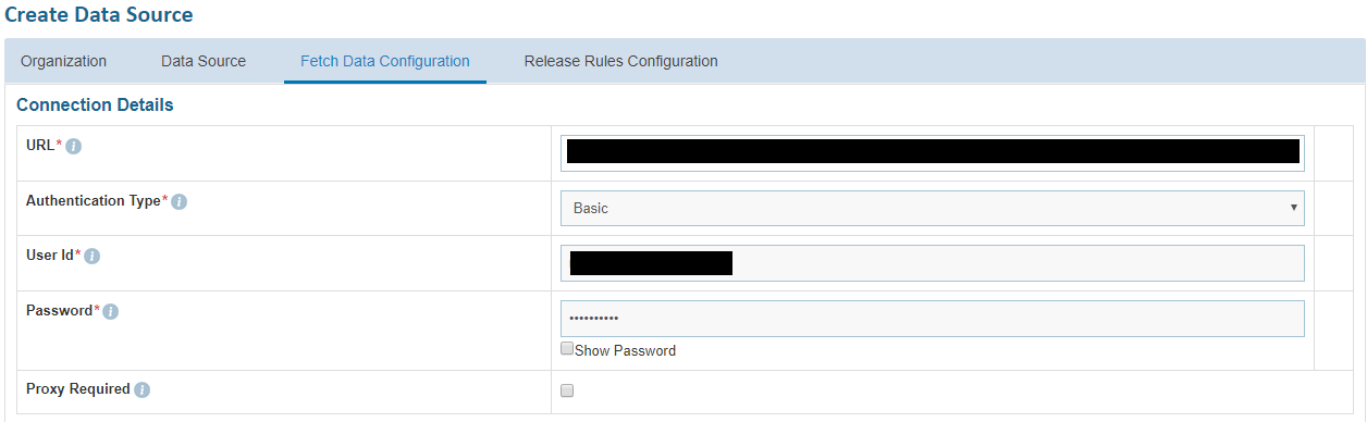

Figure 17. Figure 77 – Error in Data Source creation
  1. If the log reads, ‘Unauthorized’, it implies that there is some issue with the created data source.

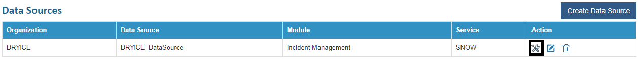

  2. Check the data source has been created by going to Organization View Data Sources.
  3. Click Edit and ensure that the provided credentials/details in ‘Fetch Data Configuration’ tab are correct.

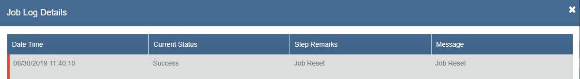

The status of job is stuck at INITIATE/FAILED
Table 6. Table 40 - Data Collector: Scenario 6
Issue Description ‘CollectIncidents’ job is enabled, the data collector service is running fine, but status of job is stuck at INITIATE/FAILED (in case of reset)
Probable Root Cause
Issue with Listener as it is not able to hit Data Collector.
Figure 19. Figure 79 - Status of job is stuck at INITIATE/FAILED
Figure 20. Figure 80 - Status of job is stuck at INITIATE/FAILED
Steps to resolve
If the status of the job CollectIncidents remains Initiate for a long time, it implies that Listener is not picking up the job.
Also, if user resets the job, and status of the job remains ‘Failed’ for a long time and the log of the job reads ‘Job Reset’ then also it implies that Listener is not picking up the job.
Refer to Troubleshooting Steps for Listener for more information.

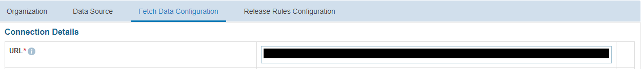

  1. Check if the ticket is present in iIncident table in the corresponding organization database.
Query - select * from iIncident.
  1. If the query does not return any data, it implies that URL that is entered for fetching data while creating data source is wrongly formed.
  2. Correct it and try again.

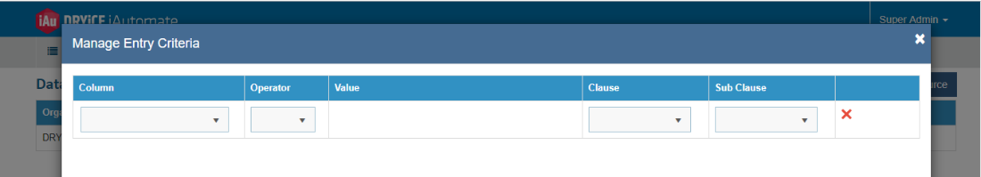

  1. If the ticket is present in table ‘iIncident’ but not in table ‘iIncidetActionable’ (select * from iIncidetActionable), then also tickets won’t appear on screen. For tickets to appear in iIncidentActionable table, ensure that Entry criteria has been properly defined because only those tickets will be available in iIncidentActionable table which satisfies the defined Entry criteria.
  2. To check for Entry criteria, go to Organization View Data Sources Manage Entry Criteria and ensure the correct criteria are defined.
Figure 22. Figure 82 - Status of job is Failed (cont.)
  1. Only those tickets will appear on the screen which satisfy the defined criteria.

Issue description Failed to fetch data from the URL and Job is stuck while fetching the details from the source.
Probable Root Cause
Space present in the URL configured as source.
C:\Users\ananya.s\AppData\Local\Microsoft\Windows\INetCache\Content.MSO\5B93D5DD.tmp
Figure 86 – Error if space present in URL configured as source
Steps to resolve
  1. Recheck the URL
  2. Remove unwanted spaces and special characters from the URL configured as source.
