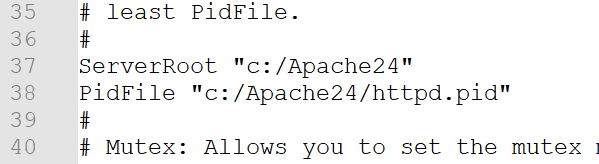

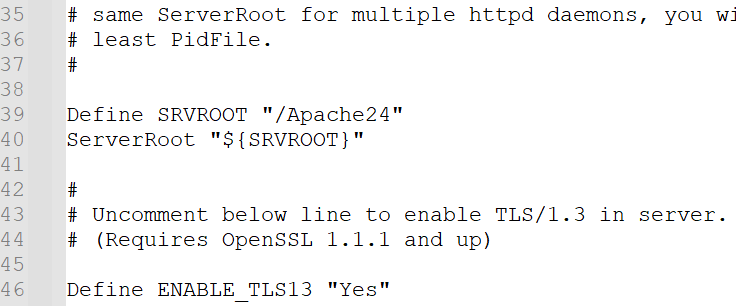

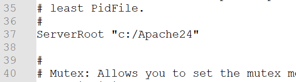

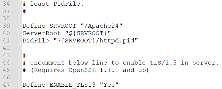

Steps to resolve Apache-related issue where Python services are not starting due to file lock on the logs folder by monitoring software. Stop all Apache services, open each Python component's .conf file, add the appropriate PidFile line, and start the services again.
