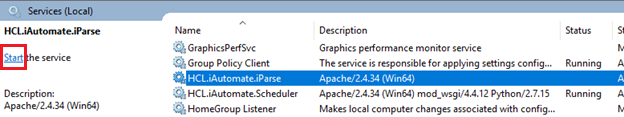

Steps to resolve
  1. Press Win+R, type services.msc and press Enter to open Windows Services.
Figure 2. Figure 136 - HCL.iAutomate.iParse
  1. Find service HCL.iAutomate.iParse and select it.
  2. Click Start to start the service, if it’s not running already.
Figure 3. Figure 137 - HCL.iAutomate.iParse (cont.)

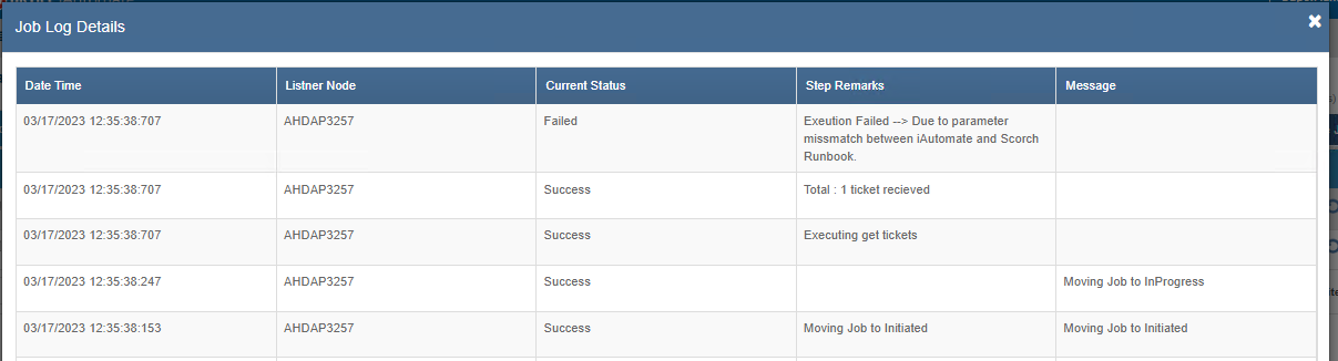

Failed to Execute Job
Table 91- iParse: Scenario 5
Issue Description Failed job execution due to parameter mismatch between Product and RBA tool
Modules Impacted ExecuteRunbook Job
Probable root cause
Parameter mismatch between Product and RBA Tool
C:\Users\ananya.s\AppData\Local\Microsoft\Windows\INetCache\Content.MSO\D7B3B950.tmp
Figure 138 – Error for parameter mismatch
Steps to resolve
  1. Check with the parameter names with the RBA Team.
  2. Parameter names should be same as in RBA runbook.
