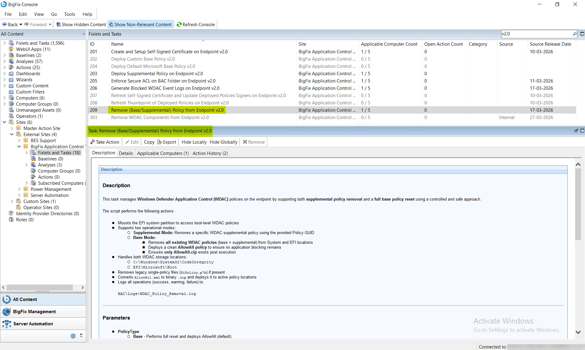

Figure 1. Task: Remove (Base/Supplemental) Policy from Endpoint
Remove (Base/Supplemental) Policy from Endpoint v2.0
  1. In the BigFix Console, navigate to All Content > BigFix Application Control > Fixlets and Tasks.
  2. From the Fixlets and Tasks pane, select Task: Remove (Base/Supplemental) Policy from Endpoint v2.0.

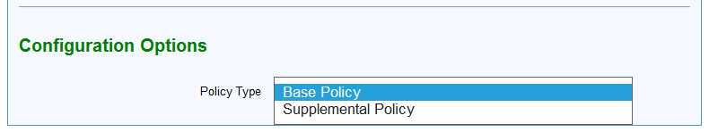

  3. From the Task: Remove (Base/Supplemental) Policy from Endpoint v2.0 pane, under Configuration Options, enter the following information:
    Table 2. Task: Remove (Base/Supplemental) Policy from Endpoint v2.0 Configuration Options
    Field Name Options Description
    Policy Type Base Performs full reset and deploys AllowAll (default).
    Supplemental Removes only a specific supplemental policy.
    PolicyId Required only when the policy type is Supplemental. Specifies the GUID of the policy to be removed.
