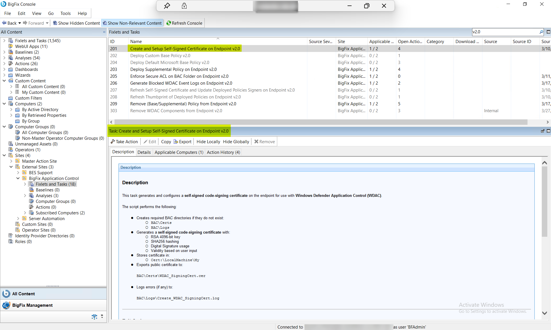

  1. In the BigFix Console, navigate to All Content > BigFix Application Control > Fixlets and Tasks.
  2. From the Fixlets and Tasks pane, select Task: Setup and Create Self-Signed Certificate on Endpoint v2.0.

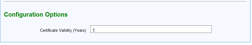

  3. From the Task: Setup and Create Self-Signed Certificate on Endpoint v2.0 pane, under Configuration Options, enter the following information:
    Table 2. Task: Setup and Create Self-Signed Certificate on Endpoint v2.0 Configuration Options
    Field Name Description
    Certificate Validity (Years) Number of years for which the newly generated certificate will be valid.
