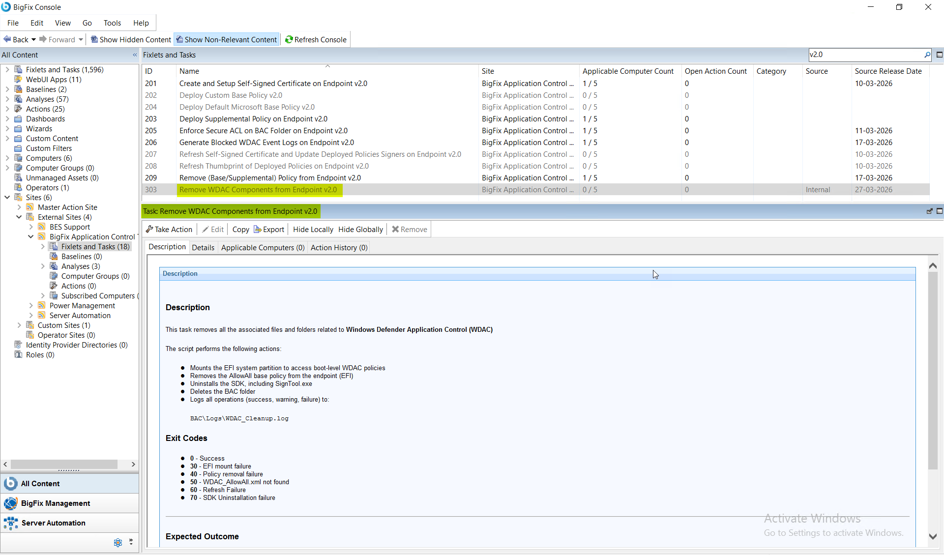

Figure 1. Task: Remove WDAC Components from Endpoint
Remove WDAC Components from Endpoint v2.0
  1. In the BigFix Console, navigate to All Content > BigFix Application Control > Fixlets and Tasks.
  2. From the Fixlets and Tasks pane, select Task: Remove WDAC Components from Endpoint v2.0.
  3. From the Task: Remove WDAC Components from Endpoint v2.0 pane, click the Applicable Computers(n) tab and view the endpoints on which you want to run the task.
  4. Select the Take Actions tab and select the endpoints on which you want to apply this installer task.
  5. Click OK.
A successful execution of this task results in the following outcomes:
  • Removes all the associated Application Control files and folders from the endpoint.
  • A system reboot is required for the changes to take effect.
