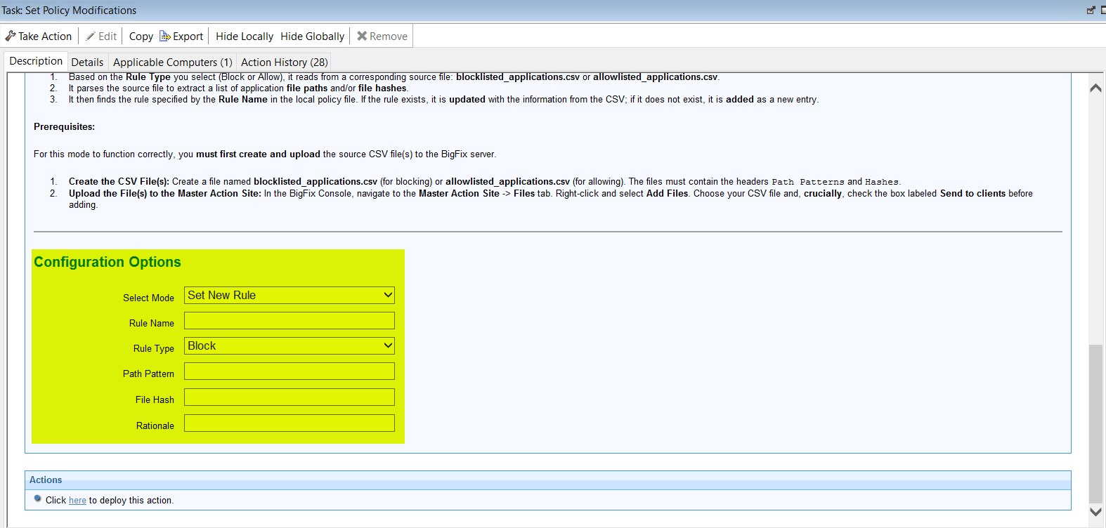

  1. From the Task: Set Policy Modifications pane, enter the following information on the Description tab:
    Figure 1. Set New Rules
    Table 1. Task: Set Policy Modifications: Set New Rules Mode Configuration Options
    Field Name Description
    Select Mode Select the mode: Set New Rule.
    Rule Name Name of the rule.
    Rule Type Type of the rule. Can be either Block or Allow.
    Path Pattern Path of the application or process to be allowed or blocked.
    File Hash Hash value of the application file.
    Rationale Description or reasoning of the rule.
