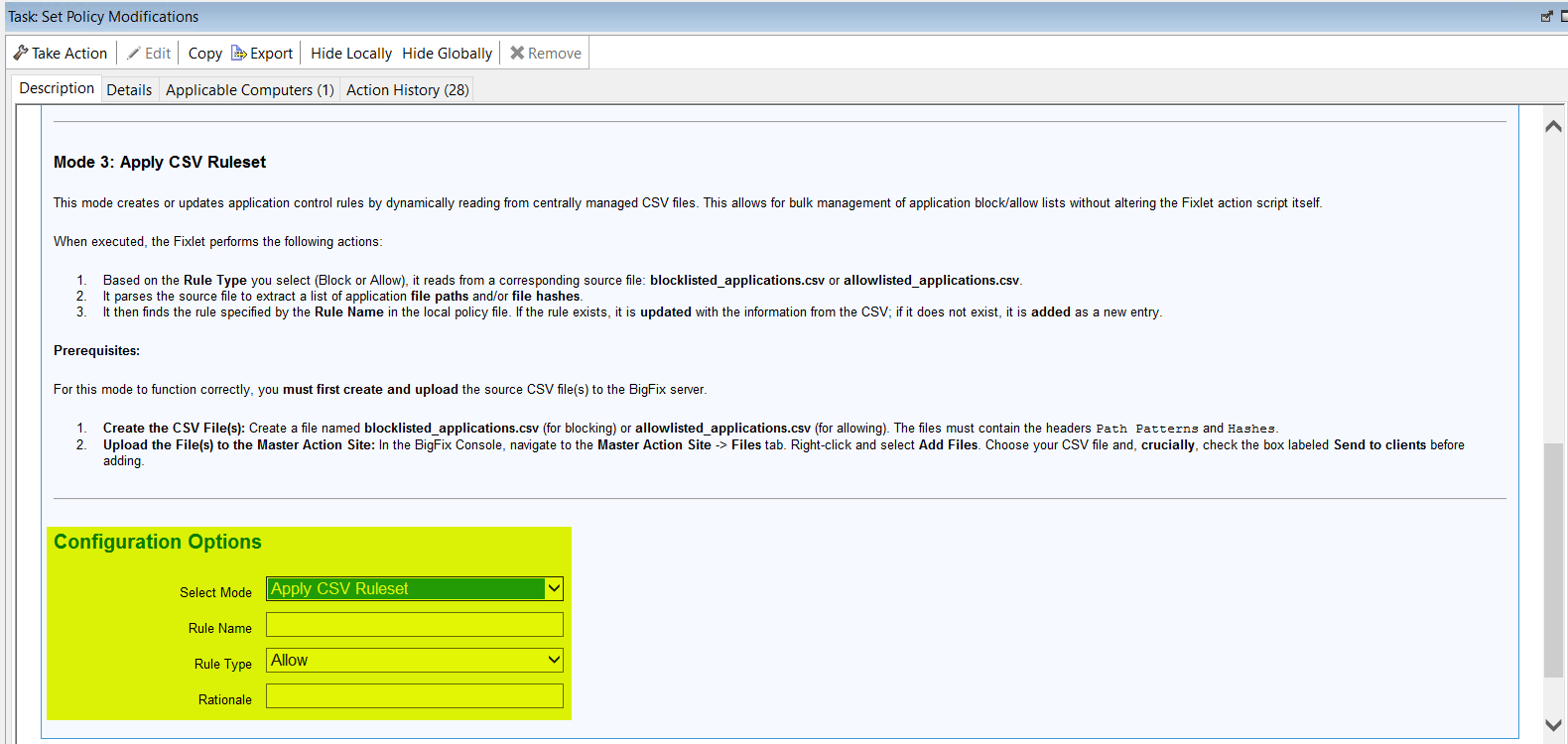

Perform the following steps to apply CSV rulesets to an endpoint:
  1. From the Task: Set Policy Modifications pane, enter the following information on the Description tab:
    Figure 1. Apply CSV Ruleset
    Table 1. Task: Set Policy Modifications Apply CSV Ruleset Mode Configuration Options
    Field Name Description
    Select Mode Select the mode: Apply CSV Ruleset.
    Rule Name Name of the rule.
    Rule Type Type of the rule. Can be either Block or Allow.
    Rationale Description or reasoning of the rule.
