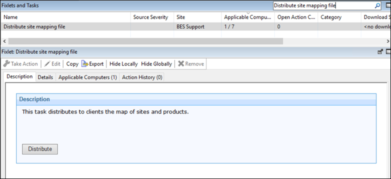

Distribute site mapping file fixlet is used to update the licensed products and their related sites on the client. It is mandatory to run Distribute site mapping fixlet before using Generate BigFix license tags fixlet. For more details, refer to Distributing the site mapping file.
Using the fixlet
To use the fixlet, perform the below steps:

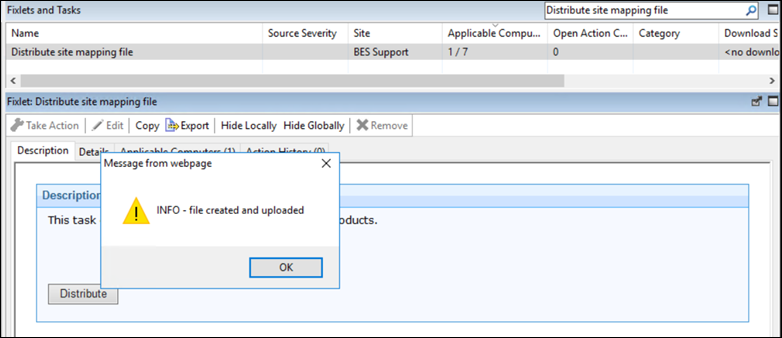

- Select the fixlet at
Click on Distribute. Once the action is complete, a message INFO: file created and uploaded appears.
