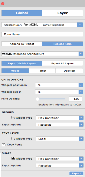

From the VoltMX Iris plugin, click Global. The plugin looks like this.

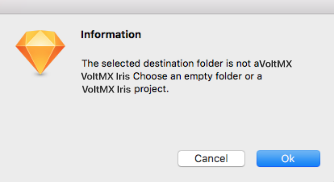

Specify the name of your exported project by setting its path. The folder you create or select becomes the exported project's VoltMX Iris project name. To set the path, click the ellipsis button (…) of the Project Name text box, and then navigate to the path where you want to save the exported project to, creating a new folder, if necessary.
When you have finished, click OK .Note: You must set the export destination of the Sketch project to a Volt MX Iris project folder or to an empty folder. You cannot export a Sketch project to a non-empty folder.

- Select whether you want to export as Free Form or Volt MX Reference Arch project. If an existing project is selected, then this will get auto populated.
- Select whether you want to export only the visible layers (as set on the Sketch), or export all layers regardless of whether they're visible or not.
- Indicate the type of channel that you want to export the project to by selecting either Mobile , Tablet, or Desktop . The default value is Mobile .
Set the units options for the size and position of elements. You can select from the following:
- Px. Uses pixels as the unit for the dimensions and positioning of project elements for VoltMX Iris. Pixels are a fixed, physical unit and do not scale proportionately depending on the resolution of a devices screen. The rendering of an app on a low-resolution device will appear larger and more pixelated than it would on a higher-resolution device.
- Dp. Uses density-independent pixels, which is based upon the physical density of a device's screen. This allows the dimensions of the elements of your design to scale in size depending upon the screen resolution of your target device. Because the Dp unit is relative to a 160 dpi (dots per inch) screen, one dp is equal to one pixel on a 160 dpi screen. The ratio of dp to pixels varies with the screen density of the device. To accommodate this, you can set the dp-to-pixel ratio in the VoltMX Iris plugin, which is described in the next step.
- %. Sizes the various elements of the project as a percentage of the parent container of the project. The horizontal value and vertical value of the parent container are designated as 100% for their respective dimensions.
Set the ratio between pixels (Px) and density-independent pixels (Dp). This ratio is used only if you are using Dp as your unit of choice for element sizes or positioning. This ratio varies from device to device, depending on the physical density of pixels on the device's screen. Increasing the value of the ratio increases the number of pixels that equal one Dp. For instance, a value of 2.25 indicates that 2.25 pixels equals 1 Dp. To determine the ratio that you should use for your device, use the following formula:
Px = DP*(The device's dpi/160) - Set the kind of widget you want the Sketch layers to be converted to on a default basis for Layer Groups, Text layers, and all other layers (i.e. Shape layers). To simplify the conversion process from a Sketch project to a VoltMX Iris project, you can globally determine the default type of widget that a given type of layer gets converted to. However, if you want to override the global value for a specific layer, you can do so (as described in step 13). The VoltMX Iris plugin categorizes the layers available in Sketch into three types of layers: Layer Groups, Text layers, and all other layers (i.e. Shape layers). The following table illustrates the global values that you can set for each of these three types of layers.

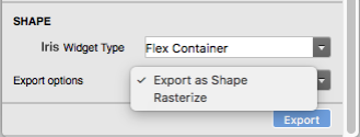

| Shape Layer. Defined as any layer other than a Layer Group or Text Layer. An Shape layer may consist of rasterized pixels. | Image (default)Flex ContainerFlex Scroll Container Button |
Select the global export option for Group and Shape layers. Depending on the VoltMX Iris widget type that you selected for Shape layers, you can have such elements converted in either of the following two ways:
- Export as Shape. The Shape layers are exported as the widget type selected in the Iris Widget Type drop-down list, and the layer styles are converted to the equivalent styles supported under VoltMX Iris skin properties. This option is not available if the Iris Widget Type you select is Image.
- Rasterize. The layer is rasterized (flattened to pixels) and cropped, and saved as a .png file. If the Iris Widget Type you select is either a Flex Container, a Scroll Flex Container, or a Button, the resulting converted widget uses the generated .png file as an image background in VoltMX Iris. And corresponding SVG files are also generated in resources/svg folder in Volt MX Iris project. Which developer can use to get platform specific vector drawable.

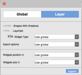

Set export options for individual layers. For any of the layers you're exporting, you can override some of the global export options. This is especially helpful if, for example, you want to convert a particular layer into a Flex Scroll Container instead of a Flex Container, or to size a given layer as a percentage of the parent container rather than using whatever unit you selected as your global export option.
To set export options for individual layers, at the top of the VoltMX Iris plugin, click Layer. Next, from the Sketch Layer tab, select the layer you want to custom configure, and then select the export options you want for that layer for the Iris Widget Type, and the type of units you want to use for the converted widget's positioning and sizing. Select the next layer you want to customize, and repeat.
Note: There will be no layer specific setting for symbols(user widgets in Volt MX Iris).

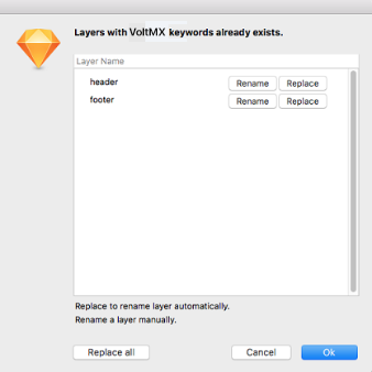

Ensure that your widget name does not conflict with another widget. Ensure that the widget name is also not a Volt MX Iris keyword. If your widget name conflicts with another widget name, Iris displays a message. Using the options on the screen, you can rename or replace your widget name.

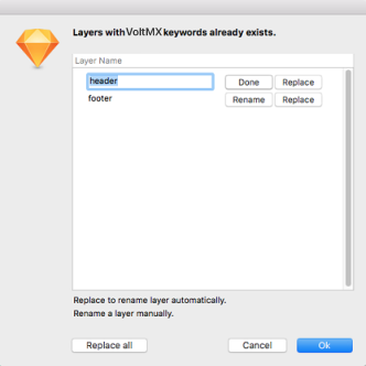

4. Click on Replace all to rename all the layers automatically. Click on Replace to rename a specific layer automatically. or,
Click on Rename and type a different name for a specific layer. Click Done to save the change.
Click Ok to save the changes.
