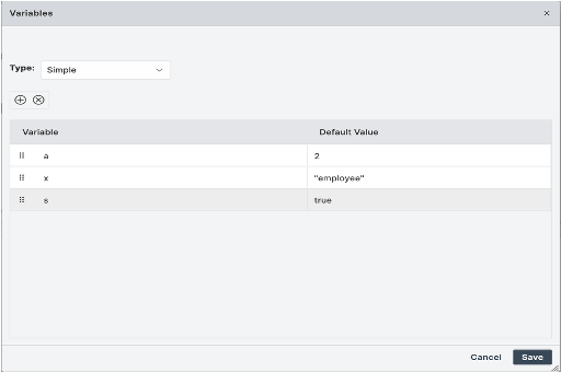

Add a Simple Global Variable
To add a Simple global variable, follow these steps:
- In Volt MX Iris, point to the Edit menu, and then click Global Variables. The Variables dialog box opens.
From the Type list box, select Simple. The Simple variable can either be a String, Number, or a Boolean value. You must provide the String variable details in quotes.
In the Variable column field, type the name of the variable. You must enter a name that is unique to the application and one that is not used for another variable.
- In the Default Value column field, type the initial value that you want the variable to hold when the app is first opened.
- To add a new row for another variable, click the + icon. To delete an added variable, select the row and click the red X icon. If you want to modify the order of the variables, click the upper and lower arrow icons as required.
- Repeat steps 3 through 5 until you have added all the Simple variables that you want.
- Close the Variables dialog box by clicking the gray X icon at the upper-right corner of the dialog box.

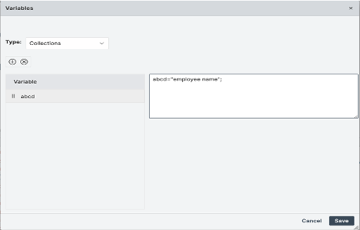

Add a Collection Global Variable
To add a Collection global variable, do the following:
- From the Type list box, select Collections.
- In the Variable column field, type the name of the variable. You must enter a name that is unique to the application and one that is not used for another variable.
- In the right column, enter the assignment statements or function calls that you want in JSON format.
- Repeat steps 3 through 5 until you have added all the Collection variables that you want.
