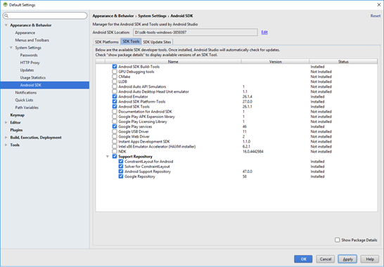

ClosedWhat if I have downloaded the Android SDK package (zipped) separate from Android Studio? How do I use that to create an AVD?
If a developer has downloaded just SDK tools package and wants to set up the full SDK out of it from Android studio from https://developer.android.com/studio/index.html, follow the below steps:
  1. In the downloaded and unzipped SDK folder, create folder platforms in parallel to the tools folder.
  2. Open Android Studio and navigate to File > Project Structure> SDK Location> Android SDK Location.
  3. Set the Android SDK Location path.
  4. Navigate to File > Settings > Appearance & Behavior > System Settings > Android SDK. The Android SDK settings window appears with the SDK Platforms tab open by default.
  5. Click the SDK Tools tab.
  6. Select the following components.
    1. Android SDK Build Tools
    2. Android Emulator
    3. Android SDK Platform Tools
    4. Android SDK Tools
    5. Google Play Services
    6. Support Repository (all the items under it)
  7. Download at least one system Image from SDK Platforms tab and click Apply to download.

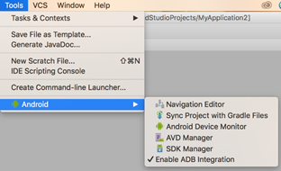

    Once the download is complete, under the Tools Menu in Android Studio, you should be able to see an Android option, which would allow you to create an AVD using AVD Manager.
