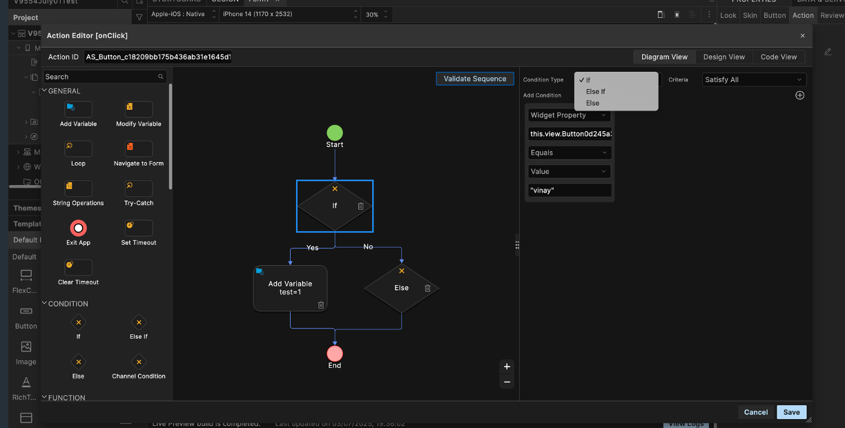

After you have added widgets to a form, you can make the form and form elements functional by adding actions to them. To do so, select the form or widget with the action sequence, click the Action tab on the Properties pane, and then click the Edit button of the action you want. The action sequence opens in the Action Editor window.
The Action Editor window displays the Action ID of the Form and the Name of the action for which you are creating an action sequence. There are three types of views in the Action Editor by using which you can create and view Action Sequences. The three types of views are as follows:
The Action Editor opens in the Diagram view, by default.
Note: You can rename an action by editing the Action ID field.

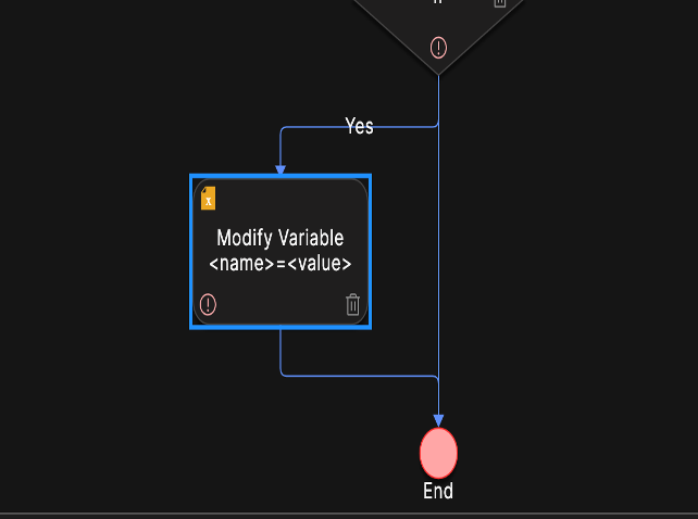

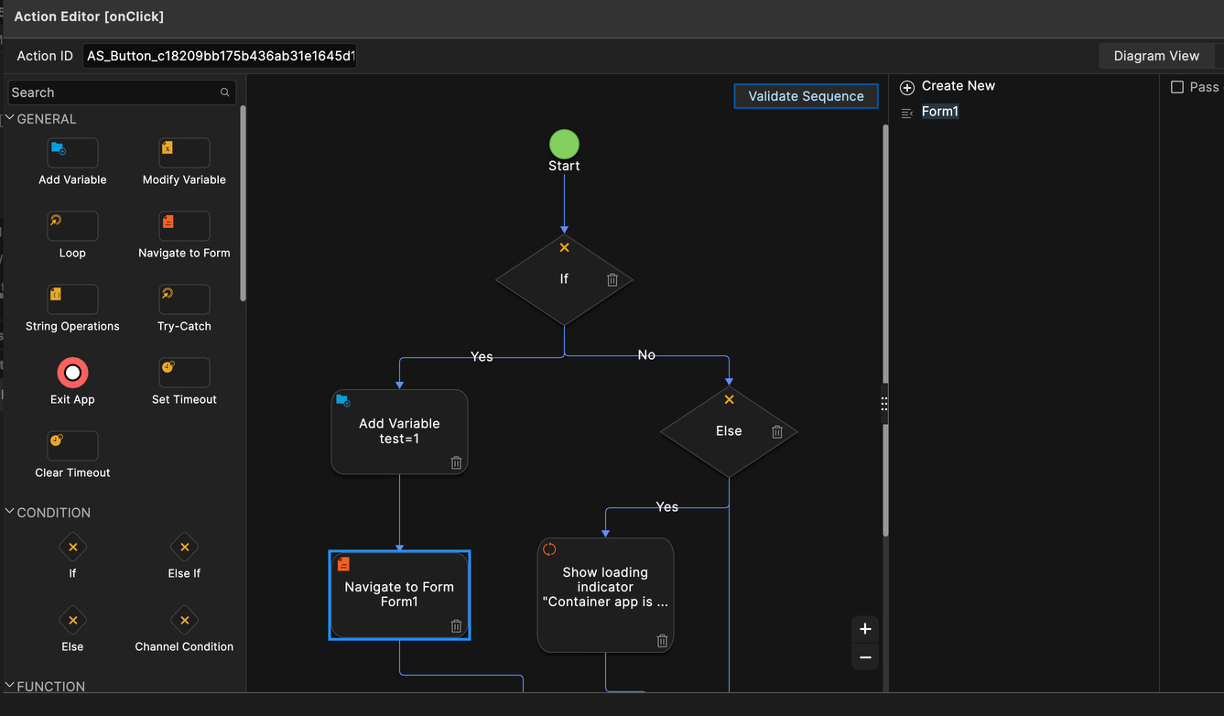

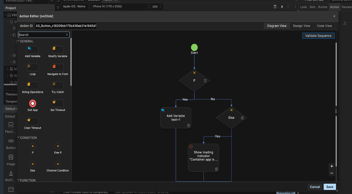

Diagram View
Using the Diagram View, you can quickly create and view the flow of an Action Sequence in a graphical representation. In the Diagram View, the Action Editor window is divided into three parts. The left pane contains a list of all the different actions that you can assign to a widget along with the icons associated with the action. The column in the middle contains a canvas that displays a flow diagram of the action sequence that you create. The right pane displays the properties and parameters that you can configure for the action that you select.
The Action Editor Canvas contains two nodes, by default; Start and End. To add an action in the Diagram View, from the left pane, either click the icon of the action you want to add in the action sequence or drag the icon of the action you want to add and drop it on the canvas. The action is added to the action sequence in between the Start and Stop nodes on the action editor canvas. After an action is added, the properties pane appears. For more information about the various actions available in Volt Iris, refer Categories of Actions.
Note: The Properties Editor always displays the properties of the most recently selected widget. If you switch between the Diagram View and the Design View of an action sequence, regardless of what widget it is associated with, the Properties Editor will continue to display the properties of the most recently selected widget.
In Diagram View, the main flow and the nested flow are displayed in different colors. The main flow is displayed in blue color and the nested flow is displayed in orange color. This feature helps you to visually differentiate between the main flow and the nested flow in graphical view of the added actions, and helps you to easily understand the flow.
In Diagram View, you can click the + icon to zoom in to the graphical representation of the added actions and click the - icon to zoom out.

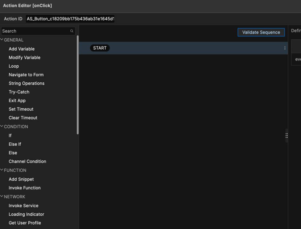

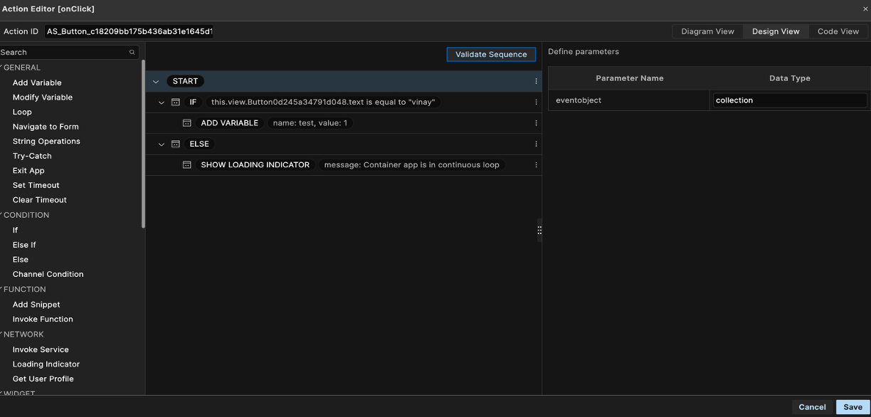

Design View
Using the Design View, you can create and view the flow of an Action Sequence. In the Design View, the Action Editor window is divided into three parts. The left pane contains a list of all the different actions that you can associate with a widget. The column in the middle contains a canvas that displays the action sequence that you create. The right pane displays the properties and parameters that you can configure for the action that you select.
In Design View, the Action Editor Canvas contains a Start action, by default. To add an action in the action sequence, from the left pane, you can either click the action you want to add or drag an action and drop it on the canvas. The selected action is added to the action sequence after the Start action on the Action Editor canvas. After an action is added, the properties pane appears. For more information about the different actions available in Volt Iris, refer Categories of Actions.
Note: The Properties Editor always displays the properties of the most recently selected widget. If you switch between the Diagram View and the Design View of an action sequence, regardless of what widget it is associated with, the Properties Editor will continue to display the properties of the most recently selected widget, and those properties will not be currently editable.

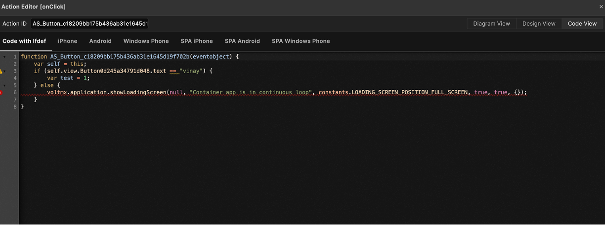

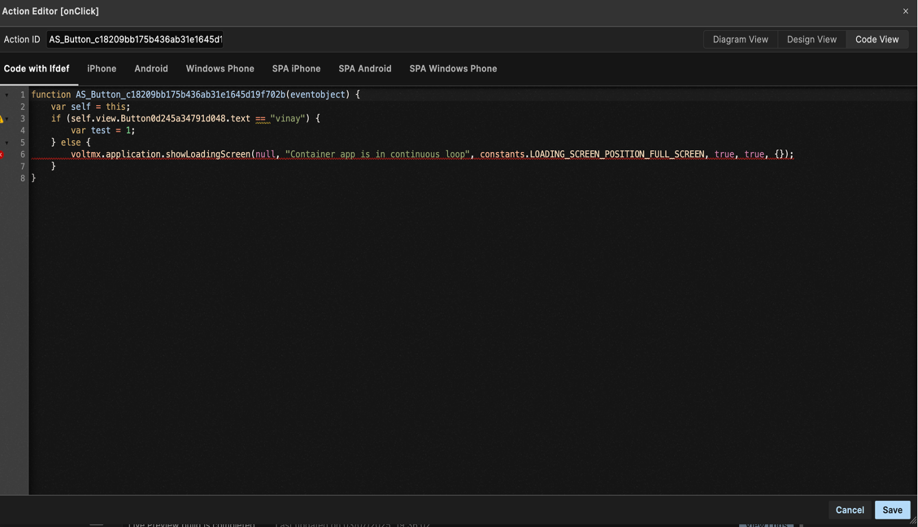

Code View
Once you have configured an action, Volt Iris generates a code snippet that depicts the action sequence that you can reuse in a JavaScript module.
Depending on the channel of the selected form, in the Code View window, you can view the code of the action sequence for the following platforms and channels:
  • Code with Ifdef
  • iPhone
  • Android
  • SPA iPhone
  • SPA Android
  • Desktop Windows
  • Desktop Web

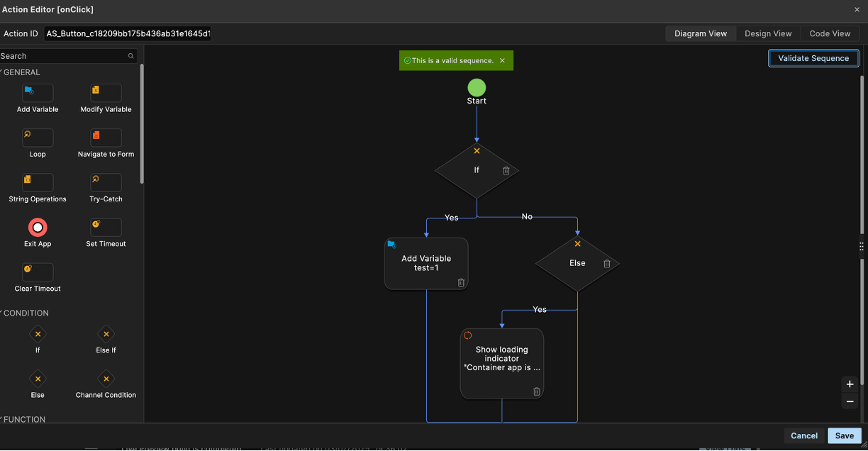

Validate the Code of an Action
After you have configured an action, you can verify to ensure that the code of the action sequence is valid.
To validate the code of an action sequence, do the following:
  1. Open the action sequence that you want to validate. To do so, select the widget with the action sequence, click the Action tab on the Properties pane, and then click the Edit button of the action you want. The action sequence opens on the Iris Canvas.

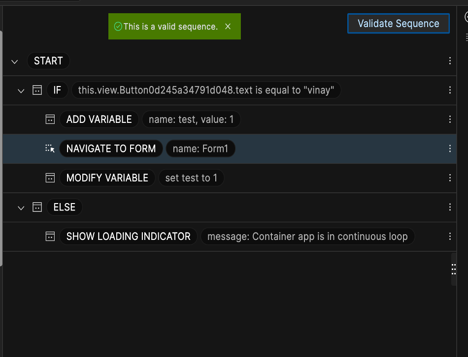

  2. In Design View and Diagram View, Volt Iris points out statements in the action sequence that are in error or are incomplete with a red information icon. Correct these statements.
  3. To validate the action sequence, in the Action Editor window, for Design View/Diagram View click Validate Code.

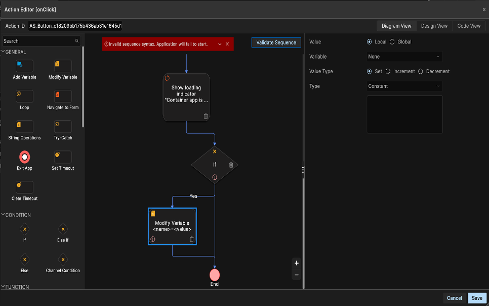

  4. Volt Iris evaluates the action sequence. If the code is not valid. Volt Iris displays an error message in a banner as shown in Fig. 1.0.
    Fig. 1.0: Error banner
    The error banner has an arrow pointed downwards towards the right, as highlighted in Fig. 1.0. Clicking on the arrow provides specific information on the errors. An example is shown in Fig. 1.1 below. Clicking on the specific entry navigates to the erroneous action node in the action sequence.
    Fig. 1.1: Specific details of validation failure.
  5. After you correctly revise the sequence, Volt Iris verifies the validity of the action sequence and displays an appropriate success message.

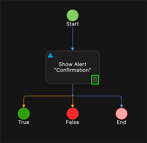

Delete an Action
You can delete unwanted actions from an action sequence.
To delete an action in an action sequence, do one of the following:
  1. Delete from context menu
    a) Open the action sequence that has the action or actions you want to delete.
    b) Right-click the action you want to delete, and click Delete. The action is removed from the action sequence.
  2. Delete using icon on the action node
    b) Select view as “Diagram View”.
    b) Click on the bin icon (shown in Fig. 1.2) to delete the action.
    Fig. 1.2: Delete action in diagram view
