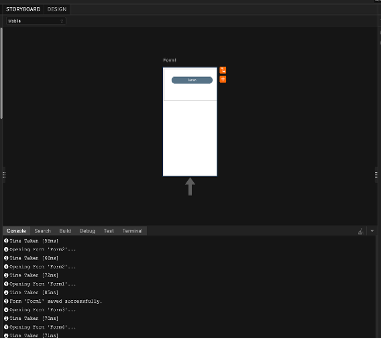

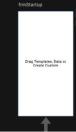

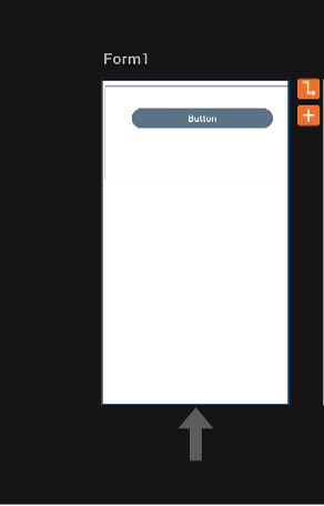

When you create a project in Volt MX Iris, the Storyboard view is displayed by default, containing one form (as shown in the image). The arrow at the bottom of the form (here, Form1) indicates that this form is the startup screen or landing page of the app.
Note: If you are in Storyboard view and want to open a form in Design view, double-click the form.
Note: In Storyboard view, only the Data & Services panel is displayed. If you want to access the Properties panel, click the Design view tab on the project canvas.
If a form is associated to an App Group, the name of the App Group is displayed by default with the form name in Storyboard view. Here, Form1 is associated to AppGroup1.

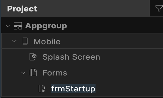

In Storyboard view, click the Form1 text. A box appears in which you can enter the new name for Form1.
Note: In Storyboard view, it is not possible to rename the App Group to which a form is associated; you can only rename a form.
Type the required text in the box as the field name (here, frmStartUp), and press Enter. The form is displayed with the updated name in both Storyboard view and Design view.

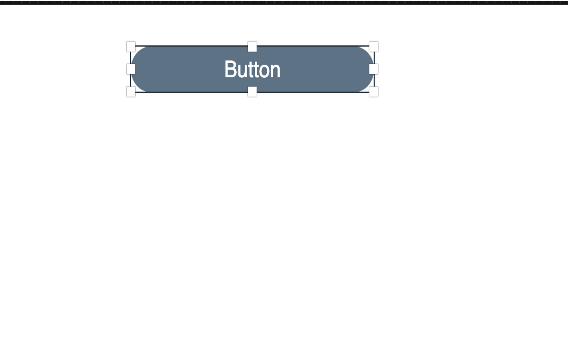

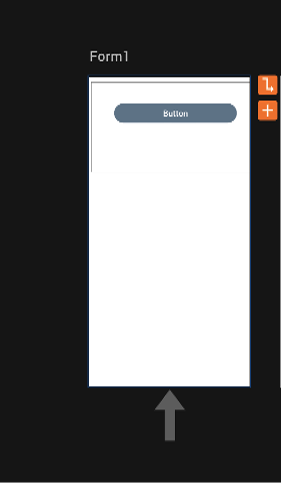

In the following scenario, we have added a SquaredButton widget to the form:
- In Storyboard view, under Default Library, expand Buttons. The list of available Button widgets appears.
Drag and drop the SquaredButton widget to Form1.

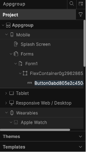

3. If you want to delete or create a copy of the button, right-click the button on the project canvas and click Delete or Duplicate respectively.
4. To view the details of the button that you added to the form, click the Design view tab on the project canvas. You can select the button on the Project Explorer, and then view or modify its details on the Properties panel.

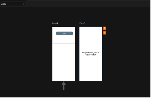

In Storyboard view, click Form1. Two icons appear beside the form.
2. Click the Add icon
. A new form, named Form2 by default, appears with a navigation link connecting to Form1.

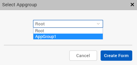

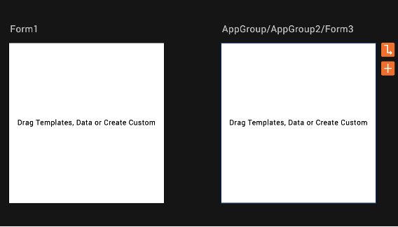

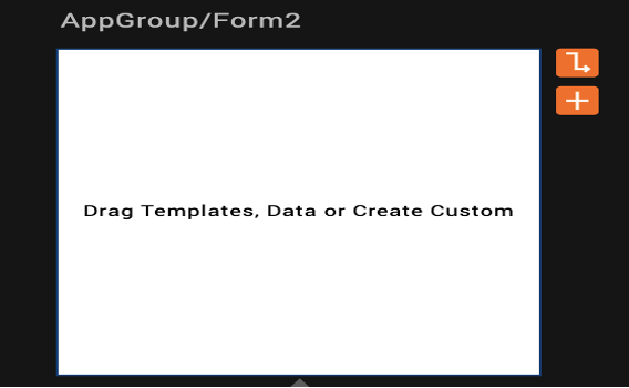

If an App Group exists under the same channel, when you click the Add icon
, the Select Appgroup dialog box appears.

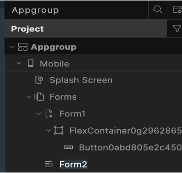

If you choose Root and then click Create Form, a new form named Form2 appears with a navigation link connecting to Form1. In the Project Explorer, Form2 is displayed under Mobile > Forms.
If you choose AppGroup1 and then click Create Form, a new form AppGroup1/Form2 appears with a navigation link connecting to Form1. In the Project Explorer, Form2 is displayed under Mobile > Forms > AppGroup1.
Note: This type of navigation link is called as a soft link. It is just a visual representation of the navigation action between two forms; there is no actual navigation action involved between the forms through code.

To view the details of Form2, click the Design view tab on the project canvas. You can select Form2 on the Project Explorer, and then view or modify its details on the Properties panel.

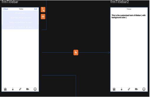

In this section, we will discuss how to create a navigation link between two forms in Storyboard view. There are two types of navigation links: hard link and soft link.
A hard link is an actual navigation action between two forms through code. You can create this type of link only in Design view.
A soft link is just a visual representation of a navigation action between two forms in the storyboard of your app. There is no actual navigation action involved through code between the forms. You can create this type of link only in Storyboard view.

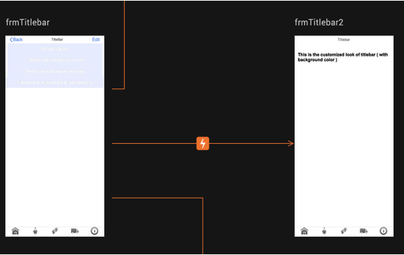

Go to Storyboard View. The hard navigation link between Form1 and Form2 is displayed.
Note: If a soft navigation link already exists between two forms and later you define a hard navigation link between those two forms, the hard navigation link replaces the soft navigation one.
Note: You cannot delete a hard navigation link; only soft navigation links can be deleted.
If you want to view or modify the details of the navigation action between the two forms in the Action Editor, click the Open Action icon
. The Action Editor opens with details of the navigation action.
Note: If there are multiple navigation actions between two forms, when you click the Open Action icon
, all the created actions are displayed. You can click the required navigation action to view or modify the details in the Action Editor.

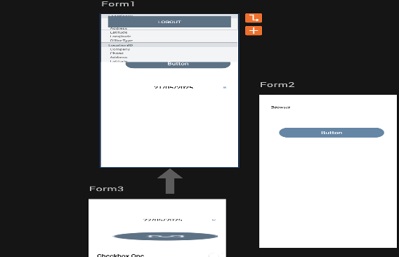

To add a soft link between two forms in Storyboard view, follow these steps:
- In Storyboard view, click Form2. Two icons appear beside the form.
- Click the Add icon
. A new form, named Form3 by default, appears with a navigation link connecting to Form2. -

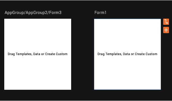

To add a visual navigation link from Form1 to Form3, click Form1 and then click the Draw Navigation Link icon
.Note: You can only create soft navigation links between forms that do not have any hard navigation links between them.
Drag the navigation link from Form1 to Form3. The visual representation of a navigation action between two forms is created.
If you want to delete the navigation link between Form1 and Form3, click the navigation link and press the Delete key from your keyboard.
