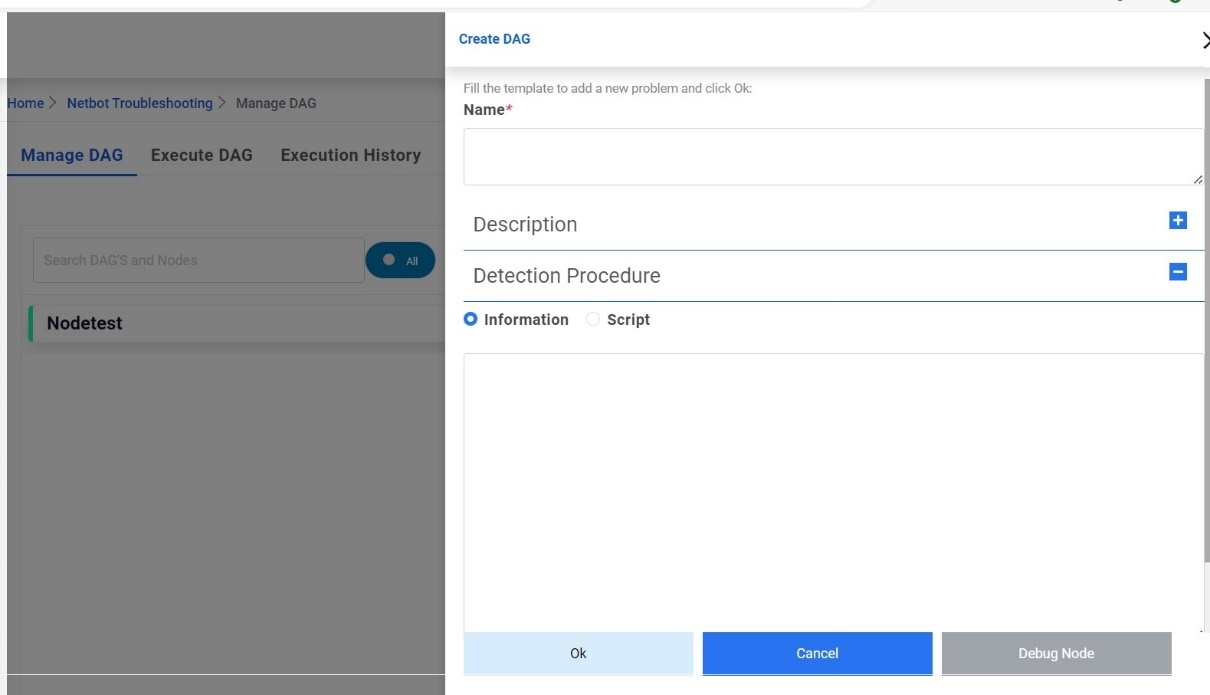

  1. Information Node: Information node contains information and does not execute. Go to Netbot TroubleshootingàManage DAG. Click on Add. Select the Detection Procedure as ‘information’ and fill in all the details. Click Ok.
    Figure 1. DAG - Create Information Node

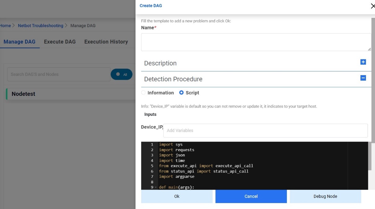

  2. Script Node: Script node contains python script and related parameters that execute by API. Go to Netbot TroubleshootingàManage DAG. Click on Add. Select the Detection Procedure as ‘Script’ and fill in all the details. By default, a script is populated on the screen. If the command to be executed needs to be changed, then in the already defined script, search for “command_to_execute” and update its value to the command that you want to execute.

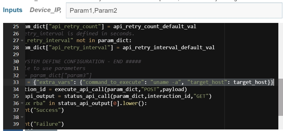

    Eg: payload = {"extra_vars": {"command_to_execute": "<Command to execute>", "target_host": target_host}}
    If the command needs to have some parameters, then define those parameters (comma separated) under ‘Inputs’ field along with Device_IP.
    Figure 2. DAG - Define Parameters
    Figure 3. DAG - Create Script Node
