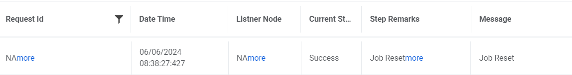

Figure 1. Status of job is stuck at INITIATE/FAILED

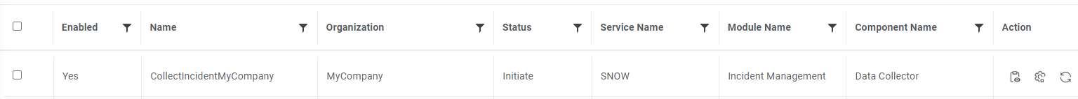

Figure 2. Status of job is stuck at INITIATE/FAILED

  1. If the status of the job CollectIncidents remains Initiate for a long time, it implies that Listener is not picking up the job.
  2. Also, if user resets the job, and status of the job remains ‘Failed’ for a long time and the log of the job reads ‘Job Reset’ then also it implies that Listener is not picking up the job.
