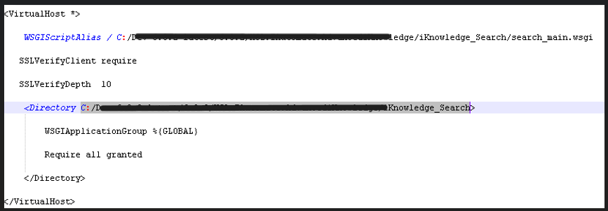

  1. Check for existence of the file iKnowledgeSearch.conf at location <Apache_Root_Folder_Path>/conf.
  2. At the bottom of iKnowledgeSearch.conf file you will find the path to the python files as highlighted in the below figure.
    Figure 1. HCL.iAutomate.iKnowledgeSearch (cont.)

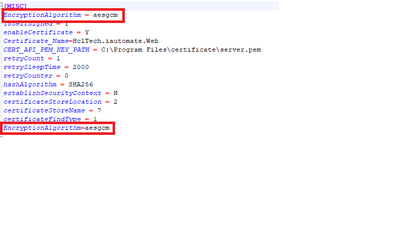

  3. Open the file IKNOWLEDGE_SEARCH.cfg from the location <highlighted_path_in_fig_128> and search for any duplicate keys present in the file. You can refer below keys for reference:
    Figure 2. HCL.iAutomate.iKnowledgeSearch (cont.)
  4. Remove the last entry that is duplicate for each key. In the above case delete the second entry of EncryptionAlgorithm = aesgcm. Similarly check for any other duplicate keys and remove the last entry and save the file.
