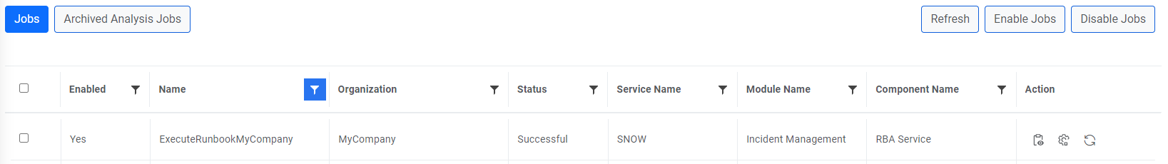

Resolution Steps:
  1. Go to Manage Jobs and check if the RBA Job is enabled and successful. If not, enable it.
    Figure 1. RBA: Error message “Not able to reach the component”

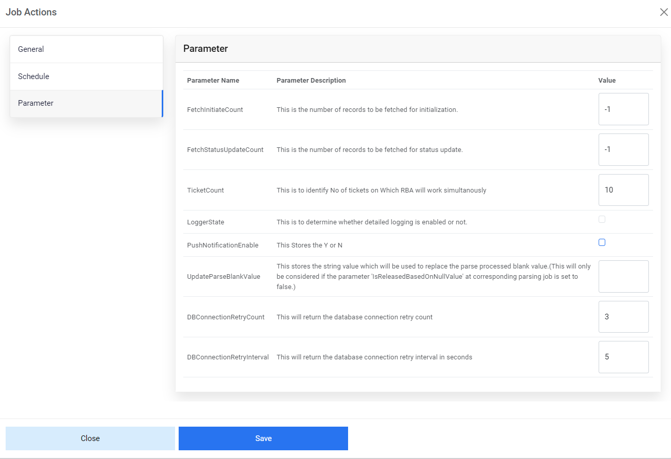

  2. For example:
    • Organization Name - MyCompany
    • Job Name - ExecuteRunbookDemoOrg
    • Component Name- RBA Service
    • Parameter - PushNotificationEnable –>Y - ANSIBLE TOWER/CLI
