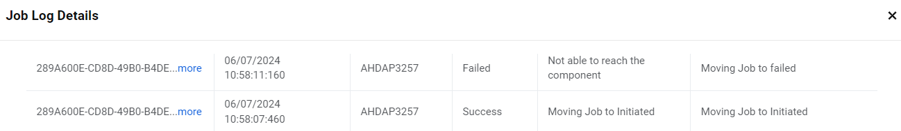

Failed to Recommend Jobs
Table 1. iRecommend: Scenario 8
Issue description Failed to recommend jobs after setting configuration
Module impacted IRecommend
Probable root cause
Figure 1. Failed to Recommend Jobs
Resolution steps:
  1. Check whether the IRecommend service is running in the app server.
  2. Start the IRecommend service if not started.
  3. Go to iAutomate configuration  Check the load balancer URL and check whether the connection is successful.
