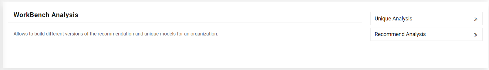

Workbench
WorkBench analysis allows users to build different versions of the recommendation and unique models for an organization. WorkBench provides a UI to capture SME feedback for results received for these models. If the SME considers a particular version of the model to be about 80% to 90% accurate, then the user can deploy the same model in a production environment. Users can use the deployed model for future clustering of tickets and recommendations.
To run and build different versions of the same model (for ticket clustering and Runbook Recommendation), the SME defines the configurations, also called hyperparameters for each version. SMEs can use these models to test the current unique and recommendation models anytime and update them as required.
It is recommended to perform the workbench analysis before deploying a unique and recommendation model in the production environment.
The Workbench option is visible only to Super Admin.
  1. To manage workbench analysis, on the main menu bar, click Advance Configuration🡪 WorkBench. The drop-down lists the following options:
    1. Unique Analysis
    2. Recommendation Analysis
    Figure 1. Workbench

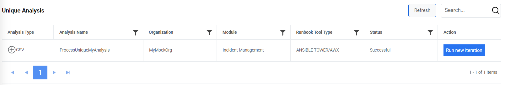

Add New Iteration
If the existing configuration (or hyperparameters template) of unique analysis does not provide the expected results, you can add multiple configurations (or hyperparameters template) to get better results.
To add a new iteration, perform the following steps.

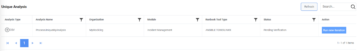

  1. On the Unique Analysis page, click Run New Iteration.
    Figure 3. Workbench Unique Analysis
  2. On the Iteration page, select Hyperparameter Template from the drop-down menu, and then click Run.
    Figure 4. Workbench Unique Analysis
    To create a new hyperparameters template, see Hyperparameter Configuration .

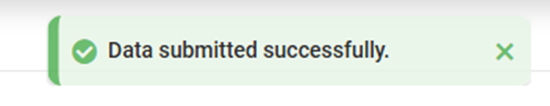

  3. The confirmation dialog box appears.
    Figure 5. Workbench Unique Analysis

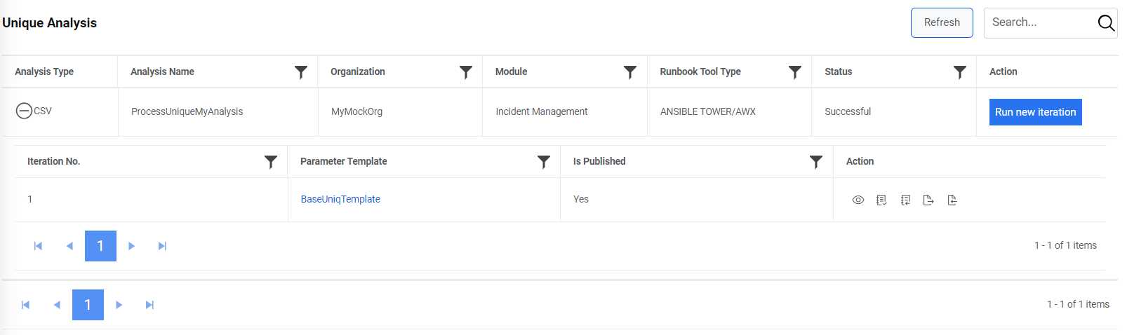

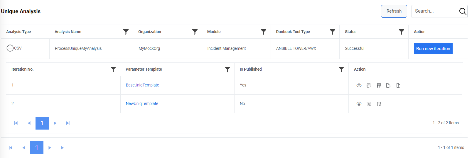

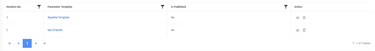

  4. This adds the iteration and appears at the bottom of the list in a grid below.
    Figure 6. Workbench Unique Analysis

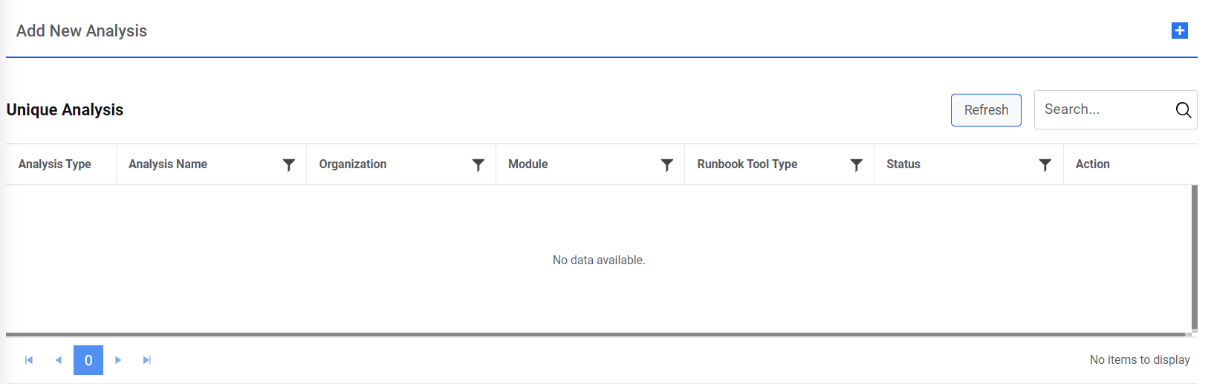

Add New Unique Analysis Type

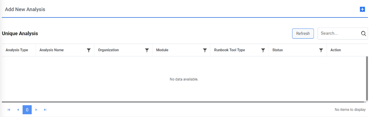

User can add a new workbench unique analysis type for an organization by performing the following steps.
  1. On the Unique Analysis screen, click on icon .
    Figure 7. Add New Unique Analysis

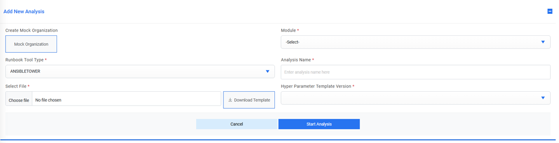

  2. The Upload WorkBench Data page appears. Users can define general attributes for the new analysis on this page. Attributes must be set for fields marked with an asterisk (*) to appropriate values for the environment before creating an analysis.
    Figure 8. Add New Unique Analysis (Cont.)

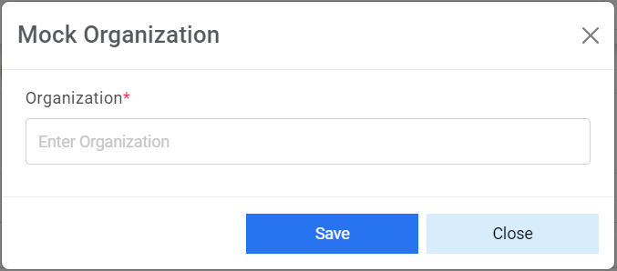

    User can create a dummy organization using Add Mock Organization.
  3. If the user doesn’t want to run the analysis for any organization, then user can also create a mock organization using the following steps:
    1. Click on Mock Organization button, and it will prompt you to type the Mock Organization name.
      Figure 9. Add New Unique Analysis (Cont.)
    2. Click Save. This adds the new mock organization and appears in the Organization drop-down list.
  4. Select a module from the list of modules available in the Modules field.
  5. Select Runbook Tool Type from the list of available tool types in dropdown.
  6. In the Analysis Name field, type the unique name for the analysis to be created.
  7. Click Download Template to download the CSV template to upload analysis details.
  8. Fill the details in the downloaded template and click Choose File to upload the updated CSV template.
  9. Select the hyperparameter template version from the templates available in the Hyperparameter Template Version field.
    It lists all the Hyperparameter Templates added in Add New Template .
  10. To start a unique analysis, click Start Analysis.

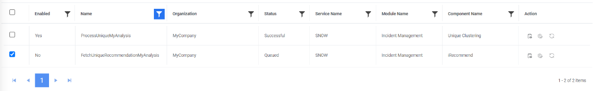

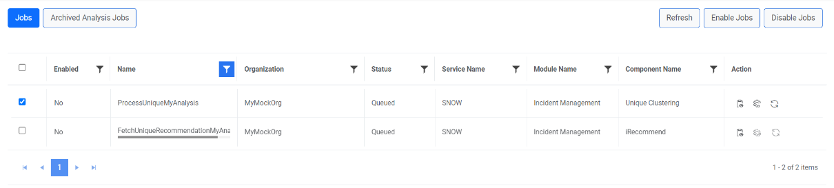

    On clicking Start Analysis, one job is created for Unique Analysis and another for Recommendation Analysis. Newly added analyses are listed on the Manage Jobs page.
  11. To enable a job to view analysis, go to Manage Jobs.
    Figure 10. Add New Unique Analysis (Cont.)
  12. Select the newly added job for unique analysis with the status as Queued and then click Enable Jobs. A confirmation dialog box appears.
    Figure 11. Add New Unique Analysis (Cont.)

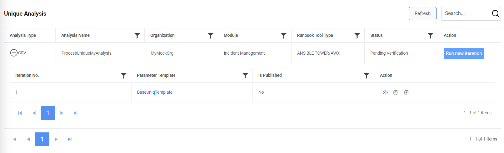

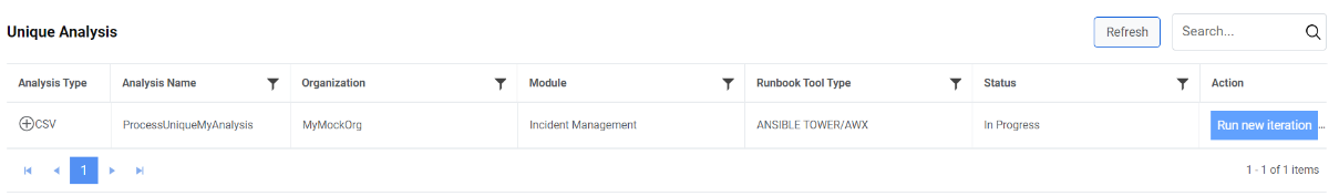

  13. This adds the analysis and lists it in on the Unique Analysis page with an In-Progress status.
    Figure 12. Add New Unique Analysis (Cont.)
  14. After the unique analysis is completed, the status changes to Pending Verification. The SMEs can now validate the results.
    Figure 13. Add New Unique Analysis (Cont.)

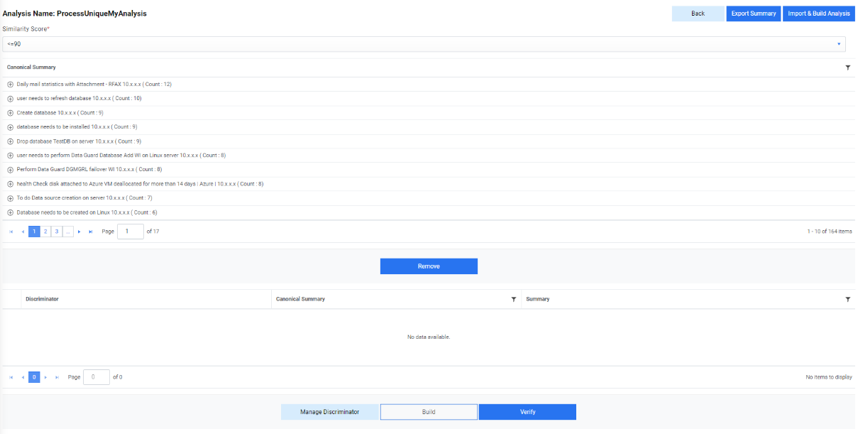

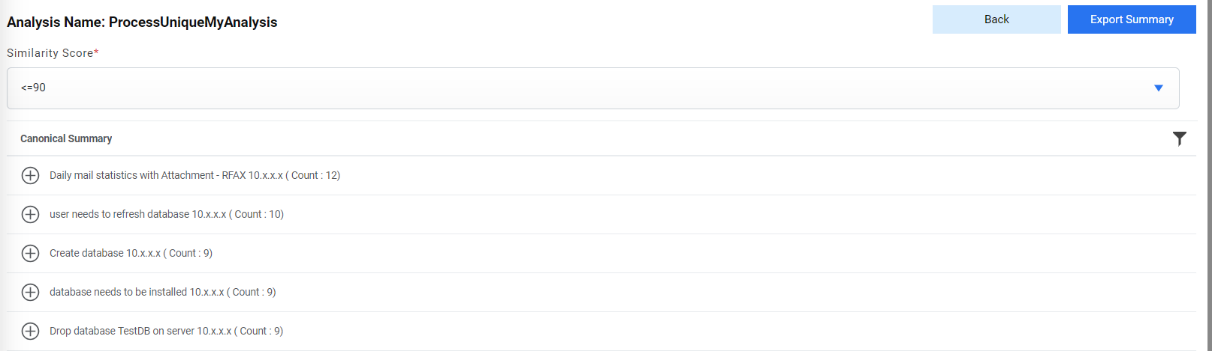

  2. The WorkbenchVerifyTicket page appears where users can edit the required Similarity Score to view the canonical summary of the analysis.
    Figure 16. View Unique Analysis (Cont.)
    Click Export Summary to export the canonical summary of the analysis to your folder or click Back to go back to the previous screen.

User can open an existing analysis, review the available information, and change the analysis details by performing the following steps:

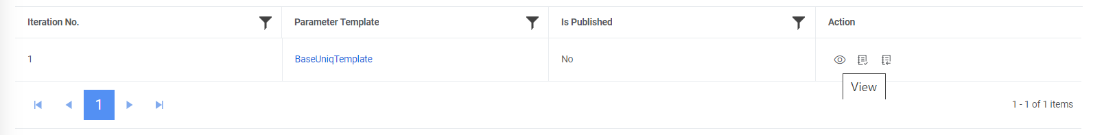

  1. On the Unique Analysis page, click next to the analysis you want to verify.
    Figure 17. Verify Unique Analysis
  2. The Canonical Summary page appears where users can edit the required Similarity Score to see the canonical summary of the analysis.
    Figure 18. Edit Unique Analysis (Cont.)

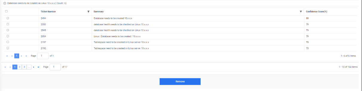

  3. Expand the selected Canonical Summary and all the available tickets under the summary appear in a tabular view.
    Figure 19. Edit Unique Analysis (Cont.)

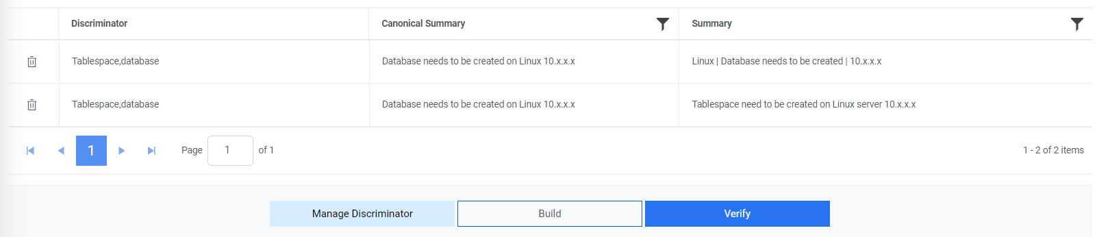

  4. To delete tickets from the selected analysis, select tickets under the canonical summary and click Remove.

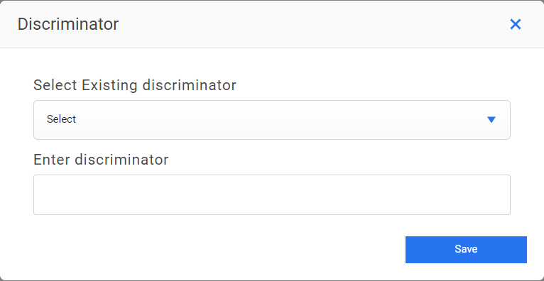

  5. The Discriminator page appears that allows users to select the Existing Discriminator.
  6. Type a new (at least two comma-separated values) discriminator to verify the uniqueness of the selected tickets and click Save.
    Figure 20. Edit Unique Analysis (Cont.)
  7. The new discriminator is added and listed in the grid below.
    Figure 21. Edit Unique Analysis (Cont.)

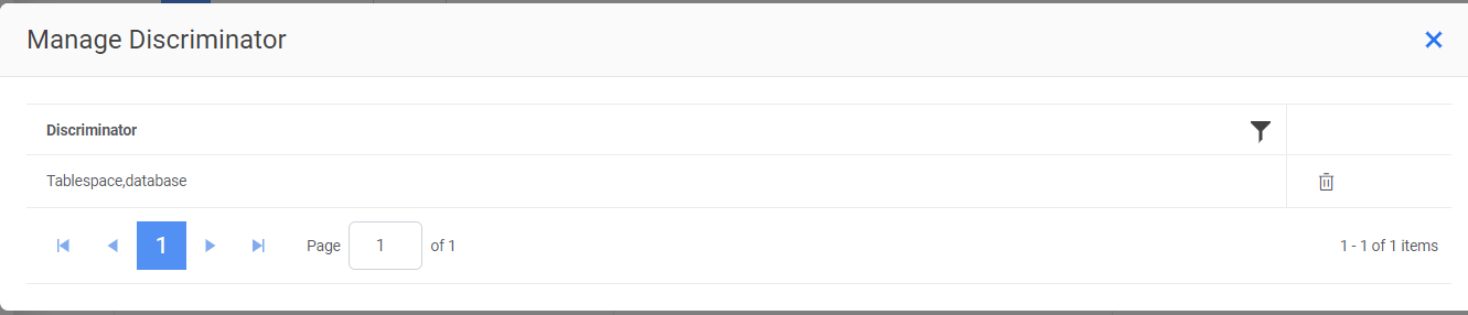

  8. To manage the added discriminator for analysis, select Manage Discriminator.
  9. The Manage Discriminator page appears and allows user to delete the discriminator by clicking .
    Figure 22. Edit Unique Analysis (Cont.)

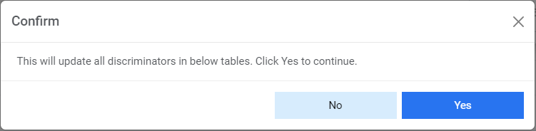

  10. Click Yes to confirm the updates for all discriminators.
    Figure 23. Edit Unique Analysis (Cont.)

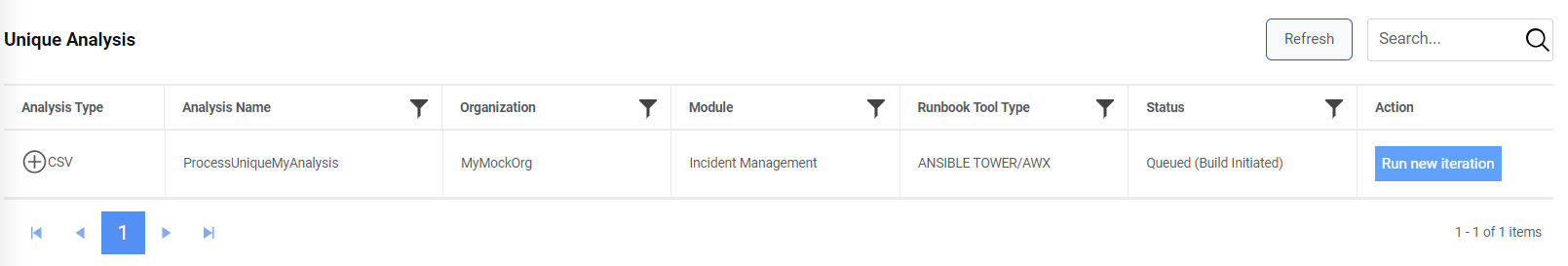

  11. After the discriminators are configured, click Build to reinitiate the unique analysis of selected tickets cluster, based on the newly added discriminator.
  12. This will redirect user to the Unique Analysis page where the analysis status changes to Queued (Build Initiated). On successful completion of unique analysis, the status automatically changes to Pending Verification.
    Figure 24. Edit Unique Analysis (Cont.)

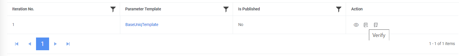

  13. To verify the pending verification of the analysis, click on next to the analysis you want to verify. This will redirect you to Figure 477- Edit Unique Analysis (Cont.)
  14. Click Verify to approve analysis. A confirmation dialog box appears.
    Figure 25. Edit Unique Analysis (Cont.)
  15. The status of the unique analysis changes to Successful.
    Figure 26. Edit Unique Analysis (Cont.)

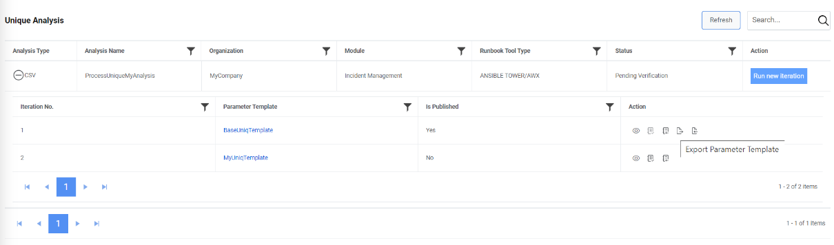

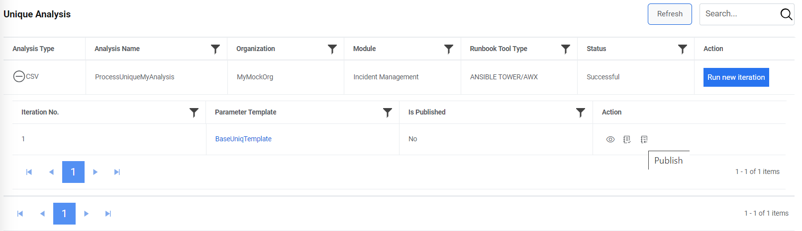

Publish Unique Analysis
After the user has verified the configuration of the existing hyperparameter template for an analysis, user can publish the most optimized hyperparameter template by performing the following steps.

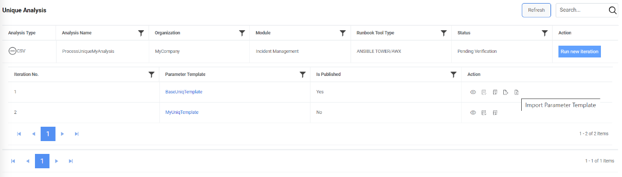

  1. On the Unique Analysis screen, click next to the analysis user wants to publish.
    Figure 27. Publish Unique Analysis
    Users can only publish the successful iterations.
  2. A confirmation dialog box appears.
    Figure 28. Publish Unique Analysis (Cont.)
  3. Successful publishing of the hyperparameter template enables in the Action column.
  4. Click to export the parameter template. This can further be used to create a new template for iUnique using the Hyperparameter Configuration screen.
    Figure 29. Export Parameter Template

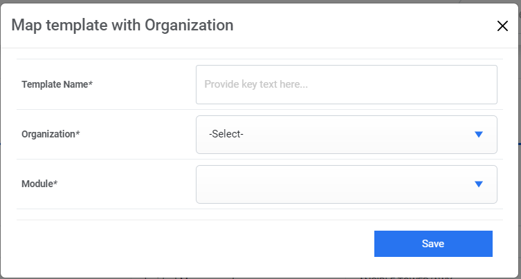

Users can also create a new parameter template. Click in the Action column which takes the user to the Map template with Organization.
Figure 30. Import Parameter Template
Figure 31. Map Template with Organization
Users can refresh the data on the screen by clicking Refresh.

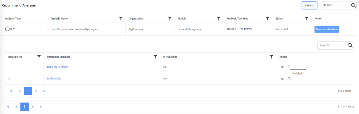

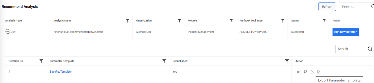

WorkBench Recommend Analysis
The Workbench Recommendation Analysis optimizes the hyperparameters (or configuration) of the iRecommend module. It identifies hyperparameters values for iRecommend by running multiple iterations of iRecommend and selects the most optimal hyperparameter values. Later, these hyperparameter values can be used in production environment. These hyperparameter values can be defined in Hyperparameter Configuration .
To manage workbench recommendation analysis, perform the following steps:
  1. On the main menu bar, click Advance Configuration->WorkBench.
  2. Click Recommend Analysis. The Recommend Analysis screen appears.
    Figure 32. Workbench Recommendation Analysis
  3. It lists the available recommendation analysis types in a tabular view and enables user to add a new recommendation analysis or view, edit, or publish the existing recommendation analysis.
If the published unique analysis is available for an organization, only then user can run the new iteration on recommendation analysis for the same organization.
Add New Iteration
This section describes how to add a new workbench recommendation analysis for an organization.

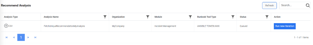

  1. Before adding a new iteration, ensure that the unique analysis for the organization for which you are adding the new iteration is published. Then enable the recommendation job from the Manage Jobs page.
    Figure 33. Add New Iteration
  2. After the job is enabled, click Run new iteration to run a new iteration of recommendation analysis for the same customer.
    Figure 34. Add New Iteration (Cont.)

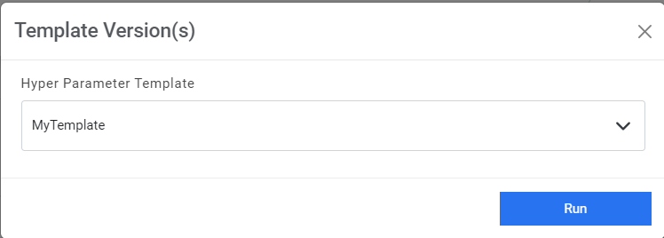

If user does not get the expected results from the configured hyperparameter template of the recommendation analysis, then user can add multiple iterations of recommendation analysis corresponding to hyperparameter templates to modify the results.
To add a new iteration, perform the following steps:
  1. Go to main menu bar, click on Advance ConfigurationWorkbench. Click on the Recommend Analysis page, click Run New Iteration for the organization under analysis.
    Figure 35. Add New Iteration (Cont.)

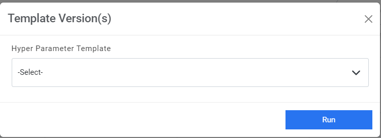

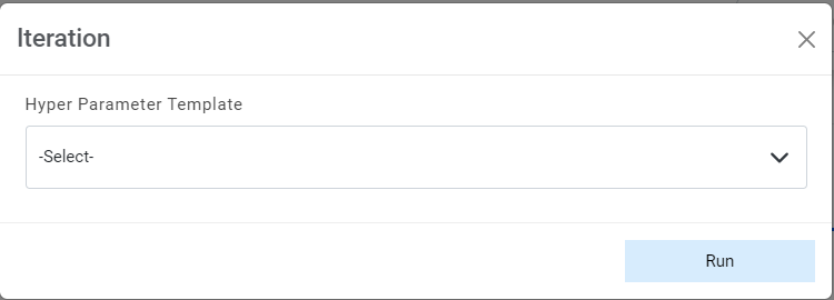

  2. The Template Versions page appears.
    Figure 36. Add New Iteration (Cont.)
  3. Select a template from the Hyperparameter Template drop-down list.
    Figure 37. Add New Iteration (Cont.)
  4. Click Run.
    Figure 38. Add New Iteration (Cont.)
  5. A confirmation dialog box appears.
    Figure 39. Add New Iteration (Cont.)
  6. The new iteration is added and appears at the bottom of the list in the grid below.
    Figure 40. Add New Iteration (Cont.)

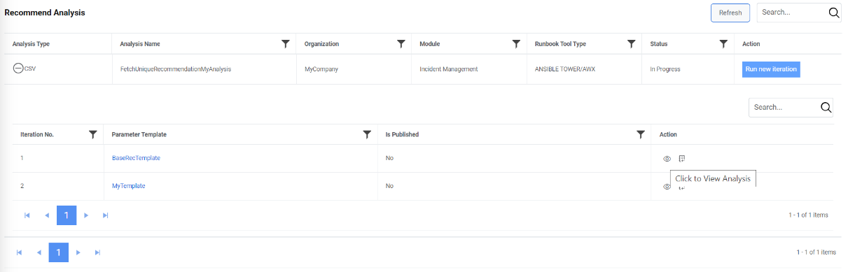

View Recommendation Analysis
Users can view information about an analysis that has already been configured.
To view recommendation analysis, perform the following steps:

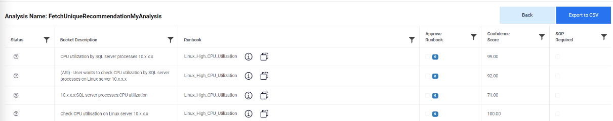

  1. On the Recommend Analysis screen, click next to the analysis you want to view.
    Figure 41. View Recommendation Analysis
For detailed information, see View Analysis.
Figure 42. View Recommendation Analysis
Click Export to export the summary of the analysis to your folder or click Back to go back to the previous screen.

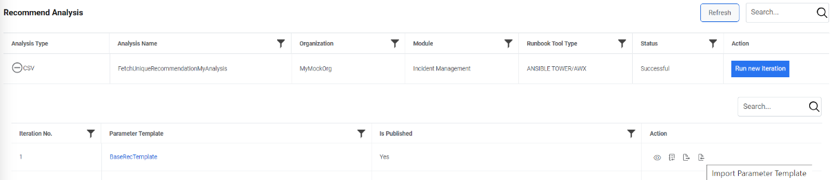

Publish Recommendation Analysis
After verifying the configuration of the existing hyperparameter template in an analysis, user can publish the most optimized hyperparameter template by performing the following steps.
  1. On the Recommend Analysis screen, click next to the analysis user wants to publish.
    Figure 43. Publish Recommendation Analysis
    Users can only publish successful iterations.
    Figure 44. Publish Recommendation Analysis
  4. Click to export the parameter template. This can further be used to create a new template for iRecommend using the Add Hyperparameters Details screen.
    Figure 45. Export Parameter Template

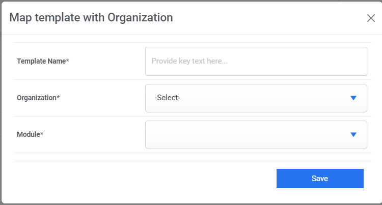

  5. Users can also create a new parameter template. Click in the Action column which takes the user to the Map template with Organization.
    Figure 46. Import Parameter Template
    Figure 47. Map template with Organization
    Click Refresh to refresh the data being viewed.
