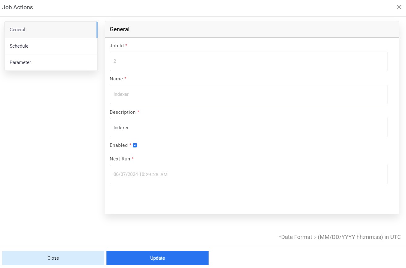

  3. Click General to configure the general details of a parameter by filling in the following attributes.
    1. Type the unique parameter name within the job in the Name field and then type the parameter description in the Description field.
    2. If the user wants to enable the added parameter for execution, select Enabled.
      Figure 6. Manage Job Parameters (Cont.)

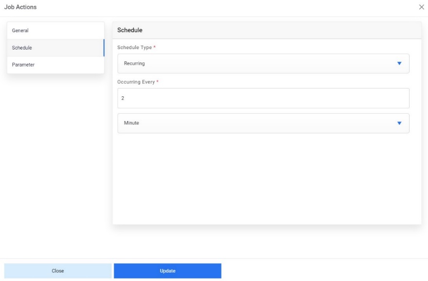

  4. Click Schedule to provide parameter details to schedule a job. The user can schedule jobs to automatically run at a particular date or time and/or on a recurring basis.
    • Schedule Type: This allows the user (Organization Admin) to schedule job updates. The drop-down menu lists the following options:
    • Select One Time, if you want to schedule the job update only once, then select the Date and Time to schedule and then click Save to update the schedule.
      Figure 7. Manage Job Parameters (Cont.)
    • Select Recurring, to schedule a recurring job update, then type the numerical value for the schedule next to the Occurrence Every field, and then click the drop-down list to select the duration in seconds, minutes, hours, monthly, or daily.
      Figure 8. Manage Job Parameters (Cont.)

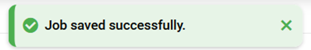

  6. Click Save.
    User can click Save after updating General, Schedule, or Parameter tabs and save the updates.
  7. A confirmation dialog box appears.
    Figure 11. Manage Job Parameters (Cont.)

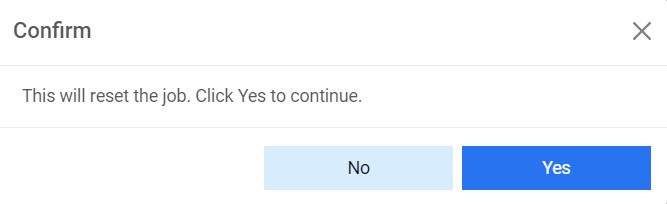

To reset a job, perform the following steps:
  1. On the Manage Jobs page, click in the Action column next to the job user wants to reset.
    Figure 12. Reset Jobs
  2. Click Yes to confirm.
    Figure 13. Reset Jobs (Cont.)
    The administrator cannot reset successful jobs and jobs with schedule type selected as One Type.
